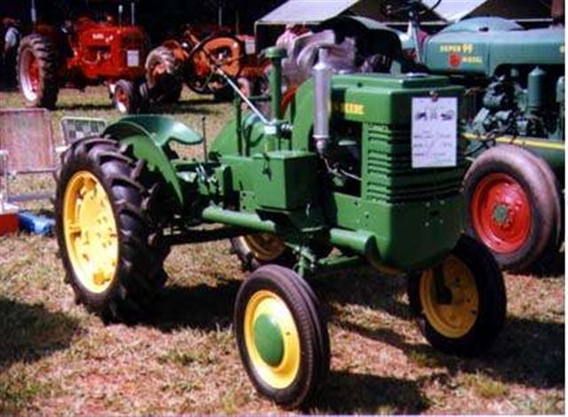

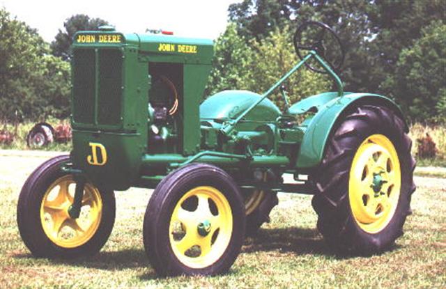

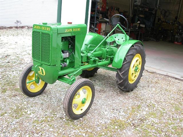

ok here are some teaser pics...
Starting point...
and what the end result should look like...

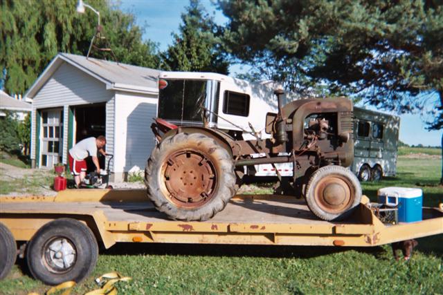

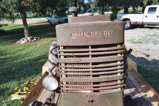

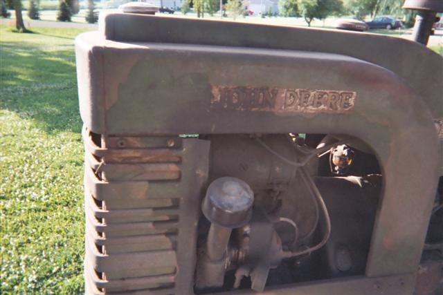

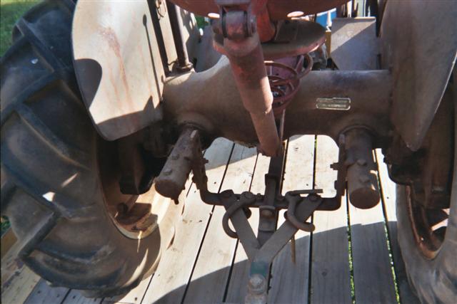

well i guess i will get everyone caught up to where i am at today (couple of weeks worth of work)
here is what the tractor looked like when i got it home
up close of the engine
up close pics of rest of tractor

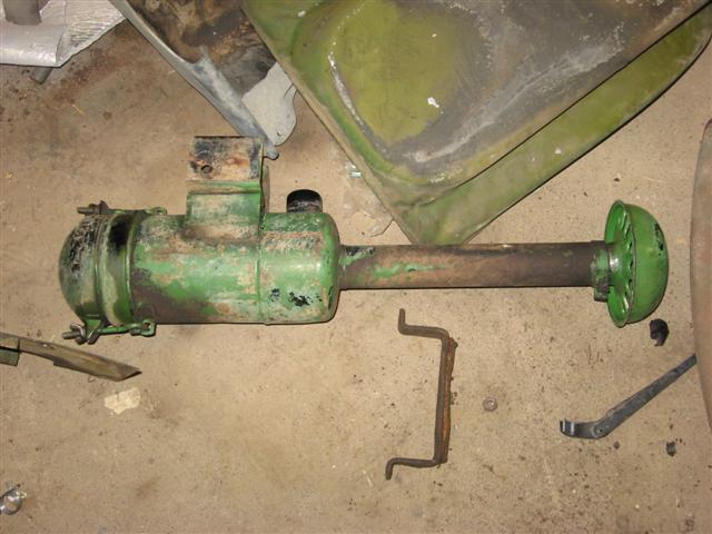

at this point i am cleaning it up (lots of engine degreaser). i still wasnt sure if i was going to do a total restoration (paint) because i wasnt sure i was going to be able to get origional decals. well after some phone calls and internet searching i was able to locate a person that bought the origional John Deere prints and machines and is authorized my JD to reproduce them (10% goes to JD). so since i am going for a 110% ORIGIONAL look i decided to get them ordered and do a complete restoration. more pics
here is what it looks like after a GOOD power washing
hey looky there, there is some green paint under all that dirt

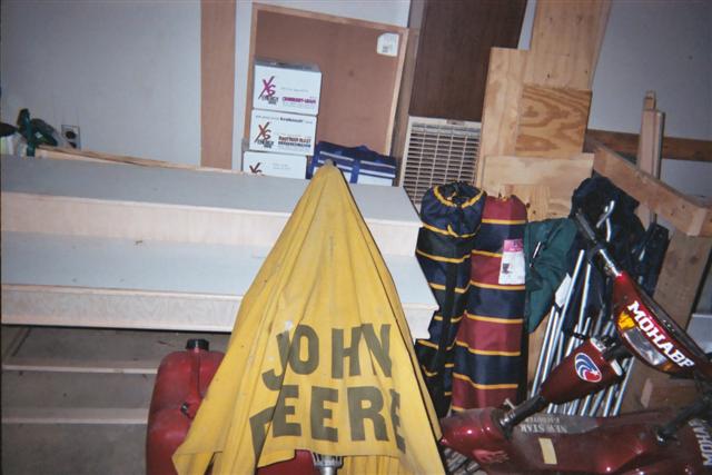

and here is the origional umbrella, in perfect shape

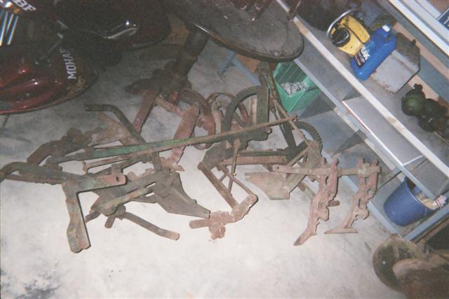

here are the cultivatiors, also going to get restored
here is the 14" single bottom plow, agian also going to get restored

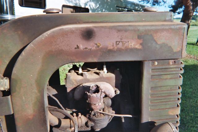

Here is the front of the engine with all the shields off (keep note of how the front plate on the engine looks)

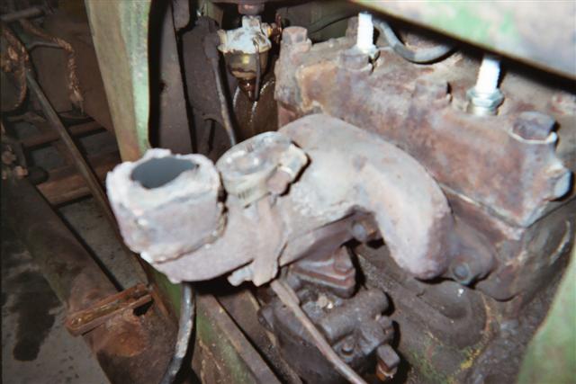

here is a pic of the engine with the exhaust/intake maniflod off. if you look closely you can see that i broke the stud off on the right side but it wont be to hard to get out as i still have about 1.5" of stud still sticking out (you will see in a next pic)

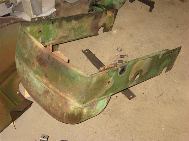

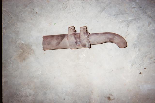

suring my research i found out some interesting things about some of the parts. first the steering box (in pic below) is from a ford model A and the clutch is also from a ford model A (modified to fit)

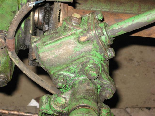

here is another pic of the dismantleing... if you look closely you can see the driveshaft comming out of the engine... no universal joints.... JD was amazing at making tractors affordable, and making them easy to work on in the field, while still making them reliable . JD's "universal" consisted of a peice of reinforced rubber 1/2" thick. ill show a close up pic later on.
notice the front of the engine now... much cleaner (engine degreaser and a toothbrush). still ALOT of cleaning required, then sanding and cleaning and sanding, and so on (i hope im not to anal

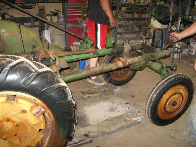

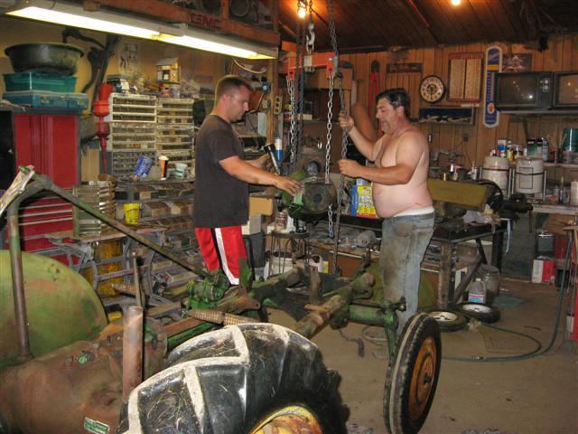

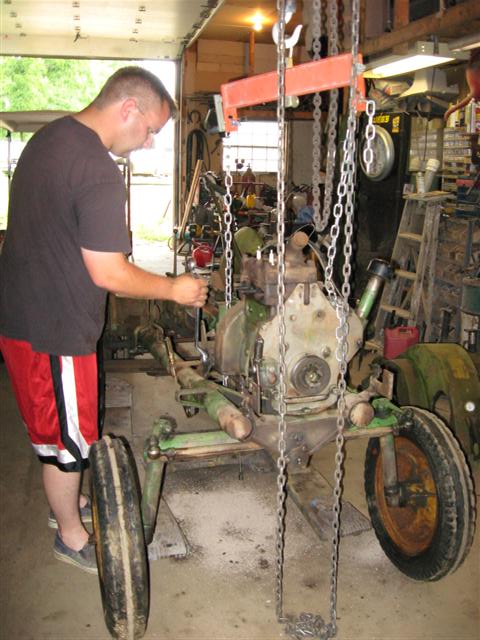

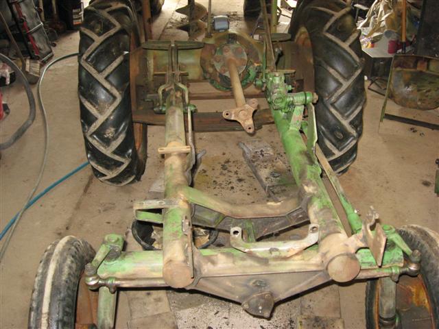

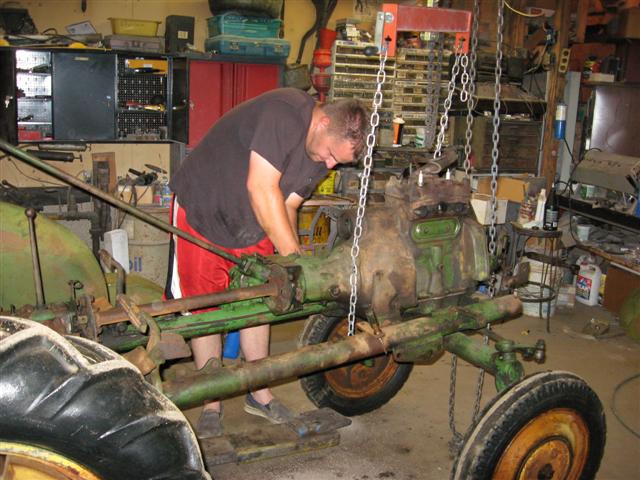

here is the engine comming off the frame. i had my future father-in-law help me with this as i DID NOT want to damage the oil pan (not replaceable).
here is the frame of the tractor without the engine, ahhhh more dirt to clean...

What do we got here?
One intake port and two exhaust ports ?

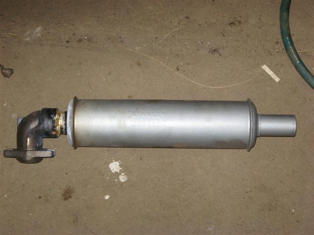

you are correct. ill show a more detailed pic of the new manifold with the carb on it in a little while

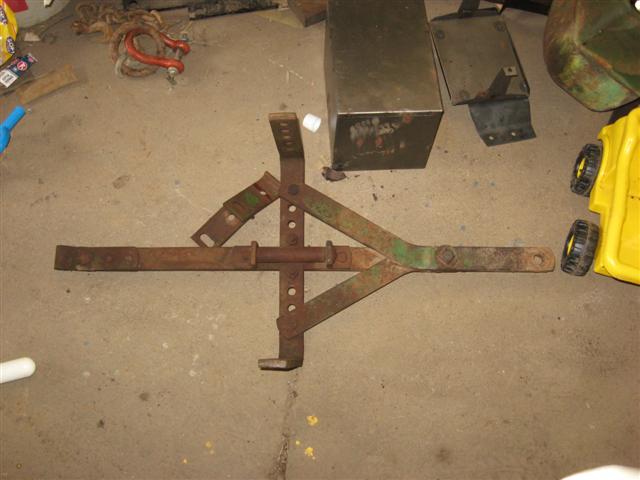

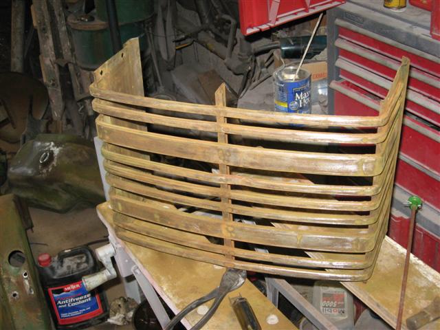

here are some pics of the radiator. i have to have it redone due to leaking and extreme buildup inside due to sitting for years. there is only one place known to have the ability to reporduce these. near dayton OH. ill be shipping this out today. wont know the cost until after it is all done...
here is the new battery tray, bracket, and cover. the only one was rotted out. this one is an exact duplicate of the origional.

i told you how anal i was going to be on this being origional... well her are some springs that i had made due to not being able to find ones that i wanted...
here are some of the random parts that i have taken off of the tractor. these will be cleaned up, repainted and reinstalled.
air cleaner assembly
gas tank (great condition)
rear drawbar

here is the front grill, some sanding done. it is in ok shape. i will do the best i can to straighten it up. if i cant get it to look as i want then i can also get this part reproduced.

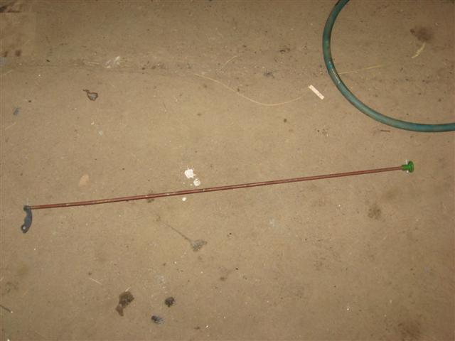

here is the reproduced starter rod, origional was missing
here is the remaned exhaust/intake mainifold. the port that is pointing up connects to the exhaust elbow and muffler (pic to follow) and the carb connects to the port pointing to the bottom of the pic.

here is a pic of the remaned exhaust elbow and muffler
here is the fender and driveshaft cover (started sanding)
here is a pic of the cleaned up frame (still have to do sanding)

a little bit off topic... i was wondering if you guys could keep an eye out for a particular model tractor for me... it is a John Deere Model "62" made in 1936-37 area. i have included some pics as they are not very popular tractors. if you know of the location of one and the owner is willing to sell it let me know, as i am going to be in the need of another project. here are some pics of what they look like....
they are the only tractors that have the JD emblem formed in the front as showned in the pics and there is also one on the back of the rear diff.
****** THERE WILL BE A VERY VERY NICE FINDERS FEE PAID IF YOU FIND ONE**********
It's amazing to look at these pictures. You stop and think about how complex today's tractors are, and then you look at this, and see just how simple they were back then. And yet, they were durable and dependable. Makes you wonder just how much of a good thing technology really is..
