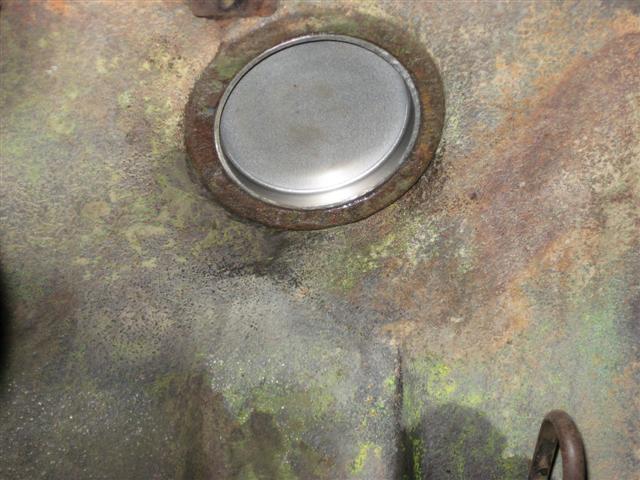

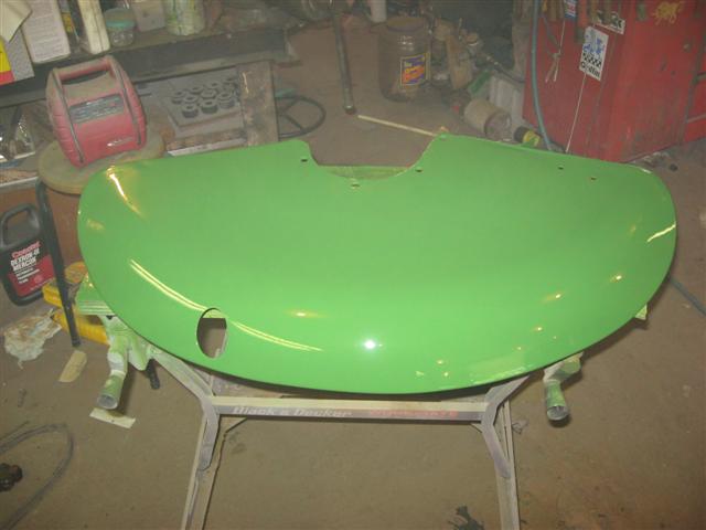

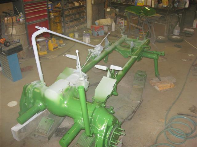

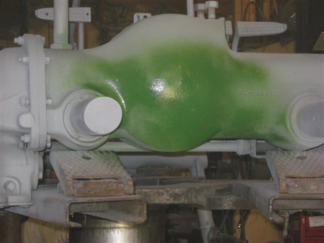

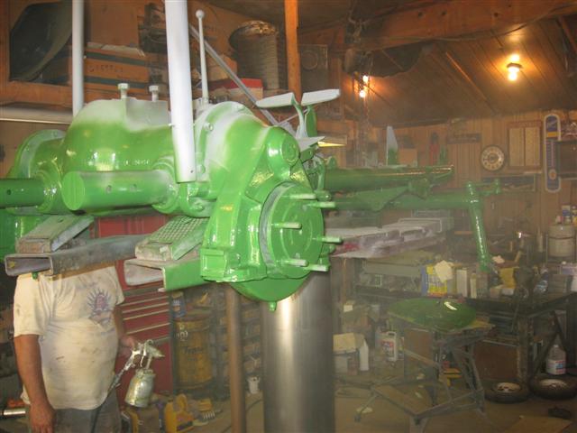

ok here are some pics of what i have done in the last couple of weeks...

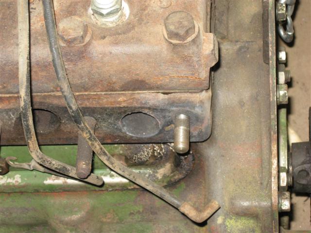

here is the new freeze plug in the engine
new exhaust stud

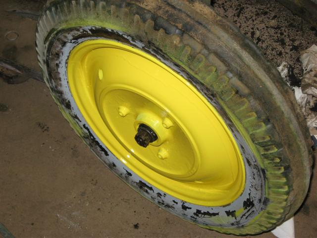

woooo hoooo first item that is fully painted, dont mind the overspray on the tire as it will wipe off

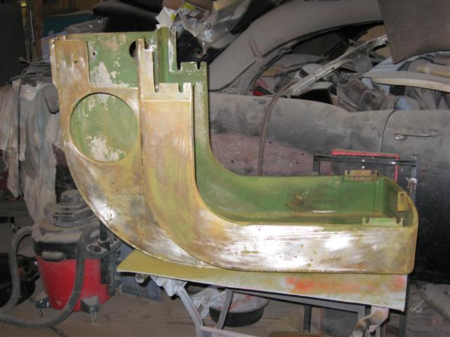

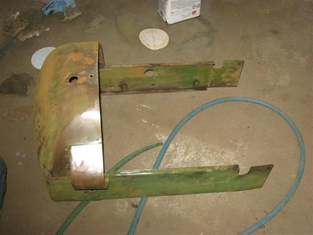

hood sanded and ready for paint
roll pan sanded and ready for paint

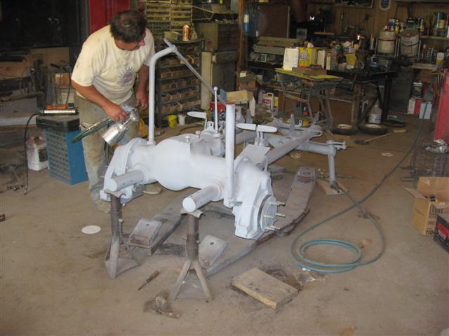

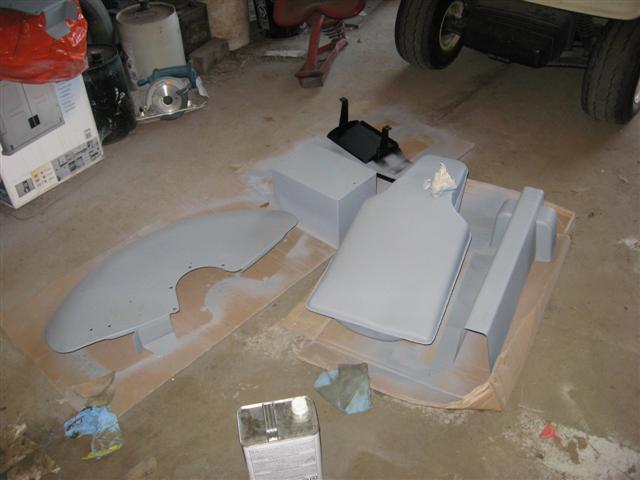

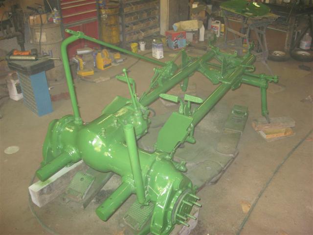

parts primed and ready for paint

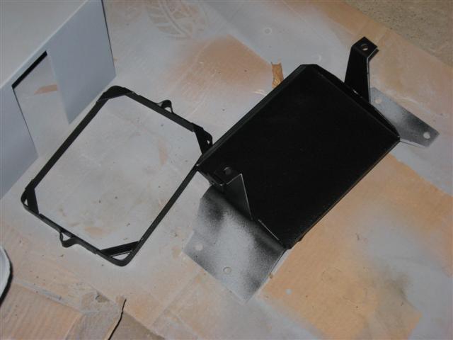

battery box primed and coated with bedliner on inside of box to prevent rot from battery

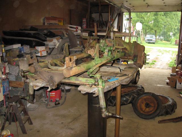

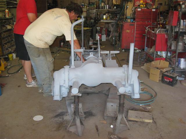

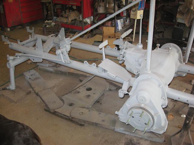

wheels off so frame can get preped for paint

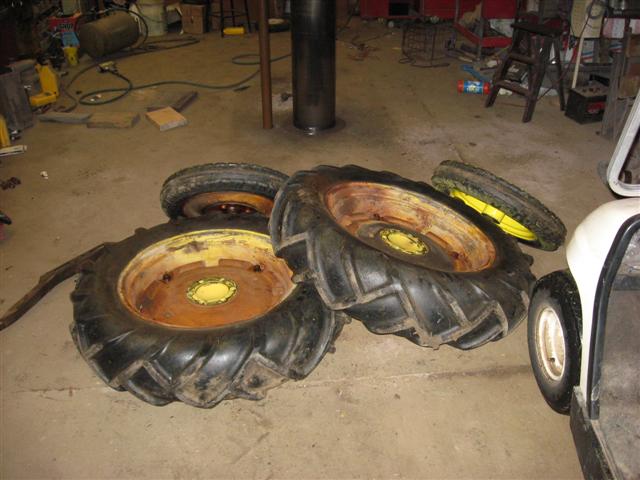

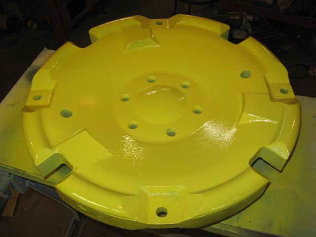

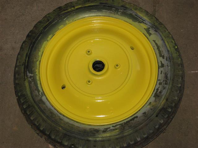

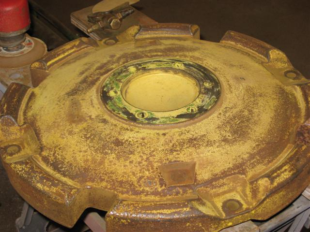

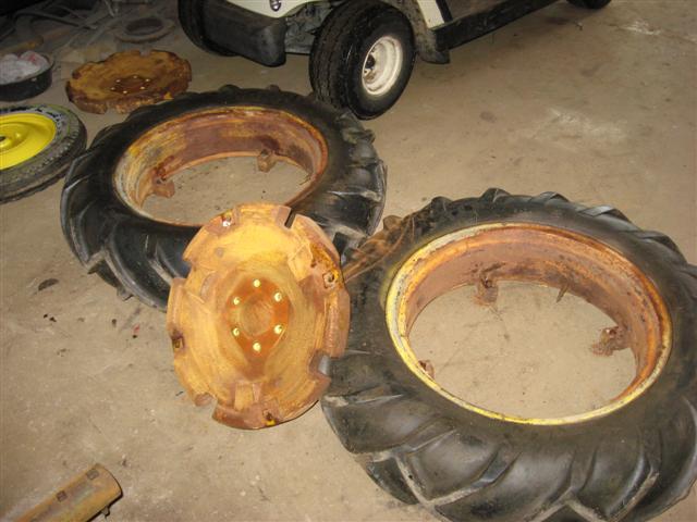

pile of wheels

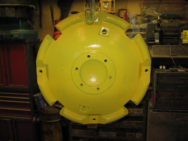

wheel weights removed from wheels
wheel weights sanded and preped for paint

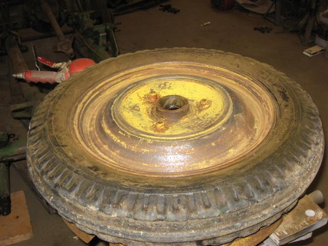

front wheel sanded and preped for paint

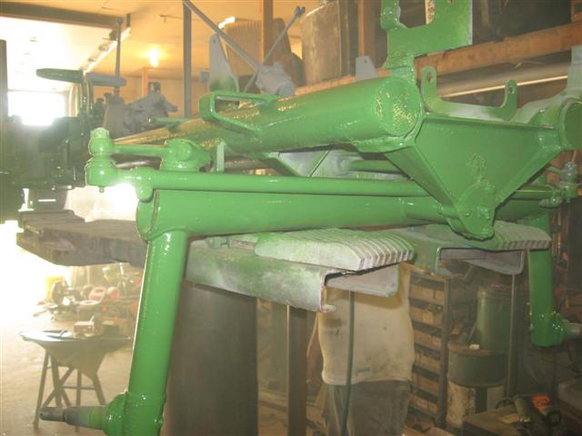

wriott, check out the John Deere in the background of picture #2 on post #9.
I am Oily on that board and have asked him for more info as well as linking him to this/your rebuild thread.

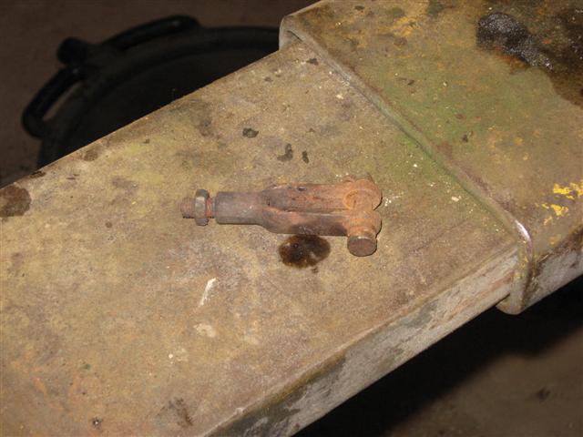

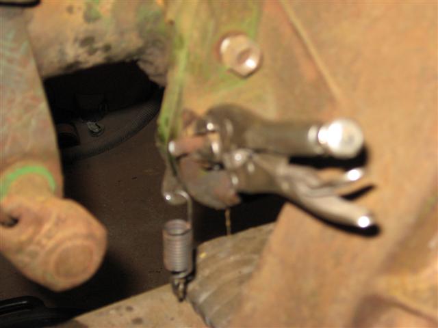

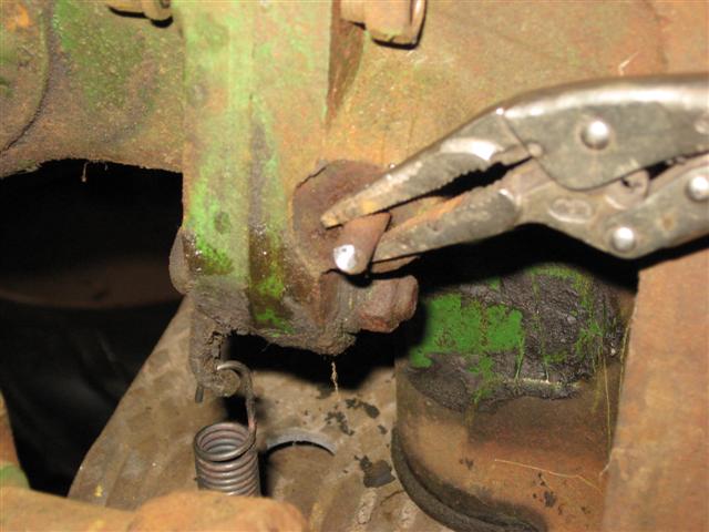

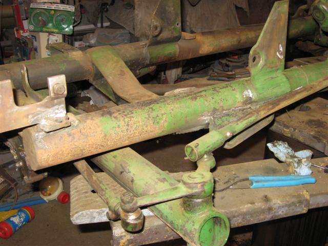

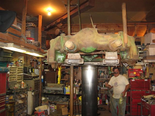

well last night working on the tractor, i have good news and bad news...
good news..... i got alot more sanding done
Bad news, i broke the arm going from the brake pedal into the rear houseing that connects to the brake assy...

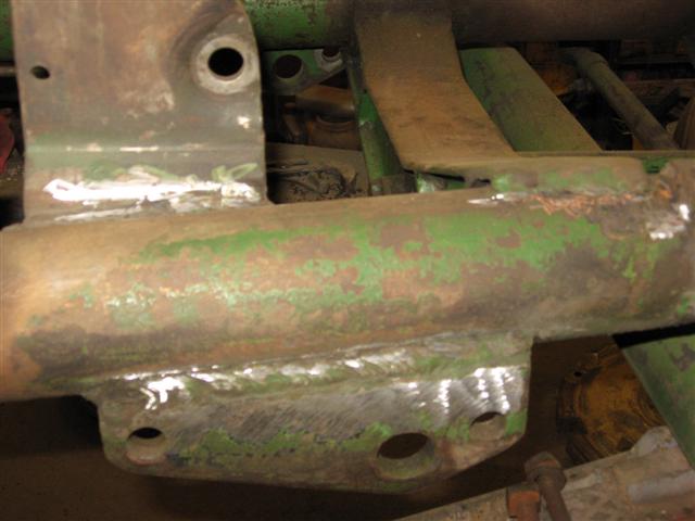

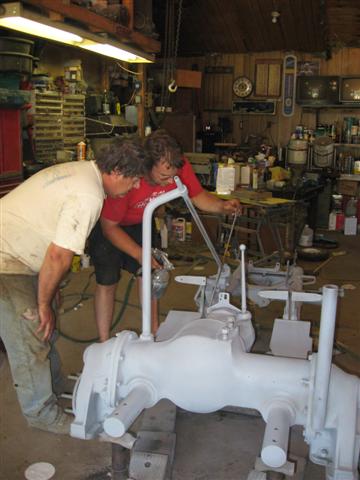

i decided that many of the original welds on the tractor were really ugly and had to be ground down and redone to get a nice finished look
today is going to be research day as i need to locate the rod that i broke, rear hub gasket and possibly brakes. so there might not be any updates for the next couple of days as i need to locate these parts ASAP.

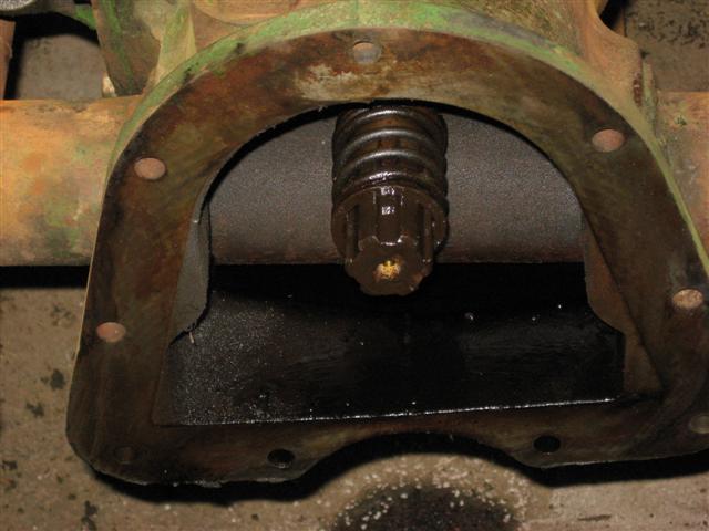

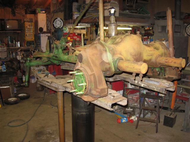

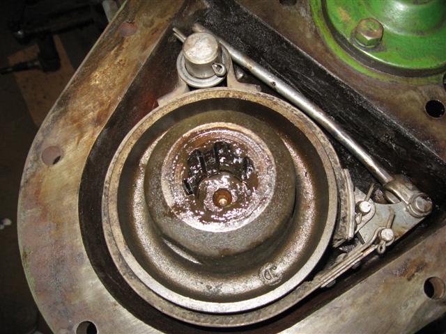

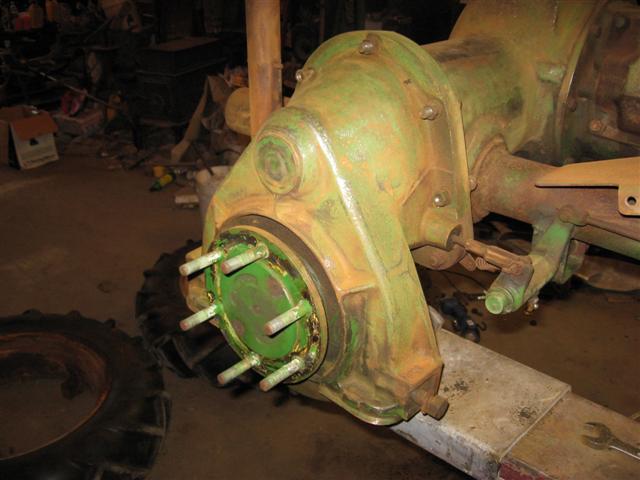

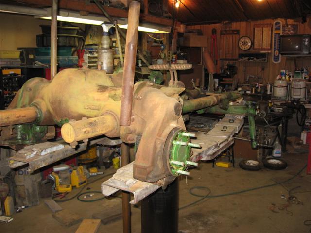

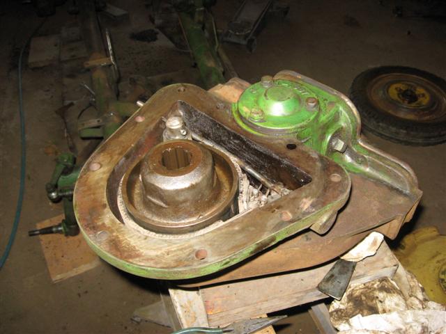

well i have found out that the part that i broke is not available anymore. no problem, just welded another rod on to the clevis and threaded the end for the other clevis.
as you can see the brakes are in great condition so they dont need to be replaced.
a pic of the inside of the rear housing.
thats all for now, sorry for the slow pace, it should be getting faster as soon as the sanding is done. cant wait...

Don't grind down the original welds! I would assume any tractor collector would want to see this thing in the original condition... defects and all. Sort of like orange peel on GM cars

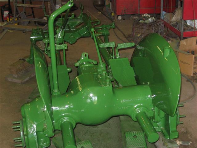

ok here is a very needed update, ALOT of work has been done as the tractor is almost done, should have it running today... here are some pics to get everything up to date...
pics of the rear wheel weights and wheels painted
front wheels

frame cleaned and ready for primer
bolts painted (few of MANY)
primer on frame

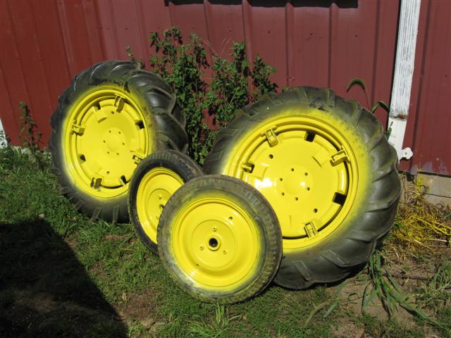

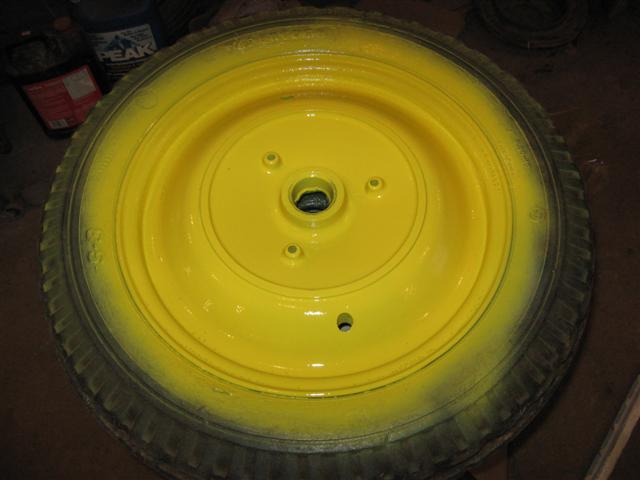

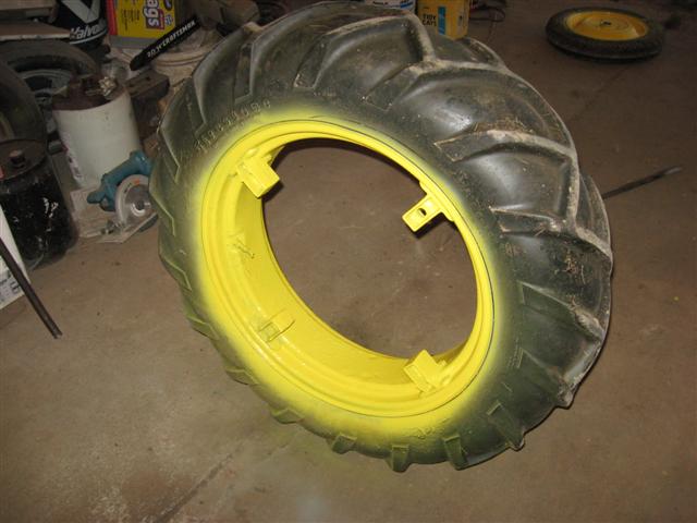

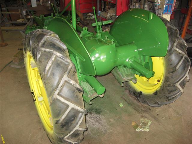

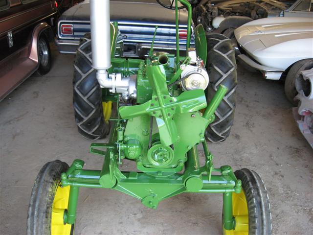

wheels put togeather and ready to be put on tractor
fenders painted

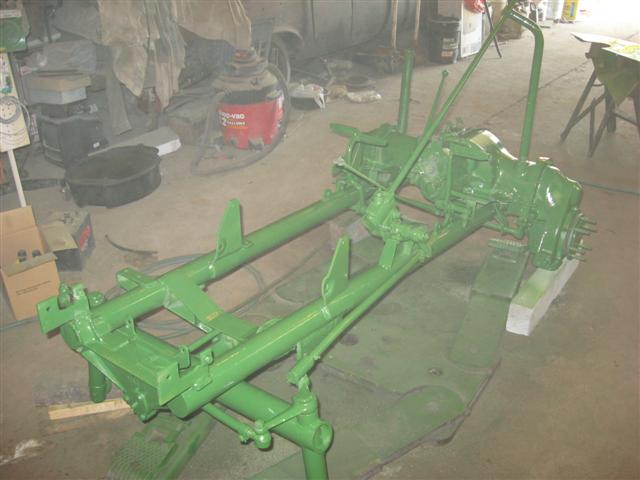

testing color on frame, looks good to me
wriott
Posts: 618
From: Durand, MI
Registered: Jan 2004
Report this Post09-13-2007 09:31 AM Click Here to See the Profile for wriottSend a Private Message to wriottDirect Link to This Post

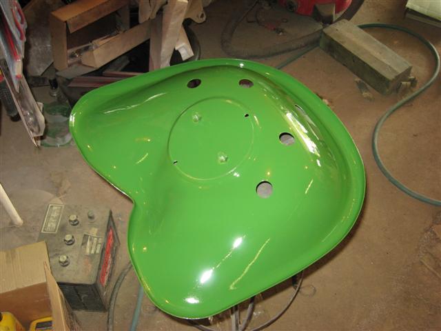

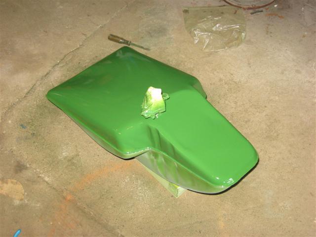

gas tank painted
fenders mounted on frame
wheels mounted on frame

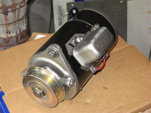

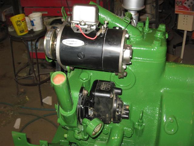

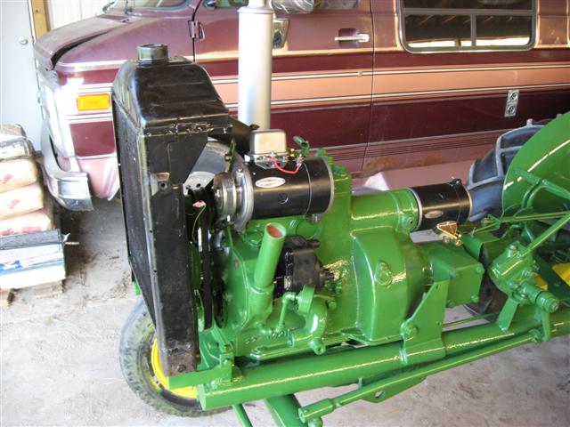

rebuilt generator

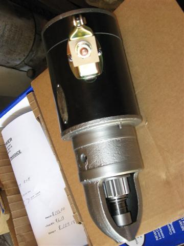

rebuilt starter
wriott
Posts: 618
From: Durand, MI
Report this Post09-13-2007 09:42 AM Click Here to See the Profile for wriottSend a Private Message to wriottDirect Link to This Post
wriott
618 posts
Member since Jan 2004

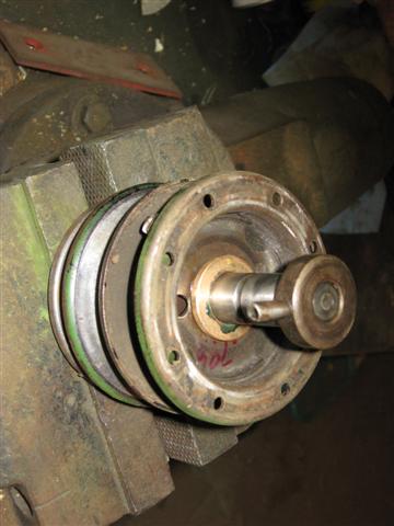

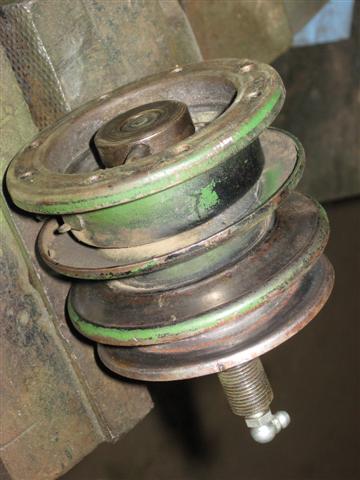

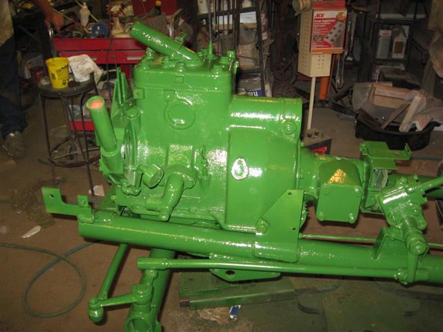

rebuilt fan pully, needed new bushings, and also changed it from an oil bath lube to grease lube for reliability

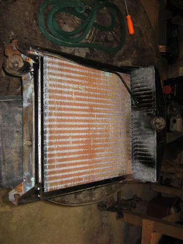

rebuilt radiator

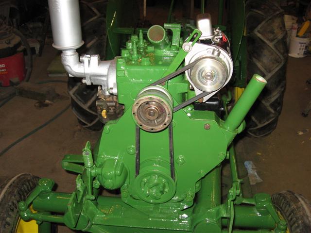

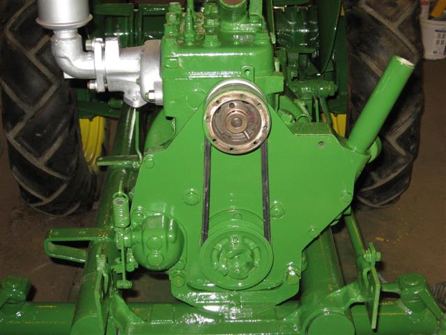

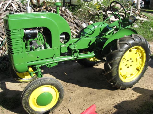

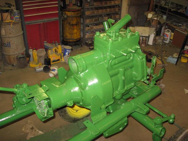

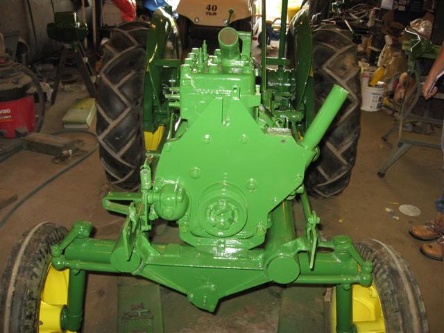

engine installed and painted

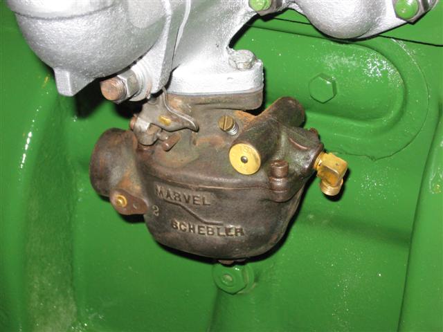

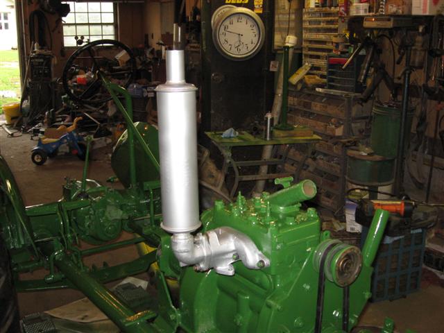

installing other items on the engine

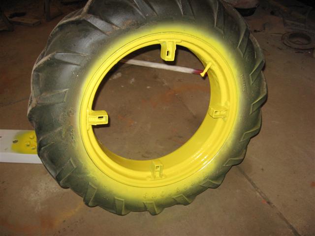

Forgive me for asking something that may be obvious, or sounding critical of your exemplary restoration...
Does that yellow overspray on the tire body just wipe off?
If you ever have to do it again, on your silver and black parts, may I suggest POR-20 (high heat) & POR-15.
It is almost idiot proof (good for me)... and you'll never see rust again... (good for the part)!
yes the overspray will wipe off because we coated the tires in petrolium (sp?) jelly to help clean overspray and to recondition the tires

ok here is a big update....
parts that are primed
and here are the same parts painted

here is a pic of my other "helper" sleeping
filling in the dents on the front grill
fan on the engine
radiator mounted

sorry for the big jump in the following pics. i started to get the sheet metal back on and got so excited i forgot to take pics until i was done.

and here is the tractor completely done except for the decals, i wont be able to order them until october 1st due to the shop being closed. but everything else is done. all i can say is that im glad because i am extremely sick of sanding.... but it was alot of fun and now its time to look for another tractor to restore...
