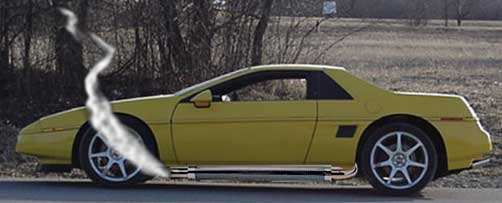

Here's a photoshop someone cooked up.

RickN
Posts: 2891
From: INDY, USA
Registered: Feb 2004
Total ratings: 72
Report this Post04-18-2010 11:37 AM Click Here to See the Profile for RickNSend a Private Message to RickNDirect Link to This Post
I think they have always looked good on various cars when designed into the car (not just hung from the bottom of the car) and would look good on the Fiero. My dislike for them is them is the sound, I don't like the sound due to the outlets being separated by the car. 4 cylinders popping per side is bad enough, 3 cylinders per side would have to be worse.
Well, it would have to be done tastefully, this is not! The pipe would have to be designed into the area where the lower aero trim is now located. ...and a first aide kit would have to be kept handy to treat the frequent leg burns.
Was the OP talking side pipes as in the photoshopped picture I posted or a side EXIT exhaust as in the pic posted by IMSA GT?? I guess it's not clear...
I had side pipes years ago on my Barracuda. No leg burns - they're insulated and/or have a heat shield to prevent burns if you accidentally lean on them.
With the Fiero the engine coolant pipes are behind the aero trim, so tucking the side pipes in tighter would be difficult if not impossible. The BIG problem is bringing the exhaust to the front of the car, and doing a 180 degree turn into the side pipes behind the wheelwell. Basically not very doable. Side pipes are geared for front engines cars like Cobra, Corvette etc. where it makes more sense with the engine layout.
Dumb idea. Everybody would look at the side pipes and say "Hey, wait a minute. Isn't the engine in the BACK of the car????"

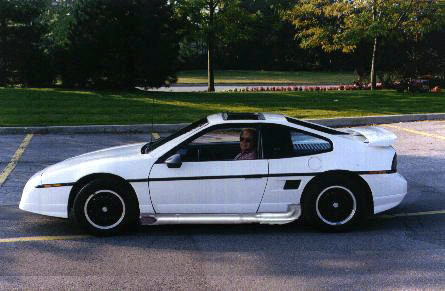

madcurl
Posts: 21401
Total ratings: 314
Report this Post04-18-2010 05:29 PM Click Here to See the Profile for madcurlSend a Private Message to madcurlDirect Link to This Post
WEST COAST FIERO
"Friends don't let their friends drive stock."

Here's how to run sidepipes on a Fiero...

Very similar to the setup above is on the GT owned by club member Capt Fiero. Big difference here though is that it's a nasty 4.9 pumping out noise from the side.
It's a work in progress...
www.captfiero.com/videos/mycar/49testflash.flv

I have always liked Laker pipes. In a front engine car they make sense. True duals, less pipe, and nice chrome dressup.
On my GT when designing true duals, I looked at what it would take to do it. From a design point of view there were allot of complications. Ground clearance if I went under floor pan, some creative body work if I went out through the ground effects to the side.
From a noise level point of view, it was probably too loud for my neighbourhood (yeah I'm one of those Fiero guys who likes to have good relations with the neighbours)
If using true duals, it is actually harder to pipe the exhaust forward then rearward, given the geometry of the cradle.
I ended up using the stock exhaust notches.
All that aside, if you are running a crossover down to the stock CAT position, an engine can survive nicely with 1.5" true dual pipes. 1.5" pipes can be tucked in pretty well if you insulate the floor above them. You would not want the big Laker pipes used in Camaros but you could fab up some yourself out of smaller tube and have them plated.
I think it is do-able for somebody. You should bear in mind though, that anything over 6' of pipe will kill your exhaust pulses and the smaller the pipe the higher the pitch of the sound coming out.
Arn
Heheh...
Tho, cars like that make me change my mind about notchies...
