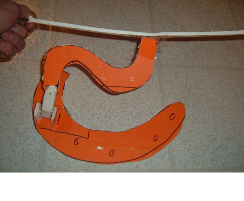

... the past three days have been nothing but snow, wind and ice storms this sucks. I cant even open the doors on any of my Fieros. Im apart of hearland btw I was at the last show with my 3800 swapped 86, maybe someone remembers the erecter set spoiler and the hyper extending hood lol
I think it would be really neat if someone came up with a design that worked, and turned it into templates and let it become public knowledge. Something you could make with somewhat basic shop tools, tools you can get at harbor freight. Make the pieces easy to cut with regular tools but still maintain function etc..
At least the DIY-er would have a good shot at making something like this before giving into one of the more mainstream hinges.

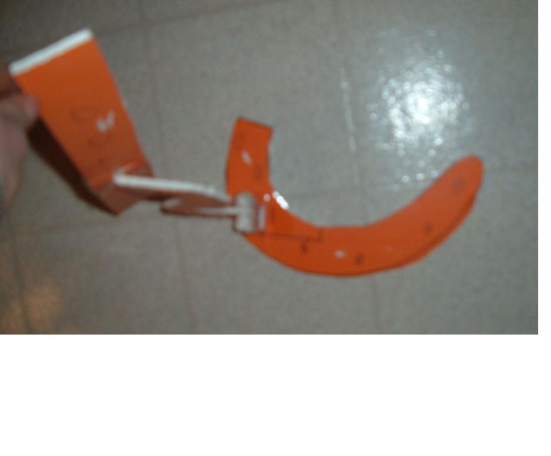

I just found this thread, once upon a time in high school I thought I could make my own vertical door hinges, I mocked one up out of foam, then made one out of metal. I gave up on the idea after a little bit, my prototype didn't have bearings or anything, it was just metal on metal. I didn't think it was possible to make anything come of it.
Here's the foam one, in the closed position:
The part that looks like a "C" would mount to the frame behind the fender, and the long straight part would mount to the door.
You would first open the door a little bit, like this:
Then it would go up:
Then I made one out of metal, I didn't include the part that would mount to the door, this "prototype" was just to try to understand the hinge mechanism and see if it would work. Closed position:
Then open:
Then up:
I thought about trying to put skateboard wheel bearings in it, but never went any further with that plan. -Mark

Chris, your prototype looks pretty good for being so simple...
Chris Hodson
Posts: 3101
From: Carpentersville
Registered: Aug 2006
Total ratings: 53
Report this Post12-22-2008 05:47 PM Click Here to See the Profile for Chris HodsonSend a Private Message to Chris HodsonDirect Link to This Post
looks more durrable than my prototype
lol Thats neat
Mark, I am soooo sorry... I skimmed over the last few comments, and for some reason, I thought this was the work of Chris Hodson... Excellent mock-up.

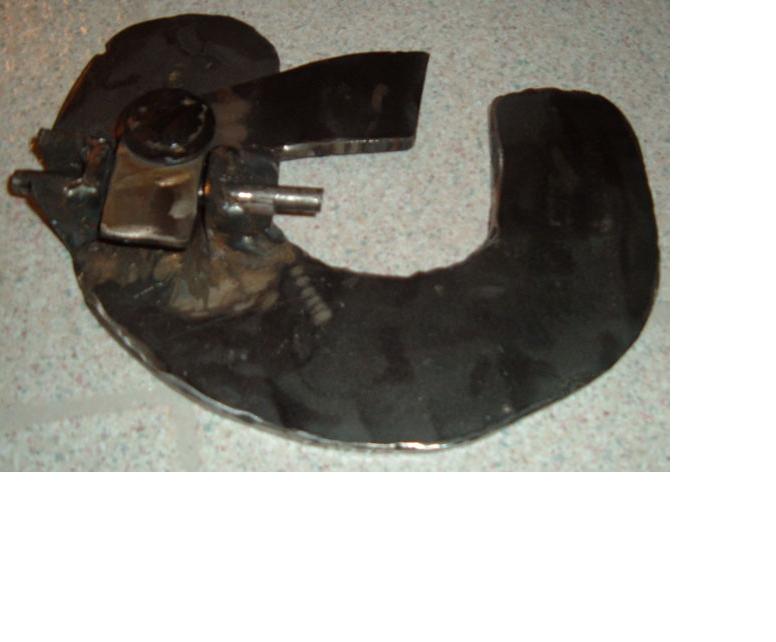

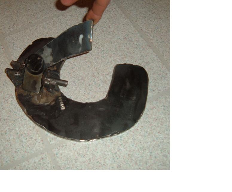

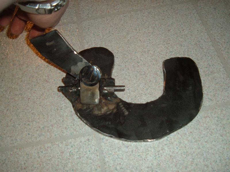

OK,
For those of you looking for a down and dirty set, how much work are you willing to do? Welding is required regardless at this point, so would you be willing to do all the tapping required? And would you be willing to get your own purchased parts if provided with a list? That would be struts, pivots for the struts, fasteners, bushings and pins, bolts...? How much interest would there be in a down and dirty base kit that would require full assembly. The only thing that would be provided would be the machined and laser cut parts, and a crude assembly drawing, until I can get access to better drafting software, or photos of an assembly process. Jesse and I have discussed this and are kind of at a crossroads on the subject. I will say this, that the struts and pivots came from O'Reillys, the bushings and pins came from Motion Industries, and the fasteners came from Fastenall. I'm pretty sure that all of these companies are nationwide. For those of you looking to get a set right away this is going to be it. For those of you looking for a near bolt in you will have to wait.
So to be clear a down and dirty set requires:
1) tapping
2) grinding
3) locating a supplier and ordering you own parts
4) assembling the parts
5) welding the swing plate to the door plate. (this needs to be done anyway)
6) welding the swing guide (this needs to be done anyway)
And will be supplied with only the fabricated parts as follows:
1) door plate LH and RH
2) pivot block LH and RH
3) pivot block cover LH and RH
4) Swing arm parts LH and RH
5) pillar plate LH and RH
6) Swing guide LH and RH
A complete set includes all the above except for the welding of the swing plate to the door plate and the welding of the swing guide to the pillar plate.
It is quite possible that people out there can get the purchased parts wholesale whereas Jesse and I have to pay retail. I don't know how the numbers will compare, but I'm sure there will be a savings of some sort.
You can contact me, but I'd rather you contact 88lambofiero. I'm not sure when we will get a 100% bolt on kit. We will be working on these this summer. There are a couple of cars for sale locally and we are trying to secure funding to get these cars. One is an '88 GT and the other is an '86 se. I also have old blue in the garage that we will probably end up butchering instead of sacrificing a good car.
Show us the interest and we will gauge from there on how to proceed. Jesse does want to rework his car since the first prototypes are on his car. So I can see a new set on his car by the time the Dells Run comes around.
