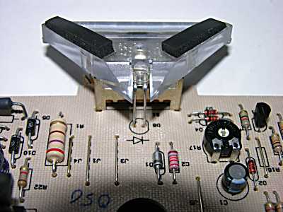

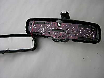

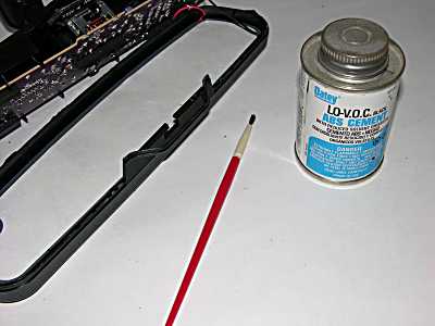

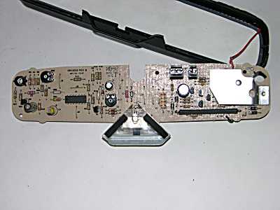

Decided to give that darned auto-dim mirror another try and discovered how to get it apart. So, here's my "mod the mirror" post in case someone else wants to get that "just so" look.
I'm starting with an auto-dim mirror from a mid 90's Cadillac; they're plentiful in junkyards and can be found on eBay for under $20. They look like this:
They work very well for cutting off that "SUV headlight right in the mirror" glare at night. I put one in my other Fiero and like it - except for the switch illumination. It lights up green; wrong color for a Fiero.
To change that, start by popping the mirror case apart. It's not snapped together as I thought, it's glued together (grumble) along the outer seam. Start at the top of the mirror; you won't see any whoopsie marks there when it's in the car. Gently but firmly, pry the seam apart with a screwdriver. Once you get the first "pop" it's a simple matter of working gently around the mirror seperating the two halves:
They're kinda complicated inside, aren't they? Remove the screws holding the circuit board to the mirror back and lift it out:
The switch panel is actually a light guide that illuminates all the markings using the light from a green LED:
Carefully unclip the light guide from the switch housing to get to our target: a generic green LED:
Desolder it and replace it with a generic red LED - I used a high brightness red one from my parts pile that matched in size:
Be sure to get the polarity right; there's markings on the circuit board to guide you. Solder in the replacment LED and replace the light guide. Reinstall the circuit board to the rear mirror housing, don't overtighten the screws. Now, you're ready to glue the mirror back together. It's made of ABS plastic and ABS pipe cement from your local hardware store will work perfectly. Use a small paintbrush to neatly apply it to the edge of one side:
Put it together and hold the parts in place while the glue sets up (a minute or two). Let the glue dry thoroughly before installing the mirror in your car. End result: a nice auto-dim mirror that looks like it belongs in your Fiero.
