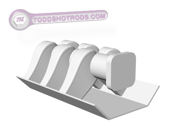

I like the idea because I generally like making things as clean and simple as possible. The big question, that some people with the stock intakes would have to answer, is whether it would be possible to bolt the plenums to the middle intake and then bolt it to the lower intake? Also, the issue of whether people would be comfortable drilling the holes out. The upside is it would also save a good bit of labor in assembling the bolt on plenums = lower price. Something to look into for sure.
Yes it is possible to bolt the plenums to the middle intake then bolt the assembly to the lower intake, more than enough room. I can drill holes out, no problems there.

I am going try to determine a price for the intakes next week. I like the bolt-from-the-bottom design (thanks Raydar ), so I will concentrate on that.

Well cool! I was certain that I had overlooked something. That's usually the story.
Are the flanges going to be gasket matched?
IIRC, there's a little bit of extra material in the middle intake that can be ported out. Not much, though.

Yes, I am going to model the part from a gasket.

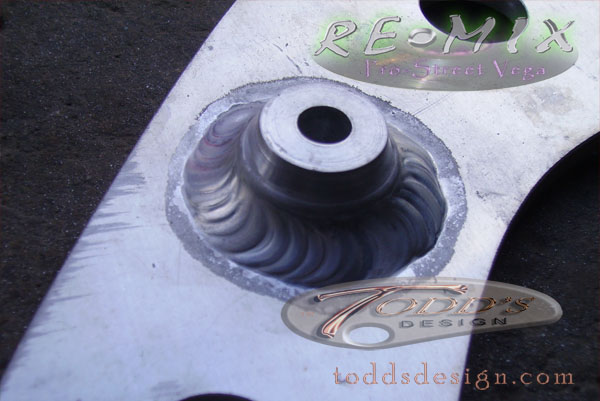

On another positive note, I think I found a new weld shop to sub work to. I asked him if he can do the "row of nickels" TIG beads I need and he pulled out a scrap piece of aluminum and laid a couple nice beads right there! If his work ethic matches his quality I may be abl to start cranking out some parts! Here's hoping...
When I pick up the parts I dropped off I am going to talk to him about the intakes. Ideally, I would like to do a dozen or two dozen pairs at a time.

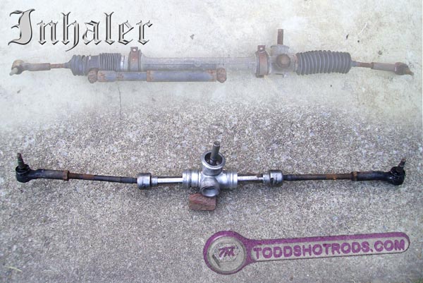

Finally got around to cutting the end of the rack shaft down and threading it. Here is the narrowed rack assembly. I am going to turn oil-impregnated bronze bushings to fit in the ends, and make custom boots. The inner tie rods will be replaced with new ones eventually, and the outer te rods will be replaced with road ends and custom bump steer adjustment bushings.
Next up, before all that, I am going to narrow the FIero crossmember and get it set up on the vehicle.
Think you could do something with a Chevette power rack to widen it the same as the Fieros? It has the same mount points.

There are a couple options. If the mount design and spacing is the same as the Fiero's, inner tie rod spacers can be used. THese are common with Mustang II IFS suspensions for street rods. Ideally there might even be some with the same thread diameter and pitch, in the needed lengths.
If the mounts are the same but too narrow, it may be possible to widen the housing but I would have to at least see pics of one disassembled to know for sure.
You may know this already but the goal is keeping the inner tie rod pivot points the same width as the Fiero LCA pickup point width.

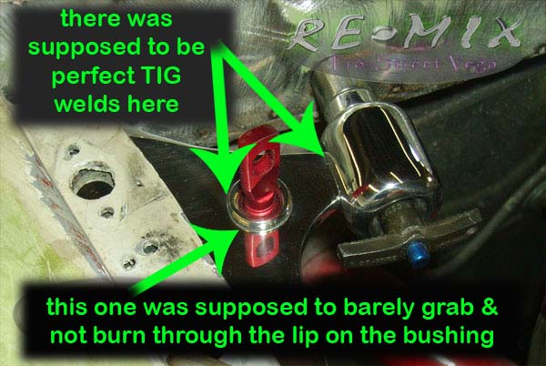

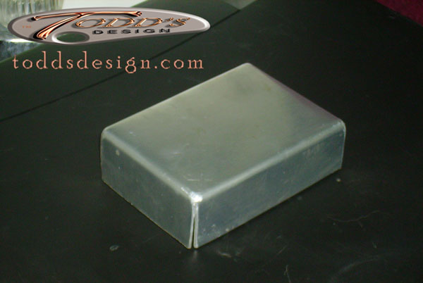

Totally incompetent He almost ruined a lot of work! The welds were horrible, and he even managed to weld one of the parts backwards! I didn't even say anything I was so mad, I just took the parts and left. I had only noticed the bad welds, and when I got back to the shop where the project is the owner of the car (Vega mentioned in the beginning of this thread) saw the backwards part. I am glad I didn't see it before I took them because I might have lost it.
I wanted to take some pics of the damage but I didn't have my camera. I couldn't stand seeing my hard work so mangled so I cut the backwards part loose with a Dremel and removed all the weld; so it could be welded on in the right direction. The parts were supposed to be fabricated parts, with perfect TIG welds showing how they were made, but since he messed them up so bad I had to blend them - now they look like ordinary billet stuff
This is one of them before I took them to be abused:
I'll post pics of the salvaged parts when I get a chance. The barrel-shaped part was welded on backwards on one of them.
Sorry for the rant... Did I mention that I am

I just sent the rough draft models and info to get a quote on having the dual plenum parts cut. I am scrapping the low-budget, profile-cut, base plate idea. They will all be fully radiused at the port's entry in to the plenum.
I am going to stick with the welder I had before, until I find someone better and faster. I'll have an estimate from him today or tomorrow on welding them up. He's good, just really busy with big money projects; so little guys like me have to take a number. I'll take quality over quantity though.

Before I go too far on the 3800 intake model:
Too much, too little, in the ballpark, it's outta there, what the heck have you been smokin?!?? Got your own smart comment?
This is the first thought I had on it. I just modeled a quick base plate to get started and there are no real details anywhere yet, just the basic layout and shapes...

Take your time and have fun doing it! I'm in no hurry whatsoever, but am eagerly awaiting the final piece, can't wait to see it Looks great so far!

cant wait to see what it will look like

I forgot about a critical measurement - the height. I am assuming this has to fit under Fiero decklids, and W-body (???) hoods. We need to find out how clearance there is. The measurement can be taken from a point on the lower intake, e.g. the thermostat housing flange, an intake mounting bolt hole, etc.
Also a disclaimer is needed here.
I can't guarantee any specific power increase from such an intake. I would imagine it would provide some benefit, from being less restrictive. I can provide the creativity and quality, but if the goal is maximum performance we would need to have someone onboard to develop the ideal runner and plenum size. I just don't want to mislead anyone into thinking I am doing something more than what I am.

i will get you the hight, the supercharger fits under the hood with a intercooler so i will just take a measurement off that

Here's where I am going with the MAP sensor cover. Simple aluminum cover, will be welded on the corners, with slotted mounting holes in back (as requested).
If you guys like this idea, I was going to drop this one off tomorrow to have TIG'd. Once you guys see it and approve, I will have at least a dozen more done and they'll be here ready when you want them; and probably on eBay.
