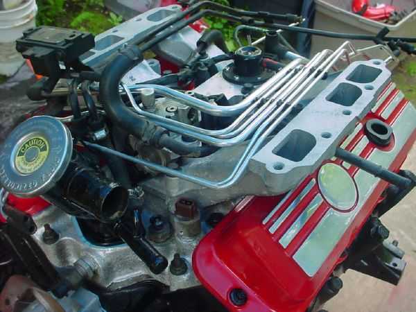

Okay so for the last two years that I have been going to Fiero related events, I have been without my car. And just the same everytime I run into someone that knows me they always ask, "Where is your car?" I always answer the same, "In the same field it's been sitting in for the last two years."
Well I wish I could say that it is no longer sitting in that field. But I can't. But I thought I would post some pics of the engine that I have been trying really hard to get built. I must go on to say that I have never rebuilt an engine and this is the first time that I have ever touched a V6. So at this point I would like to thank some people publicly that have been extremely helpful with my project(s):
Doug Kinney - Fiero Warehouse
Ed Parks - Fiero Factory
Mike Hornsby - PFF Boilermaker
Tedd Wilson (dad) - Sage Glassworks
Cliff Pennock - Pennock's Fiero Forum
and if anyone else has ever ansered a question for me please forgive me I have been working on this thing for two years and I can't remember everything.
SO here are the engine pics so far. All thats left to do at this point is mount the harmonic balancer, the crank pulley, an alternator, exhaust manifolds,starter and the a/c compressor. WHich by the way if anyone has and extra set of mounting bolts for the a/c I could use them. Than of course I get to start the whole four to six swap on the car itself. Enjoy!
Thanks for reading and take care,
Anthony

WOW, looking good. I see that you made a purchase from Rodney Dickman. I love the Stainless Steel Vacuum lines that I have on my 88 GT.
Looking at what you have I do have one suggestion for you. I see that you are using a stock EGR tube which are known to not last very long. If you want one that will last the life of the motor go ahead and put one of the braided ones from IRM or the Fiero Store.

I'll keep the EGR tube in mind but since that is a brand new OEM part I think it will stay on there for now, and the price on it was right for my budget, that was another factor in my judgement. AS for Rodney look a lot closer and you will find a bunch of his accessories, exhaust manifold stud, oil filler cap sticker low temp thermostat and switch, vac lines, heck I don't remeber them all anymore!

Where did you find a red distributor cap? Is it painted?
Head to Crappy Tire(Canadian Tire) and pick up a Wells distributor cap.

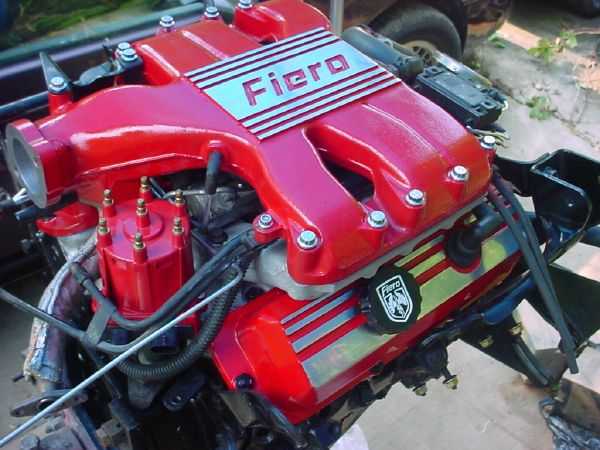

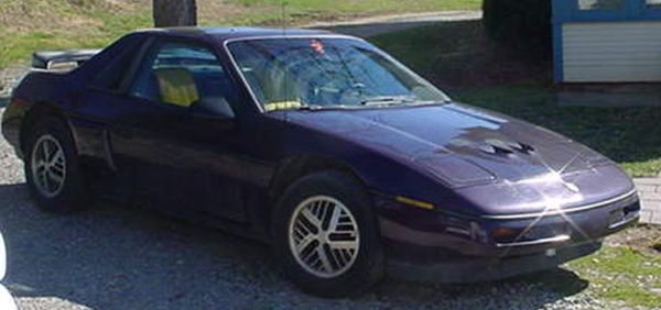

Just wanted to explain a bit more about the project.
The car is an 88 coupe. It is painted GM Blackrose with a set of Fiero Warehouse Full panel scoops, and a custom hood utilizing a set of Trans-Am Fender vents. And also a JC Whitney Fiero wing.
What I am doing is conveting to a V6 from the stock L4. I am also converting to a Getrag from my stock 5-Speed. I am trying to simplify the whole process by haveing pick-up a spare 88 cradle, essentially makeing the whole thing a plug and play when I remove the L4 setup. The good news is I was able to find an actual 88 V6 engine mount so essentially, after also haveing located an 88 upper intake, I will have a Formula clone. Cept now I have to find a rare sway bar for the 88 suspension!
After I received the 2.8 I had it bored 40 over and dropped in a 3.1 crank and a set of 10:1 pistons. I also put a new cam in and a set of roller rocker. I will have to look up exactly what cam I went with. Went with a high volume oil pump as well. I also picked up a set of exhaust manifolds that have the restrictions removed. Pick-up a Wells Dist cap and rotor while I was rebuilding the distributor. AS I mentioned earlier I have a ton of aftermarket accessories on the engine in order to help dress it up a bit and actualy hope to help in maintenceing and serviceing the engine.
Sorry to have taken up more bandwidth and time but as the proud "father" of my baby I wanted to share family photos a bit. Mainly because most of the work that has gotten done has been done within the last couple of days. I also wanted to mention that I would love some additonal prayers to the Fiero Gods, I have planned a vaction for Sept 6 and I hope to be able to get the car running within that given time frame. Then Maybe I can start the actual "mods" I want to do

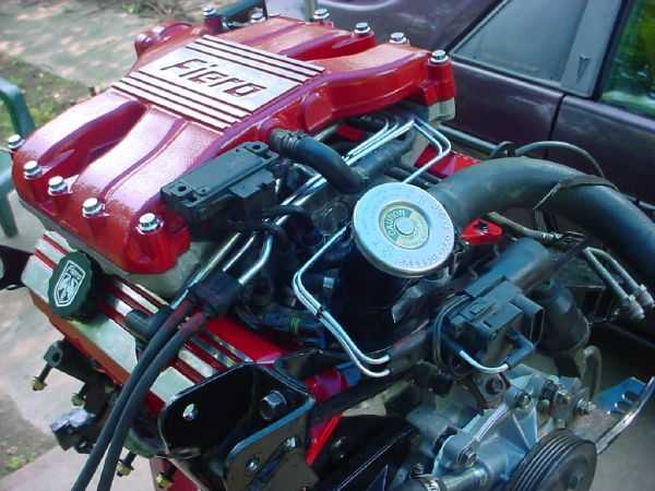

You might consider keeping your existing 5 speed if there's nothing wrong with it. Lots of 3.4 swappers have found that that they like the gear ratios in the Isuzu 5 speed better than the Getrag. And you can probably get 3 or 4 Isuzus for the price of one Getrag.
A word of warning if you plan to have A/C.
If you're using the V-6 compressor, you will need to add the pressure switch (and wiring) to the drier, in the front compartment. The easiest way to do it is to get a complete front harness from a V-6 car with A/C. This is the same harness that feeds the blower motor, wipers and washers. NOT the headlight harness. The 88 4 cylinder uses a different system that replaces the low pressure switch with a wire jumper. If your system leaks down, the compressor will keep running and eat itself. Don't ask me how I know this.

where did you chance on that oil cap?

It is a stock cap but with a Dickman sticker on it from back when he sold them.

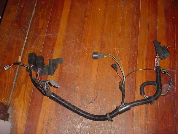

Originally posted by Raydar:
Maaaann! Lookin' good! Hope it all comes together as easily as you want.
Is this the harness that you are referring to? I took this off a parts car that already had the condessor removed and basically this harness was just hanging there in the open But I knew the car was a V6 with A/C so I brought it home.

Originally posted by Reality:
Is this the harness that you are referring to...?
Yup. That's the one. If you compare it to the one in your coupe, you'll discover that the low pressure switch connector (it's the round one at the top center of your pic) is missing. You'll also need the low pressure switch. It's a plastic device that screws on the schrader valve on the side of the drier. It's the schrader valve nearest the firewall.
You will want to install an O-ring over the valve when you install the switch.
You also asked about the compressor harness. I believe the wiring for all years of V-6 compressor is the same. It's part of the engine harness.
The main "gotchas" are the oil sender wiring and the alternator wiring. The oil sender may have changed in 87. I know it changed for 88.
The early sender has three flat blades on the top. The later sender has three round pins. Just buy the appropriate sender to match your harness.
The 88 V-6s got a CS alternator. It's physically smaller, and the wiring is different. If you have the alternator that came with your engine and harness, you should be okay. If you want to convert to the later type, check Ogre's Cave link.
I think any year V-6 harness will work with your existing car wiring.
My donor car was an 88 Formula. Everything plugged in and worked perfectly (except for the A/C snafu that I mentioned earlier).
The only other thing that I can think of is almost not worth mentioning. But as sure as I don't, it'll show up.
On nearly all V-6 harnesses, the injector harness uses a wide flat connector. On just a few 88s, the injector harness uses a connector that is nearly square. I have no clue why.
Several of us have done this swap.
If you have any other issues or questions, just ask. Chances are, one of us has been there.
raydar

Thanks Thanks Thanks! Wiring harness for the engine shoudln't be a problem. I did stumble upon that alternator upgrade deal the other night and was thinking about undertakeing it seeing as how I don't have an alternator yet. I was also told to just take a stock one to a rebuilder and have it beefed up?

OKay what is on the agenda? Well I took my Notchback and put Fastback taillights in!
OKay so it's a bit more complicated than that. But that is how my idea started out. But I have this crazed idea that if you are going to mod a car then it needs to look like something from the factory. That is how I came up with my method. My rules on this project are that I am useing the fastback taillights and a fastback decklid and I can't modify them in anyway, (in order to get it to fit) SO I came across a fastback clip that was donated to me for the cause of my project, don't worry it was busted to begin with. Now I had the taillight houseing that I was going to need for the lights.
I already knew that a fastback sits right around an inch higher overall then a notchback. I was going to have to modify my stock clip. SO that is what you are seeing in the infancy of my project.
I removed my stock clip and bolted the fastback taillight houseing in place. I then place the notchback clip in place and measured for the cuts. It only took me about three cuts per side to get it right too! After I had the two clips in their respective places I bolted a borrowed fastback decklid in place to see exactly how much filling was going to be needed in order to bring the notchback up to the same level as the decklid. While I was doing this I did some more measuring and figureing and realized that I was going to be able to use a set of fastback engine vents without modifying them as well.
So I am currently makeing some fabricated parts in order to fill in whats left. Then I have to bring the notchback level up to meet the decklid and I will basically be done.
I have already switched the wiring harness over to the fastback lights, so that is one problem out of the way! ANd once all this is done to point of primer I will go back to putting the engine in. WHich by the way if I haven't mentioned it, it is done and sitting on the engine stand waiting to be put on the spare cradle, I just have to get the Getrag back from the shop and get it mounted first.
SO what is where I stand on "Real Dreams - Project Reailty!"
Anthony

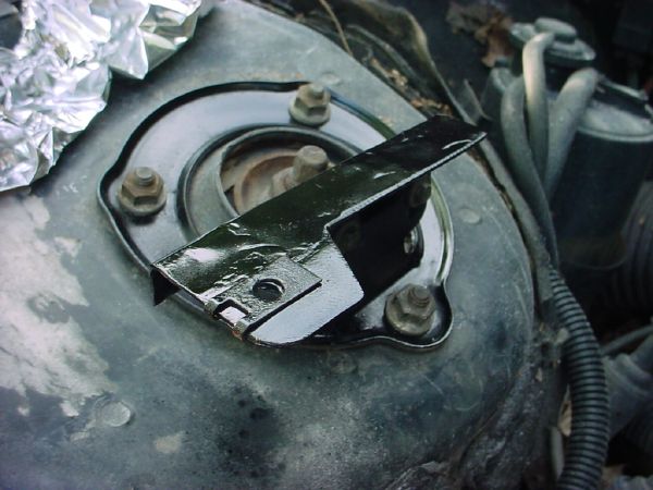

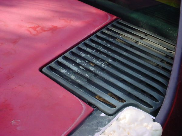

This is the bracket I had to fabricate, so that when I placed the fastback engine vents in, they would be flush and level with the decklid. And before anyone asks when I didn't just use stock ones, If you happened to have an extra set of factory 88 fastback vent brackets by all means send them my way, but as I didn't found out until too late the strut towers on an 88 compared to previous years are different and my stock 86 set of brackets I have would not work. So after doing some looking and thinking I came up with this design utilizing my stock coupe brackets. This allows for a cleaner look once the vent is in place.
And Voila! The vent is now flush and level.
ANd just wanted to show a picture of how I filled in the gaps I created when I started trimming unwanted SMC. I used two cans of Great STuff expanding foam. Once it had expanded I used a knife wo trim to shape and then some nice 80 grit paper to sand down to correct height to accept fiberglass. This also somewhat shows how I am dealing witht he height difference between a fastback and my notchback.
Also have to put in here that I did drive the car the other day. Not exactly the way I want to but I put a battery in and moved her under the power of the four banger. I was suprised after not haveing been moved in almost two years the car pretty much started right up and drove quite well for an engine with a rod knock.
I have finally located most of the tranny brackets I need for my Getrag and I am going on vacation in exactly four days as I write this. My plan is to hopefully have this car moveing under the power of the V6 and Getrag by the end of vacation on Sept 14. So please pray to whatever Fiero Gods you need to, cause I can use all the help I can get.
I also want to go on record at this time, to thank my farther, Tedd (Sage) Wilson. He has been a great help to me on this project and although I would like to be able to say I did this project by myself I can't He has helped me through some very rough spots, and actually if it wasn't for him I probably wouldn't even be working on the car right now. He has motivated me and pushed in some rather odd ways at times, but through everything thus far he has been there more than anyone to help me.
So thanks dad, . . . and I'll be out Thursday to do some more sanding
