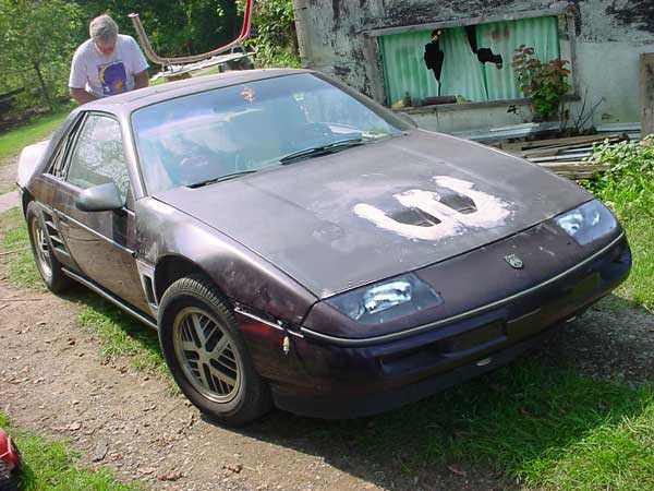

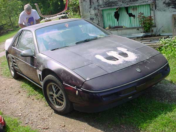

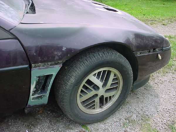

DAY 1
Just wanted to post a quick update as to today's progress. I worked on getting the TA vents into the passenger fender and also started work on removeing the luggage rack from the Fastback decklid I have. While I was doing this Dad started work on shapeing the clip! And I must say he did a bang-up job.
I am really excited with the progress that has been made on just this first day of work. If the same leaps and bounds can be made when it comes time to put the engien and tranny in, this car will just end up being awesome.
Thanks for takeing the time to look take care,
Anthony

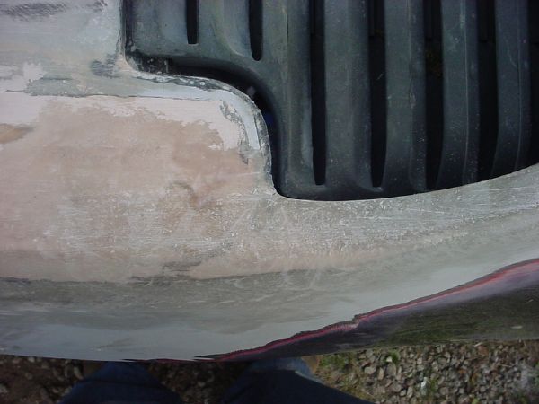

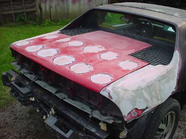

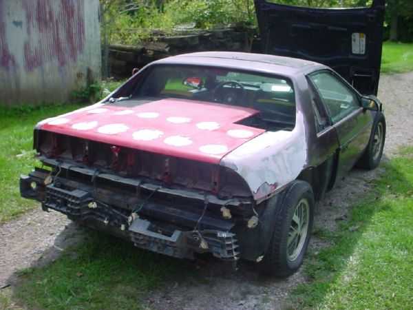

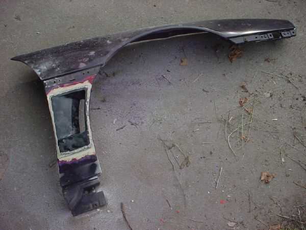

DAY 2
First on the tour is the re-shaped edge to the notchback clip so that it flows with the fastback vents a bit better than it did.

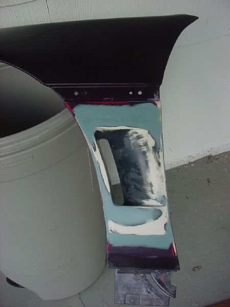

Also today I worked more on the decklid and filling the wholes left by the luggage rack, actually last thing done today before clean up was to throw some bondo on the glass work, this will be sanded first thing tomorrow.
Then of course one of the other projects I was wanting to do was to elimate the antenna. I was at a lost as to what to do about this until I read Skitimes history thread. So thanks Dave for the wonderful idea.
And that's where I stand at the end of work on Day 2. I'm still waiting on the drivetrain parts that I need in order to mount the 3.2 and Getrag on the spare cradle. As soon as all the parts get here I will be changeing gears and concentrating on getting the car to run on it's new powerplant.
Thanks for reading and take care,
Anthony

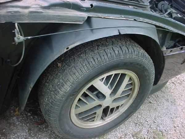

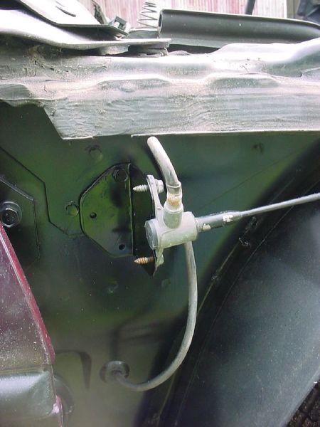

I can tell you what I did but not sure as to what Dave did.
I unbolted the antenna from the car to begine with. I then used the base to help to determine the size for a bracket. I used 16 gauge steel to make a 90 degree bracket that I bolted to the space frame then I bolted the base from the antenna to this bracket. Finally the fender forces the antenna to bend and contour to what's there makeing for a nice clean line above. I do not know how this affects reception. Under normal circumstances I don't use the radio. And since there are plans to install a CD player and changer in the car I really have no use for the radio but would like to have it just incase as a back up. If you read Dave's thread he claims that he recieves just as good reception with the antenna mounted this way. But still opted to add a second antenna which dosen't seem like a bad idea to anyone that might be used to haveing a radio. As for the fender and shaveing the hole. I used the peice from the fender where I added the scoops to fill the gap. I used a grinder to create a recess for the filler to set in, and then bonded and filled the area with corvette panel adhesive.
And finally here is a close up picture of the bracket I made in order to mount the antenna on the side of the space frame.
Hope this helps with everything.
Take care, Anthony

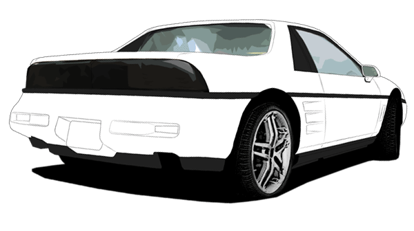

I wanted to post a headlight idea I am toying with.
Please feel free to voice an opinion at this point, dosen't mean I'll like it but I would like to hear it. I am yet undecided as to weather or not I want to add this project to the list. Obviousely there is no real gain cept for the astetics of it. SO yes or no does it fit in or not?
[This message has been edited by Reality (edited 09-09-2003).]

How about something less ordinary for your fine machine? This is similar to what I am doing to mine.

Hey Anthony,
What year Trans Am did you get those vents from (the ones u put on behind your fender) ?
Ski time has the same ones i believe.
Reality
Posts: 1026
From: Marietta,OH,USA
Total ratings: 64
Report this Post09-28-2003 08:15 AM Click Here to See the Profile for RealityClick Here to visit Reality's HomePageSend a Private Message to RealityDirect Link to This Post
I beleive they came off of teh 83 TA but here maybe this will help;
p/n#10030552
p/n#10030553
It was kind of funny actually cause I saw that everyone was going around to salvage yards trying to find the vents, and I posted a questions as to weather or not anyon ehad even tried seeing if the vents were still available through a dealership. Well like most of the time I got ignored and no one answered the question. SO couple of weeks later I was driving by the dealership and decided to stop in and ask some questions I had been meaning to try and get answered. Well the parts manager sat down with me and helped out on a bunch of questions and one of the things he tracked down for me was a the part number for the scoops. And they are still available. Just for some more info I beleive that it is cheaper if you get them from gmpartsdirect.com but I hope this helps anyone out that wanted to find these scoops. They run about thirty a peice.
Take care,
Anthony

Anthony,
Can you share a little on the T/A fender vents that are on the hood? I'm looking to do something like that, and would like to know how you bonded them to the hood.
MinnGreen send me a pic of them finished on a hood, but the pics in this thread look like they've been removed/ground down?
Any info you could provide would be a help.
thanks in advance,
-jeff d
Reality
Posts: 1026
Total ratings: 64
Report this Post10-03-2003 09:19 AM Click Here to See the Profile for RealityClick Here to visit Reality's HomePageSend a Private Message to RealityDirect Link to This Post
Originally posted by fierov8:
Anthony,
thanks in advance,
-jeff d
WHen they were originally installed I had the lip sticking above the line of the hood, like they are on the TA. But After I started all me know mods I decided that I didn't want anything that distracted or stuck up aboce the the bodylines of the car. So I did exactly what you said I used a grinder and removed all of the scoop that was sticking up. As for how the scoops are bonded, they are made of SMC so it was really just a matter of bonding two fiberglass panels together. I measured where I wanted them and used a cutting wheel to cut out the whole in the shape of the scoop in the first layer of the hood. I then cut a small version of the hole in the second layer of the hood. This left a self for the scoop to sit on as it was being bonded to the hood. Only problem I encountered was I didn't correctly measure for the placement of the scoops, so when I shut the hood it was hitting on the radiator fan. I remedied this two ways first I took out my stock 88 fan and replaced it with a earlier year that didn't have the little ribs on the support. That pretty much solved the problem but since I had to grind of the supports for the stock bolts on the underside of the scoops I went ahead and removed a bit more material just to make sure it wasn't going to hit.
Hope this helps with any questions.
Take care,
Anthony

Well only thing I have gotten to since the holidays was to cut out the battery tray. And the another note I have been working on my brothers 86gt which is now the new home to a 3.4 Bad news is I got everything hooked up and ready to go, turned the key and no fuel pump But we hope to work on it again Sunday. I'm kind of hopeing the relay went out and that I don't have to pull the tank.
