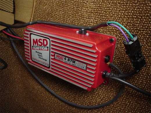

Well today I installed the MSD 6BTM. And drove it home. The car had a very noticable dead spot between 0 vacuum and 2 psi boost, before the MSD. Now it just pauses for a moment. When Rockcrawl and I can sit down I am sure we can make the appropriate changes to the PROM.
The engine pulls really hard even when boost is not above 0, just making the engine not have to work for its air is a huge advantage. This will definately be a mover.
More to come, it was a long day at work today. only a wee bit was spent on the Fiero.

A while back I experimented with an MSD BTM but had difficulty getting it to work properly. The engine experienced a bit of detonation before the retard was introduced. Hope that you have better success with this box than I did.. I've found it preferable to make all the changes to fueling and timing in the chip. As for the dead spot, I was able to cure this on my turbo setup by getting a better "pump shot " via widening of the injector pulse width on the PE MAP vs. RPM vs injector pulse width table. I had to dramatically increaee the pulse width in the PE (acceleration enrichment) cycle to get rid of the dead spots. With my present program lag is not noticable and the engine pulls steady to the redline. Tuning with a turbo is often a difficult task but with enough of an effort, great results can be achieved.

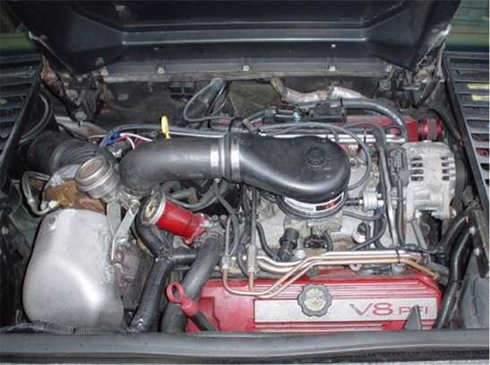

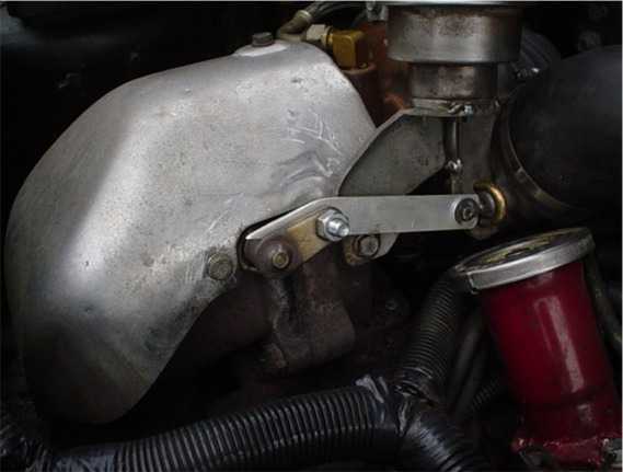

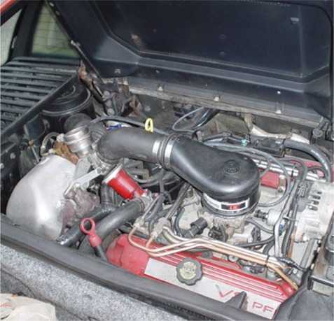

Took some more pics this afternoon:
We have had some struggles with the waste gate control. We tried blowing off the excess boost but found we were just blowing the release solenoids. Since we have to make this from scratch, we might as well design it right. We needed wastegate control at 5 psi and therefore needed it to not open gradually before 5 psi. We tried an electric switch controlling a vacuum actuator on the wastegate but found the boost pressure was not high enough to overcome the required spring pressure to hold the wastegate door closed. We are now using a wastegate vacuum actuator from a Chrysler LeBaron turbo. When installed, in the factory turbo position, it still could not hold the wastegate closed tight enough to produce adequate boost. We had to relocate the actuator 2" further away in order to lengthen the wastegate door arm. This gained the mechanical advantage of adding more pressure to hold the wastegate door closed. Now a blow off valve is still to come. It's hard to keep the engine's appearance "clean" from all the additional hoses and piping. But we're working on it.

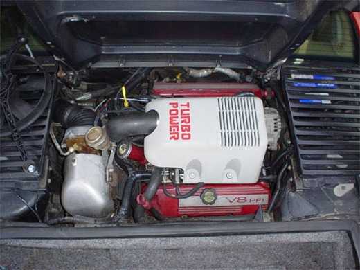

Did some more cleaning up today. Here is a pic of the new engine cover. Original or what!!!
mrfixit58
Posts: 3330
From: Seffner, Fl, USA
Registered: Jul 99
Total ratings: 113
Report this Post04-30-2003 07:51 AM Click Here to See the Profile for mrfixit58Send a Private Message to mrfixit58Direct Link to This Post
Looking good guys. The cover is very unique. Is it from a Chrysler?

Put a blow-off valve on it today. It has an interesting new sound, a swish when you let off the gas after accelerating. Makes you want to look around for the truck who's releasing the airbrake. Also new sig test.

Well the car has come a long way. Beck and I were down at Rockcrawls for a bit and made some changes after a few road tests. We come up with a few area's to address. The first was how quick the ecm reponds to knock, Jon was able to make changes to how quick the ecm reponds to pre ignition and how fast it re applies the timing. I had the ecm attacking or should I say hacking too fast at the timing so he dulled it down a bit Next after some road test we found it has great low end and much improved mid range with only a mild change to top end with the turbo (compared to what we hoped for). So something is not right yet, We removed the exhaust from Becks car after the Turbo, and gave it a few revs, right away we could notice a differance in the turbo's responce even reving the engine under no load. So Jon made up some new exhaust and we were off the the road test. Well now the waste gate that use to control the boost to 5 psi has let the turbo spool up to 15 psi-not good. We had to re work the waste gate's ability to dump air. We came up with cure, and now has fully adjustable linkages. Now it is ready for the track. But rain has canceled our test and tune nights twice for us at the local drag strip. SOON.

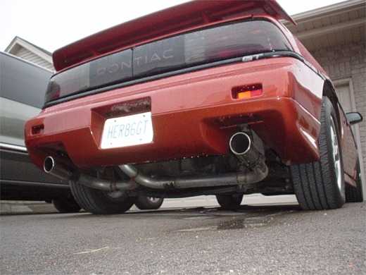

The new exhaust pic
Pete

Well, the engine is out of the car for a custom rebuild. Port, polish, high lift cam, roller rockers etc. Tranny is in for an overhaul too (something about drag racing the car every weekend)
Got some more info on different routing of the exhaust and the car should be running 12's next season.
I don't want the car doing under 12 seconds because according to NHRA racing rules, anything faster than 11.999 needs a roll cage and I'm not authorizing one for my car. The cars are small enough as it is let alone having to crawl over a roll bar to get in. It's still a show car and all.
PBJ
Posts: 4167
From: London, On., Canada
Total ratings: 147
Report this Post10-02-2003 07:10 PM Click Here to See the Profile for PBJSend a Private Message to PBJDirect Link to This Post
Some pics, if these ever help others, of the exhaust routing.
