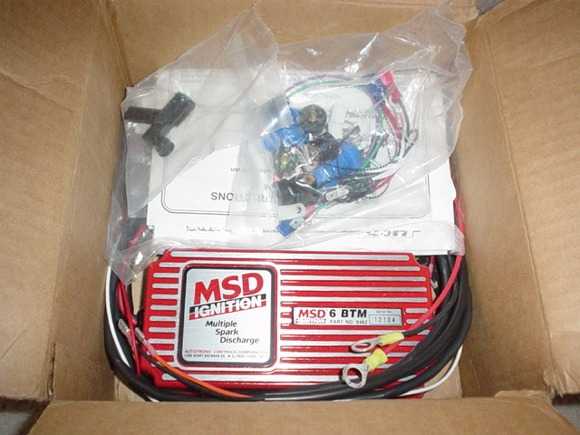

Her86GT
Posts: 1173
From: Ontario, Canada
Total ratings: 53
Report this Post02-26-2003 04:08 PM Click Here to See the Profile for Her86GTClick Here to visit Her86GT's HomePageSend a Private Message to Her86GTDirect Link to This Post
Got this in the mail today I know Pete is going to be right on it when he comes home from work too! I'll post pics of the progress.
