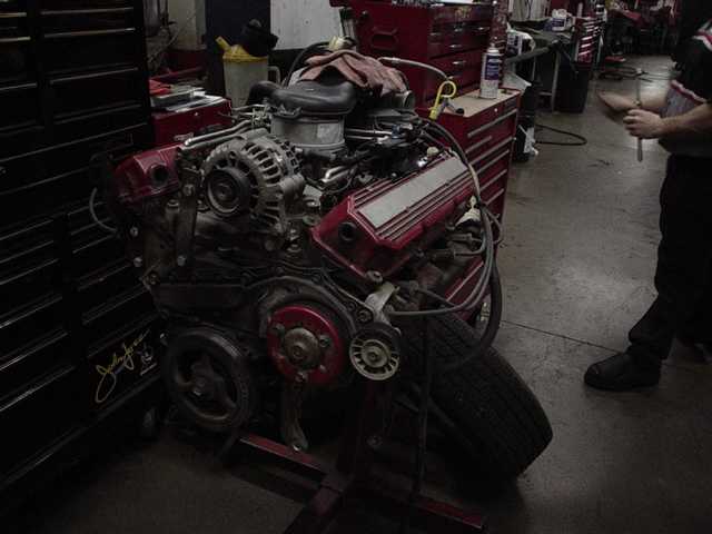

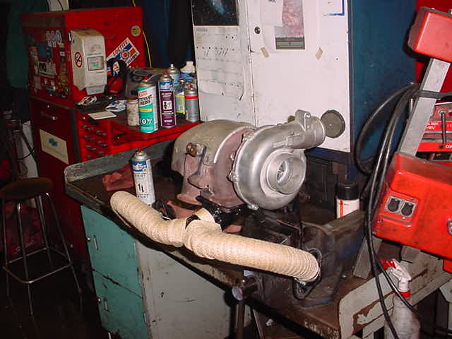

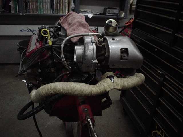

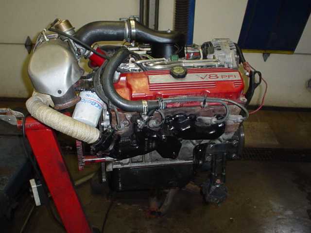

Well I caught a spy pic of the turbo project PBJ is up to. Being that my car is the guinea pig, I have to keep a close eye on this one
All I'm allowed to comment on is: 5psi boost, knock sensor, water injected when under boost and a new Rockcrawl prom. Oh and a rebuilt 4t60 with a shift kit. I'm told that I might need wheelie bars

So is that a 'spare' 4.9? Can't wait to try and dig the details outta Pete on this one

Report this Post11-06-2002 10:28 PM Click Here to See the Profile for Her86GTClick Here to visit Her86GT's HomePageSend a Private Message to Her86GTDirect Link to This Post

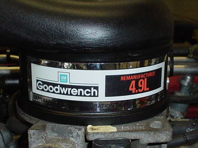

That is my actual engine believe-it-or-not! Looks kinda dirty and lonely without the rest of the car to make it look good.
Well, I now call my engine the "Frankenstein". It's had all sorts of weird plumbing done to it. Soon, it won't be recognizable. . .Pete's not releasing any details until he's done the prototype and the car has it's first official test drive. But trust me, there will be pics when I can get 'em

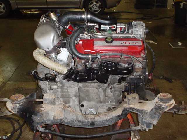

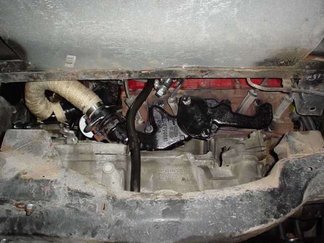

Report this Post11-11-2002 07:59 PM Click Here to See the Profile for Her86GTClick Here to visit Her86GT's HomePageSend a Private Message to Her86GTDirect Link to This Post

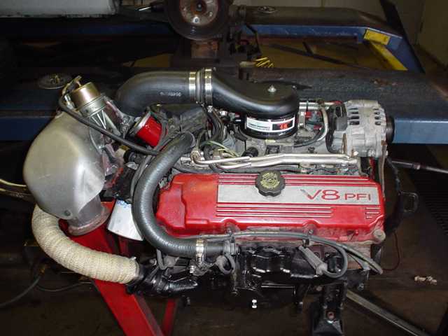

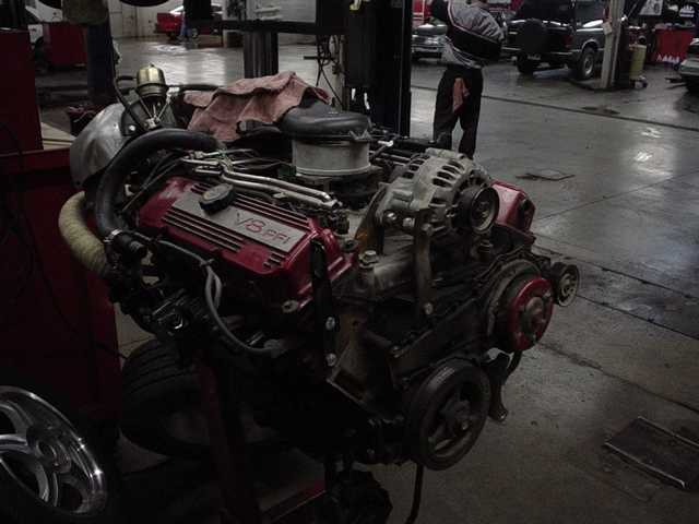

Got some more pics of the progress.

KRMFiero
2711 posts
Member since Sep 2000
Makes me wish I didnt sell my caddy fiero stuff.... looks great, cant wait to see it when its done!!

Sweet, nice work. What's the gear ratio on the th440 your useing?

Becky...Pete!
As soon as your done make a thread with absolutley ALL of the info on it
~Which Turbo
~How it was done
~Estamated power (torque)
~How much $$$ (if you don't mind)
I am in AWE over that 4.9!

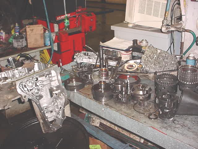

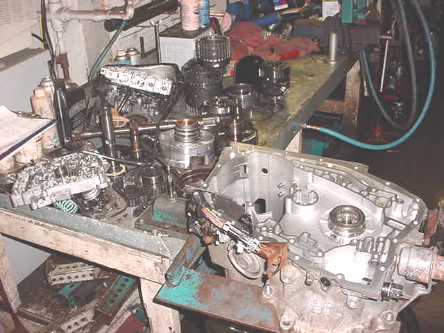

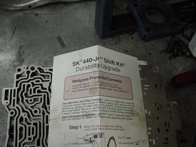

Here is the tranny all torn apart being rebuilt with new seals and a shift kit. The gears ratios are 3.33 final drive with 35/35 sprockets.

Sweet,my th440 also has 3:33's no shift kit tho , It will still have better take off then the stock 3spd.

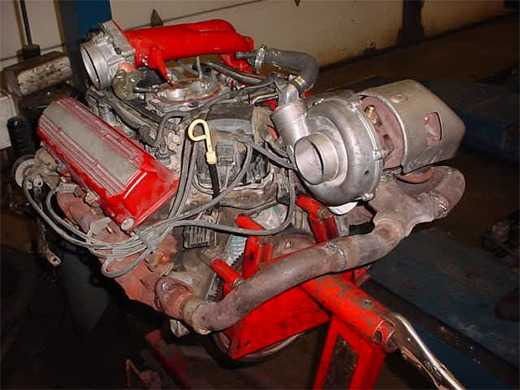

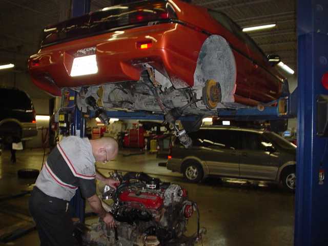

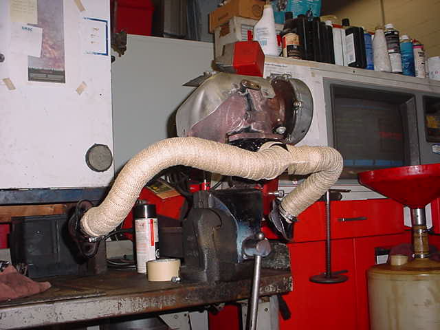

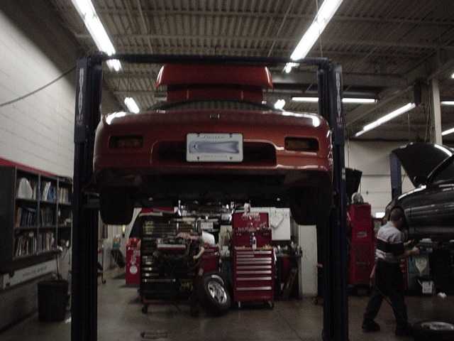

Report this Post11-23-2002 04:23 PM Click Here to See the Profile for Her86GTClick Here to visit Her86GT's HomePageSend a Private Message to Her86GTDirect Link to This Post

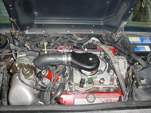

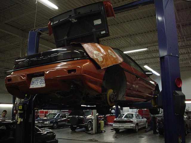

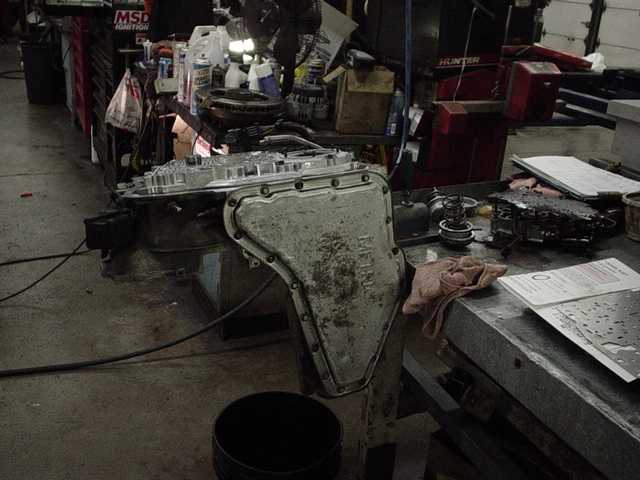

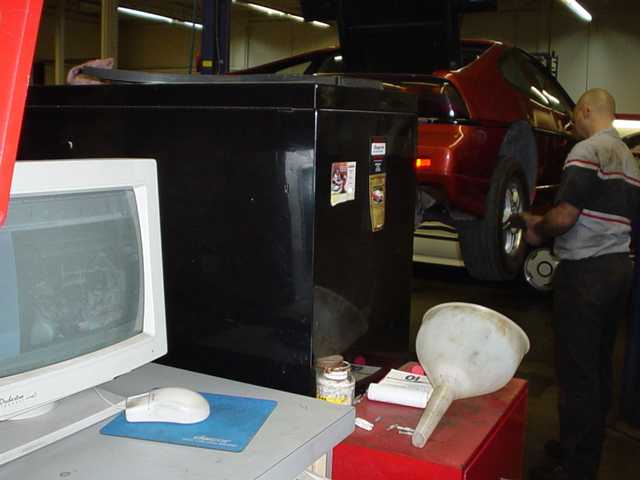

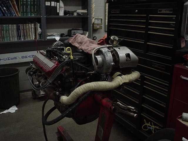

Got a new digital camera so I was able to get some more spy pics of my turbo-to-be. I haven't had a chance to adjust the setting on the camera but here they are:
Caught PBJ while he was working - and it's not my car! I guess you don't make money working on your own car

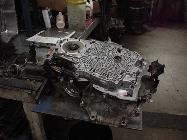

Some more of the tranny. It's almost done finally!

Looks like a neat setup but if the stock 9:1 pistons are used then modest boost levels are adviseable.
Turbocharging the 4.9L is going into unknown territory. I don't believe that anyone on this forum knows how this engine will respond to boost. No doubt that it will produce more horsepower and faster acceleration so the question of whether or not this engine design is durable enough to provide long term reliability under boost will be answered shortly. Don't know of anyone who has programmed the Caddy ECM to work with a 2 BAR MAP and a turbo. I'm not certain that it can be done The Chevy 747 or 749 ECM might be a good choice.

Dennis glad to see your advice but I have a 4.5 and a 4.9 that I have been working withover the last 8 months with very respectable durability after a lot of punishment.The 4.5 I am using a turbo from a 86 300ZX Nissan at 8lbs of boost and with out a problem all I did was to change the head gasket and replace the head bolts with ARP brands and torqued them at 10lbs more than stock I am using a Holley 500 cfm 2 barrel carb with the turbo going into a carb and so far it has stood up to my abuse.Many people consider the 4.5 and 4.9 engines as a softie but if properly modified you can have a strong running 2800 pound plastic car.
The car has never run with the Caddy ecm. It currently uses the 730 but PBJ and Rockcrawl together have rewired and promed it for a 749. Don't worry, there has been hours of thought put into this. But yes, the question is HOW WILL IT PERFORM. This is the unknown - but that's what makes this so much fun! ! !

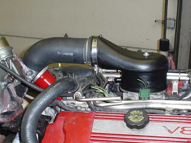

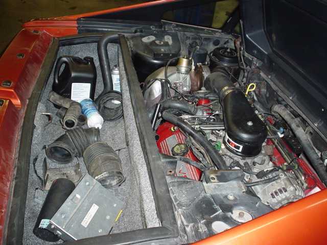

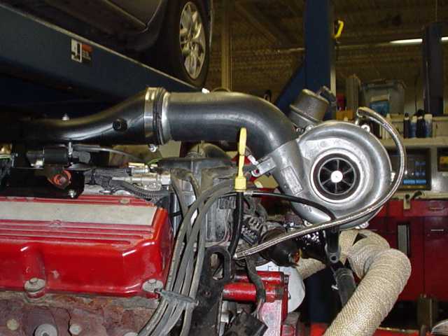

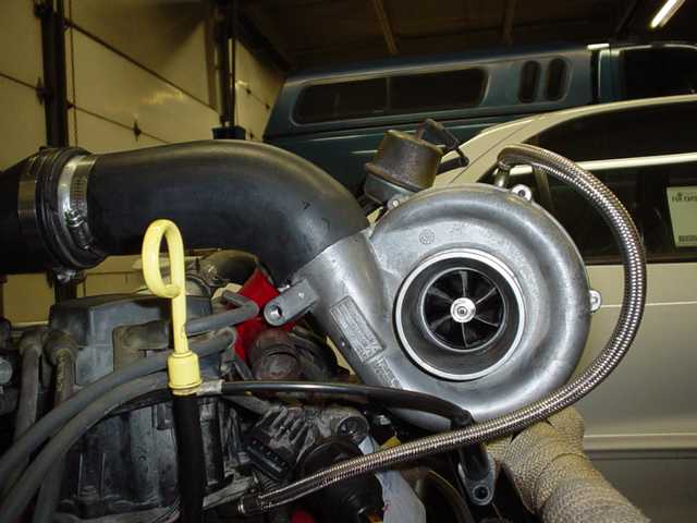

Just some more pics I took today:
I put this sticker on for a bit of humour:
[This message has been edited by Her86GT (edited 11-25-2002).]

Say goodbye to easy oil filter changes, eh? And you still gotta squeeze a downpipe in there! I can't wait to get that thing on the Dyno for tuning, and again in may for some HP runs.

I just felt like putting up two more pics:
Her86GT
Posts: 1173
From: Ontario, Canada
Total ratings: 53
Report this Post11-26-2002 06:49 PM Click Here to See the Profile for Her86GTClick Here to visit Her86GT's HomePageSend a Private Message to Her86GTDirect Link to This Post
FieroMonkey
Posts: 3295
From: poway,CA,USA
Registered: Nov 2002
Total ratings: 114
Report this Post11-26-2002 08:00 PM Click Here to See the Profile for FieroMonkeySend a Private Message to FieroMonkeyDirect Link to This Post
That fit is so tight i bet it could hole water
***is just jealous because he still has his 2.8***
Monkey
"No matter where I go...There's my car"
*Just arrived...84 Indy 4-spd
87 T-Top GT 2.8/5-spd
87 Hardtop GT 2.8/5-spd
97 Trans-AM WS6 6-spd
91 V8 Monster Miata 5spd
69 Mustang Coupe 302 4spd
Added 2 short movies
members.cox.net/lothe/
stevenrossi
Posts: 2232
From: Toronto, Ontario
Total ratings: 126
Report this Post11-26-2002 08:16 PM Click Here to See the Profile for stevenrossiSend a Private Message to stevenrossiDirect Link to This Post
Well it looks pretty done...so lets get a test drive a.s.a.p!
I believe i speak on behalf of all 6100 people on this forum when i say GIVE US SOME INFO
Lookin great...tell pete that i say he's doin an AWESOME job!
Steven Rossi
2M4 Cadero Converted GT

Well to be honest, it just got put in tonight. I'm actually posting this from the computer at his work (where his is still working on it). There is still a long way to go: rewiring the ecm into the car, coolant plumbing, exhaust, water injection system. . .the easy part is over. Getting it to run properly is the harder part. . .I mean the fun part
rockcrawl
Posts: 2528
From: Lehigh Valley, PA
Registered: Jul 2000
Total ratings: 96
Report this Post11-26-2002 09:04 PM Click Here to See the Profile for rockcrawlClick Here to visit rockcrawl's HomePageSend a Private Message to rockcrawlDirect Link to This Post
I mean the fun part
FUN!? Just you wait. I remember how squeamish you were the first time that thing got held wide open on a dyno. You could barely watch without crying. I'll be doing that several times over! Wow, you're right, this is going to be fun!

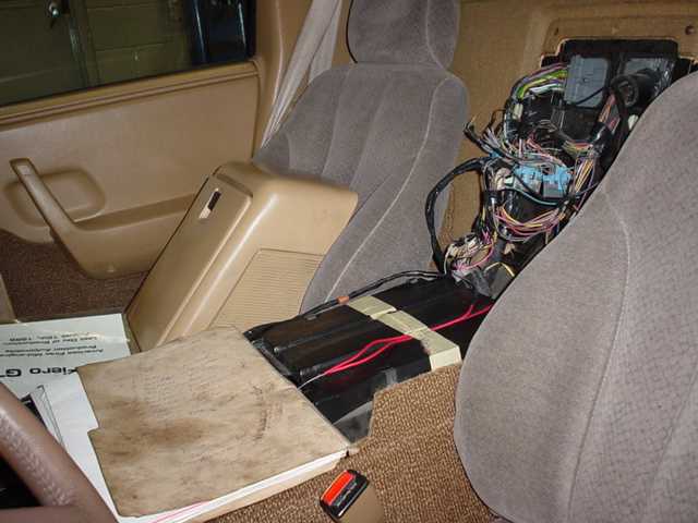

Her86GT
Posts: 1173
Total ratings: 53
Report this Post11-26-2002 09:38 PM Click Here to See the Profile for Her86GTClick Here to visit Her86GT's HomePageSend a Private Message to Her86GTDirect Link to This Post
I love my new camera
The folder in the pic holds all the info on my car - to loose that would mean hours of research.
Her86GT
Posts: 1173
Total ratings: 53
Report this Post11-26-2002 10:15 PM Click Here to See the Profile for Her86GTClick Here to visit Her86GT's HomePageSend a Private Message to Her86GTDirect Link to This Post
Her86GT
1173 posts
Member since May 2001
Okay. . I know I'll be freakin'...but at least I'm going to be there every second 'cause I don't want to miss a thing and yes, I'll probably cover my ears again
