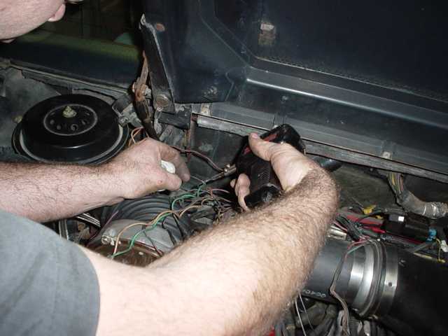

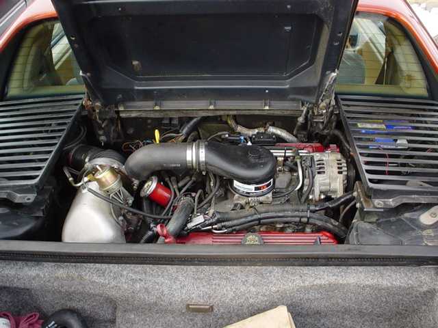

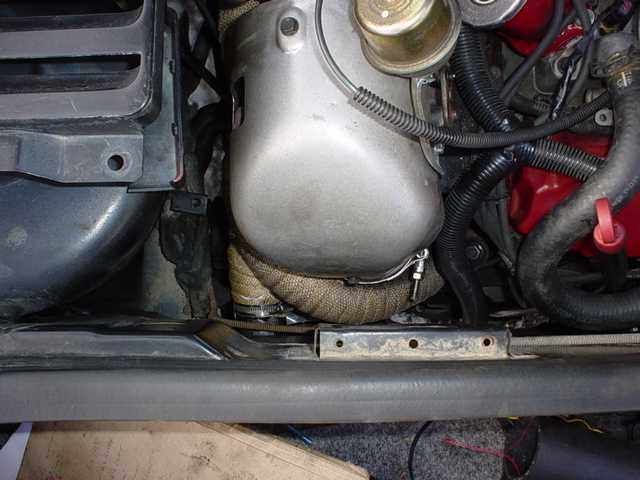

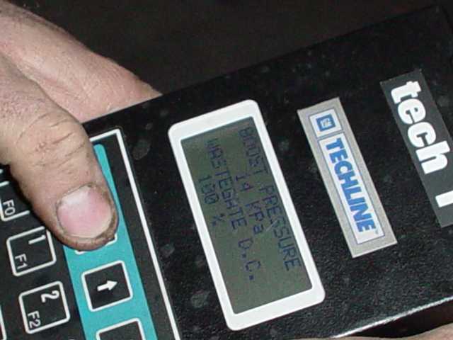

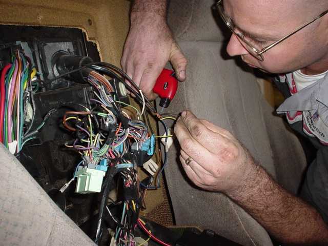

Well. . .the car IS RUNNING! Mind you, it is too early to tell what exactly the car is able to do. There are a few bugs to get out but it should be ready to go shortly.
Here are some more pics of tonights progress:
Here PBJ is wiring in the tranny
Getting ready to wire in the ECM
Making sure they're in there good
Success! Getting data from the 749 ECM with the TECH 1
One of the inital readings.

PBJ, howd you get boost pressure? Closest thing to that on mine Jon and I could get on his diagnostic was map voltage.

Pete is using a Syclone ECM, and a turbo that makes boost.

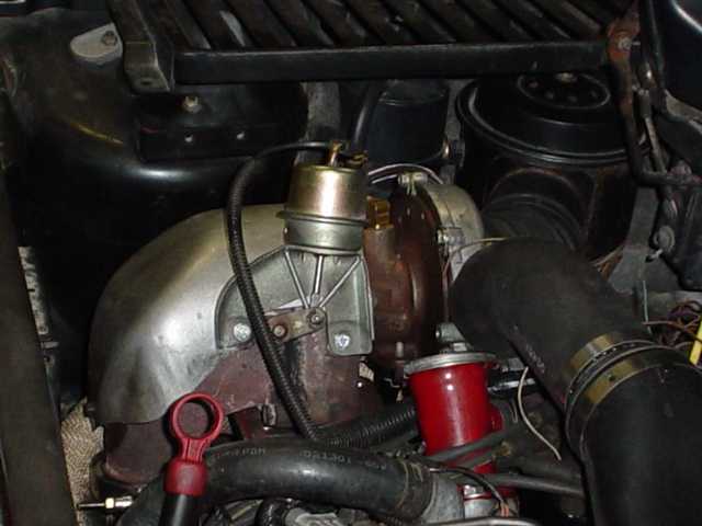

I must say that turbo 4.9L is one good looking setup. Quite a nice achievement. Can't wait to hear about the results. The low end performance should be unbelievable.
Boosting that engine to 8 psi with 9:1 compression is a very agressive route to power. I would estimate that the timing curve would need to incorporate at least 2* of retard per pound of boost pressure.
If the engine prooves to hold up reliably, you will have opened the door for others to do 4.9L turbo build ups.
What has made me shy away from this swap are my questions on engine durability under boost and being able to locate a suitably sized turbo in the narrow confines of the Fiero engine compartment.
IMO if you are using a turbo from a Volvo it will proove to be too small. A Garrett/AiResearch T4 or similar size turbo will be needed to supply enough air for a 4.9L (300 cubes) or a 4.5L (278 cubes)engine. The largest T3 has a compressor A/R of .83 and may fall short. A T4 with a compressor A/R of around .70 would be what this engine needs but the larger T4 turbo housing size would also be a difficult fit.
Good luck on the project. It must truly be a labor of love.

Becky, you need to get that stock airbox out of there. Good looking build up, can't wait to see it next year at the Grand Bend meets.

Syclone ECM. Ok, that makes sense.
I'm told if that's removed, I will get a droan because the stock air box has a water separator that cuts down on intake droan. As for turbo size, let's just say it moves 5L Mustangs just fine.

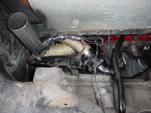

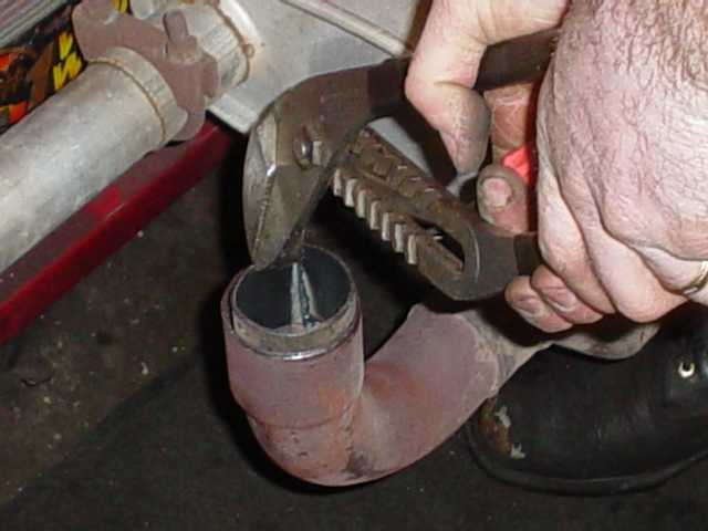

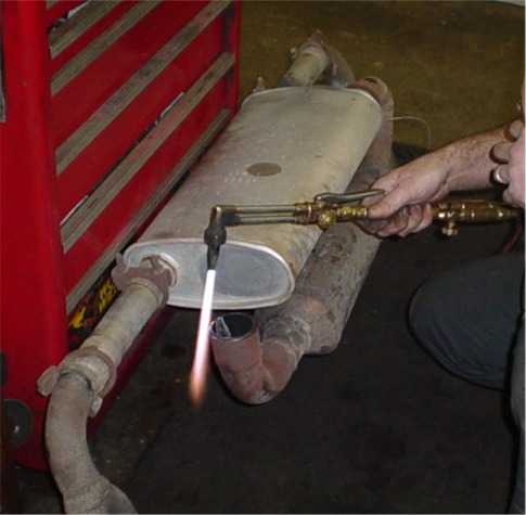

Well here are some more pics. It's nearing the end of the project and we should have some more to write about soon.
PBJ trying to get out a piece of exhaust pipe so he can join it to the car.
Here is what it looks like now.
Me with my baby.

Had my car going today with the new exhaust that PBJ did up and it's even MORE quiet than before! I guess the turbo has muffled some of the sound. And my car was quiet before! I even got to feel the air come out of the turbo - now I know why people call them a hair dryer.
