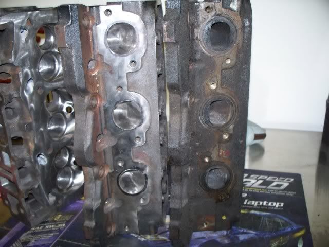

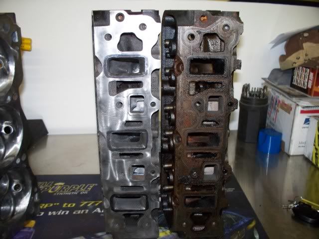

whodeanie
3819 posts
Member since Jan 2008
heads are now ported and will be going to the shop for hardened seats and new guids once the valves get here some time in the next day or so.
once that is done we will finish the ports and off to be coated.
here are some pics of the heads next to a stock set.
D.
