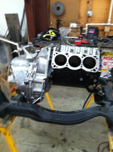

some of you may folow my shop thread and have seen some pics of the 3800 block that I am building but I figured it deserved its own thread.
I am building this motor as bulit proof as I can and in doing so I am going way over the top with it because I want it to last as a DD as well as have over 700 HP.
so this is what I have done. I started with a 99 GXP 3800 motor and tore it all the way down to just the block. it will be getting all new parts for the build.
once the block was srtiped I pollished the valley as well as drilled return oil holes in it. I re moved all the plugs and bearings to get it ready for the machine shop.
the crank has been turned and I am now waiting for the rods and pistons so I can take it to them. the pistons are Diamond forged coated at 20 over stock.
I will be using the powdered metal rods with ARP bolts and total seal rings. the balance shaft will no longer be used and the engine will be ballanced.
once the machine shop is done with it I will be taking the whole motor over to get it Cryoed and some parts will be RIM pollished and others will be coated.
much more will be done to this motor as well so I will let you know as we do them with pictures but for now this is what I have for the motor now. as well as some of the things that have already been done.
the block.....
Pollished the valley and drilled return oil holes also working on smoothing out the cast marks to give it a nice finished look.
I already have ARP main studs, head studs, rod bolts, reuseable rocker bolts and SS header bolts
new ZZP oil pump and Dbl. roller chain
all bearings are tri metal and are being sent to Swaintech to be coated
all new metal gaskets for the motor as well as 4 layer Cometic head gaskets.
the cam will be custom made
the heads are being ported and pollished now and once done will go the the machine shop for new seats and guids for the new Manley HD over sized valves. I will be using roller rockers and I am not sure on springs yet I will have to see what the cam will need first.

Just curious as to what drove your decision to use powdered metal connecting rods rather than a forged steel version?
La fiera
Posts: 2298
From: Mooresville, NC
Registered: Jun 2008
Report this Post11-27-2011 01:18 PM Click Here to See the Profile for La fieraSend a Private Message to La fieraDirect Link to This Post
In case of a catastrophic failure, the powdered rods will brake in such a way that the damage caused by the broken rod will be minimal. They are rated up to 500hp. Crio treatment will improve their integrity and in case they brake, carnage will still be very minimal compared to a forge steel rod failure. Very good choice!!
Careful putting valves in, the seats are a major pain to deal with and can not be cut back to the point it removes the hardnening. Roller rockers decrease horsepower in every situation I and zzp have run across. You are most likely not going to be running anything that would make a stock rocker not work so I wouldnt worry about it. Custom rockers are only going to be requried to run custom lifters that would require special installation procedures.
custom 8 grove smooth flow pulleys
This is a huge waste of time... You dont need 8rib for a supercharger setup with a stock pulley on it.
airtech fuel pump
In tank? Sump stock tank? Fuel cell? What fuel are you running?
and oh yea I almost forgot a T76 turbo and full intercooler setup.
Big turbo
Yes it will be twin charged but before you all start trying to talk me out of it let me just say this I am building it for the WOW factor for shows and it may not stay in this form for long.
this is my shop car and things will always chainge on it. I want to use it to test setups and this will be the first one.
the idea for this one will be to use the supercharger to spool the turbo and let the turbo take over. the bypass is being custom worked to handle this.
A custom bypass setup will most likely not be worth your time.. Make the stock one open under turbo boost, but remember plenty of air will be going through the supercharger as well.
I will not be running more than 16 pounds of total boost.
Wut? You have a 1000whp turbo, that will do just fine up to 30psi. I struggle to make much more than 450whp on 16psi without a supercharger meddling with the pressure ratio.
this motor will be mated to an F40 6 speed that will also be cryoed and RIM as well as an LSD
LSDs are completely useless in a fiero. Spend your money on the clutch and leave the transmission alone.
you never know this may end up being a twin turbo 1000 HP set up one day
you need 2 1000whp turbos to make 1000whp or something?

thanks for the info on the rods, I will look into it. I did look at forged rods but at the cost point it would stall out the build at 1800.00 for the set.
I am not woried about blowing things up because I do have spair parts but the goal is to keep it together as long as I can and find the weak points as we go. as far as HP like I said it will be as much as we can get out of each setup and then chainge to another and see what we get. the motor its self I hope to only build once. the S2 is a strong block that was way over built from the factory and we are just adding to it to push it to the limit. but keep in mind this will not be realy raced it is just a shop demo car that will be used for testing the setups that we do. I would rather blow up my car and make the others last. I have no real goals in mind for this uther than taking it as far as we can and posting up the results here for others.
I will not get into a debate about what works and what does not unless I have proof that it does or does not work from our testing. this motor is being built and tested by some of the best engine builders in the south east as a test bed for power vs reliability. keep in mind that we are looking for more than 3 HP per CI and not that long ago it was unheard of.
I do talk to ZZP almost every week as well as others in the field my choices on what parts to use are not just a shot in the dark they come with a lot of research to find what works best for others as well.
I hope you enjoy the thread but lets keep it fun.
thanks, D.

I am only going with the Cryo and RIM because a local company does it and they are friends of mine. they want to show their products to my customers as well as all of you here on the forum. but it will increase the life of the engine and trans as well as make it stronger. I could run it with no oil for up to 30 without fail ( not that I would ever want to )
as far as rods I have only found one company that has them and they are 1800 a set. everyone I have talked to said they are not going to make them because not enough demand for them.
with the S3 powdered rods they will hold up to 700 HP and with the Cryo and RIM they would hold in the neighborhood of 1000 HP and that would be good enough for me unless you can show me a company and a part # for a forged rod for this set up for under 800 I guess I will have to stick with this setup.
D.
