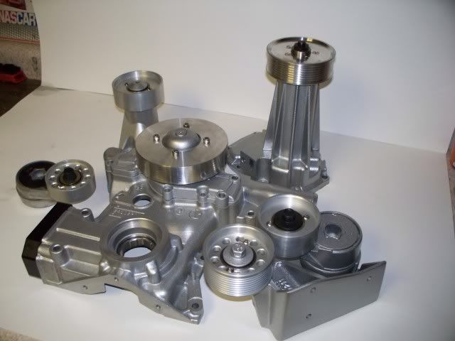

as far as the pictures of the heads they are not done yet in those pics he still had about 1/4" to go on the ports still he was working on the floor of the port. the end result will be a D shaped port. this is not my first rodeo, I have done this a few times before.
on to the good stuff..... I got the new pulleys yesterday and they look fantastic. abd because we also work on LS engines as well I may have found a way to build something very cool with this motor.
I will keep it to myself for now but once I find out if it will work I will share. it may be something that we can do on others as well.

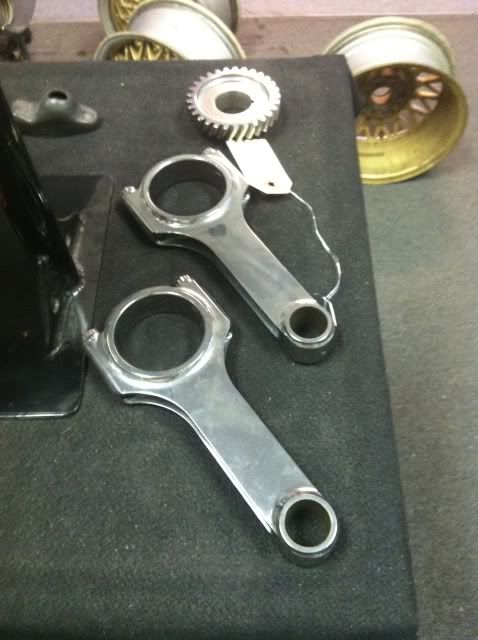

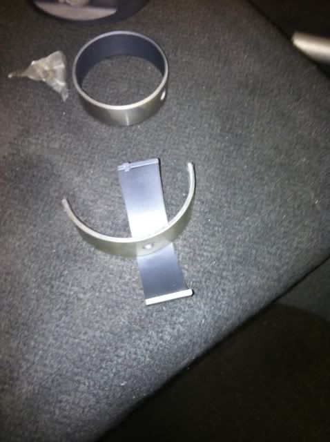

Montage, thanks for the Cryo info.

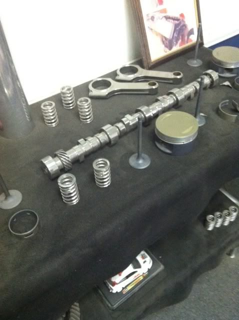

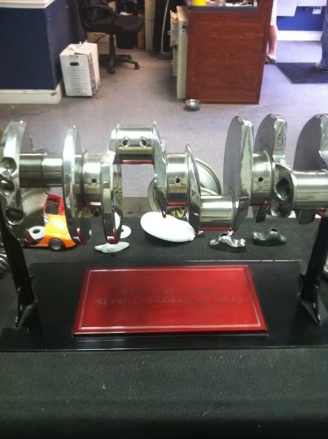

This is my thoughts behind my desision to do the Cryo and coatings, one of the Nascar teams I can not say what one had a motor Cryoed and coated and then ran the motor with no fluids for 45 min. and then toar it down to find no damage and it was also tested with fluids and it did gain HP over a non coated motor due to less friction.
this process is normaly expencive but the owner of the place is giving me a great deal on it for testing it on a street car.

so I got the new bearings and Dbl. roller timing set and droped them off at the cryo shop this morning. I plan to have the timing set cryo and RIM and the bearings will all be coated with the oil coat.
I can not wait to get the rest of the parts and start building the motor.

the F40 will be tested to its limit that is for sure

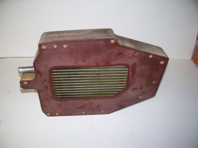

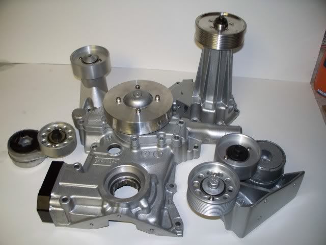

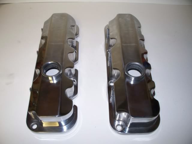

here are a few pics of the parts I already have for the build. some are at the coater still.
D.
I know some of you might say it will not fit but I will work it out.
these are the new pullys we offer.

Report this Post12-06-2011 11:04 AM Click Here to See the Profile for 1fatcatSend a Private Message to 1fatcatDirect Link to This Post
I like your pullies. Very nice! But that blower pulley looks pretty big?

Report this Post12-06-2011 11:55 AM Click Here to See the Profile for nosracSend a Private Message to nosracDirect Link to This Post
Those pullies are da $h!t. I love purdy things.
Big pulley to keep the M90 heat to a minimum. The M90 is being used to compensate for Turbo lag before the big spool up.
It is meant to give the ultimate awe factor and win shows because from a performance standpoint; once the Turbo spools, it is pretty much irrelevant.

"these are the new pullys we offer."
http://www.smoothflowpulleys.com/3800_MPS.html

Those pullies sure do..To bad once the motor is installed they cant be seen...But they look good for the build up.....

U going to use the IC pictured along with an external IC?
Yep, that is the plan.
Yes they are smooth flow pulleys we will be selling them on our site at the same price.
the Super charger pulley is a 3.8 because of the turbo setup.
I wanted to do that too with the Stattama intake on my upcomming Turbo. I thought double the cooling = 1/4 more Powah...
However, as we know I am going a different route now.

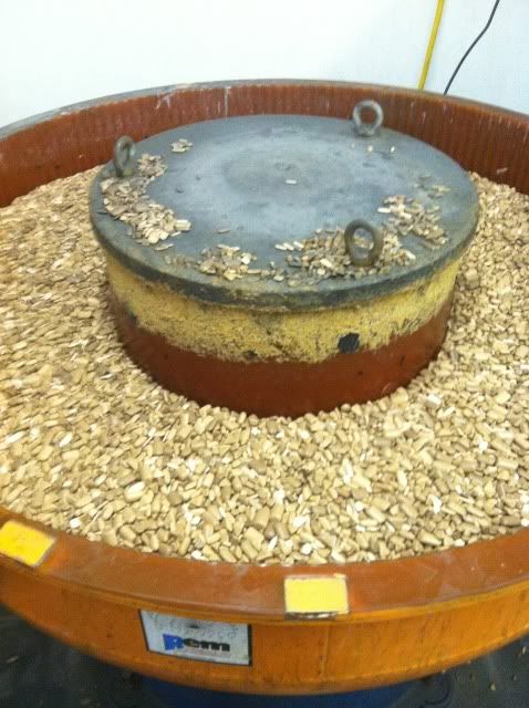

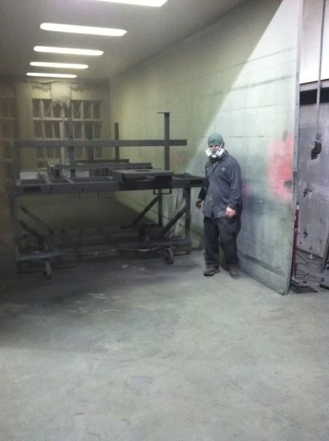

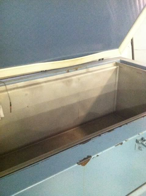

So, I went to pick up the headers for the yellow car today and got a few pics of what was in store for my motor.
first the cryo.
then the REM
and the coating center. they can fit a bus in the booth.
here is what some of the finished product will look like.
