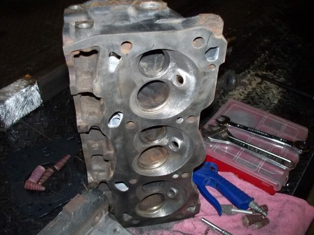

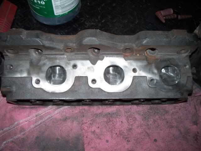

So, I will be posting up new pics today and I have gotten more done on it since last night.
the lower intake is now ported to go with the intercooler and I will be welding up the water holes as well as the EGR hole on it then it will be worked to port match the gaskets on the intake side of the heads. the heads are being ported now and will also be getting a lot more work as we go.
some have asked about the trans, Clutch and axles so here goes.
the trans is going to be Cryoed, RIM polish as well and the housing will be coated inside and out this will make it stronger and last a long time. I will also be installing an LSD.
the clutch will be from Spec it will be custom made for this setup to handle the power. the axles are being custom made by a local company that makes all of the axles for us. they build them for everything from stock to full race sets that have way more power than I will.
most all the parts have been chosen for this build already it is not just a wish list and I have most all of them now with the exception of the pistons, rods, and cam.
the cam is being done for me as a custom grind and the pistons are from Diamond the only part I have not set on are the rods.

I know that a lot of the stock parts are plenty strong enough to handle a lot of power but I am not doing a quick budget build here.
Meh. You are confusing spending money with things being better.....
http://i209.photobucket.com/albums/bb310/whodeanie70/008-14.jpg
If someone gave me those heads to put on a motor, I would scrap them and put stock ones on. You lost the dshape on the exhaust ports, and overall they are uneven looking. The valve seats also look like stock ones that have been cut....
Custom outers or are you running a new outer knuckle?
As said before, this is a great place to decrease complication and increase your wallet. A LSD will never function as a LSD unless you break an axle and want to load it on the trailer under power.
It would also be cheaper to just get a ST5 cam, instead of doing a custom grind.
