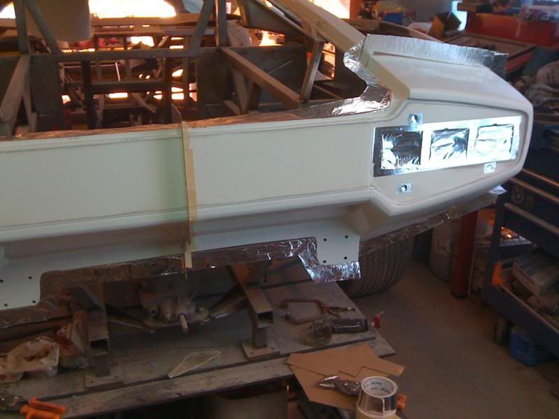

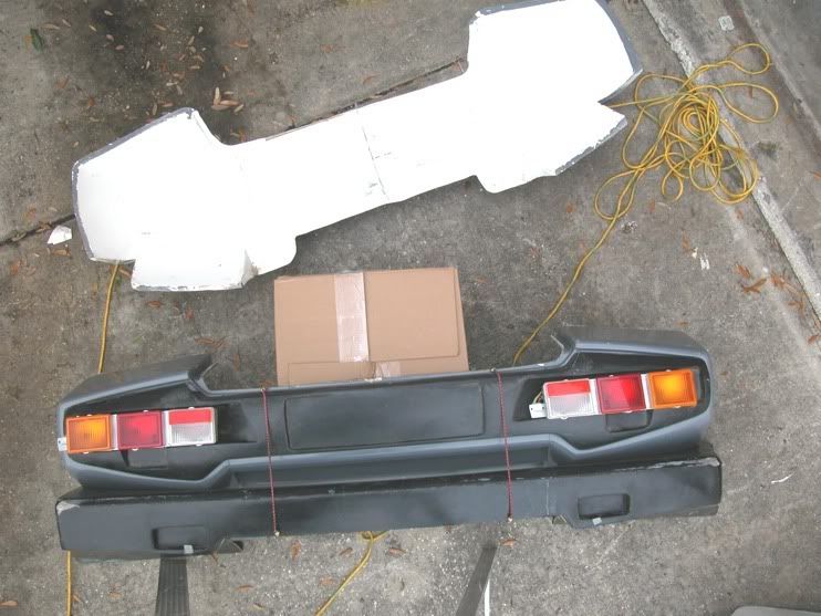

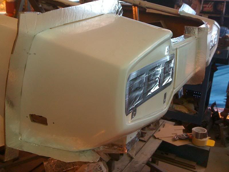

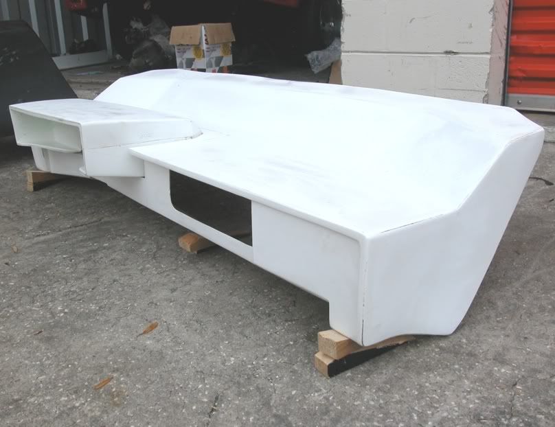

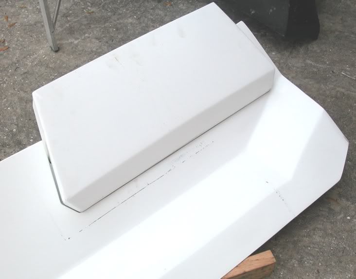

http://www.cableshift.com/A...000/audi%20page.html Cliffscustoms also made me a quick 2 part mold of the rear end of the car to fix mine....lol, I guess I really am totally redoing the body, but I want a nice car when finished, and this will allow me to do the rear bumper correctly. Cliff is currently working on the 25th Anniversary style Dash I sent him now based off my measurements taken from Mark's car, making the necessary corrections to it, then molding it, so if any 25th countach guys out there need a dash and pod/ gauge face, correct to the later QV and Anniversary model, let me know. Now then, as everyone knows, I'm going with a BMW V12 in my build, so came up with the artwork for cutting the detail atop the intake covers recently, pic shown. So now I guess I get to save for the engine so that I can mount it all up and see what needs to be cut in the firewall...Saving......

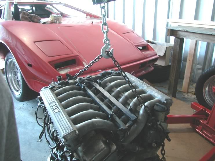

hoping to have my rear BMW axles by the 30th...Got an M70 V12 due me, just gotta get it up here

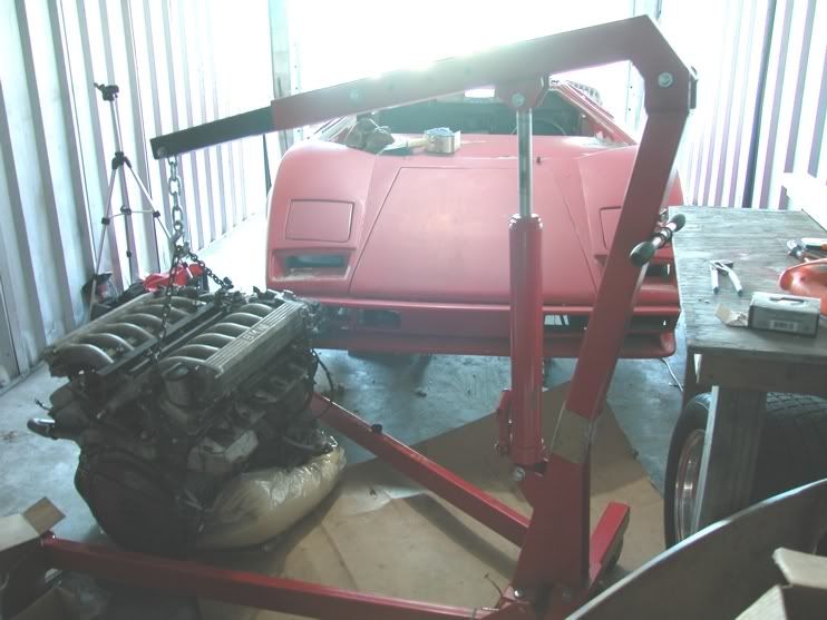

It's been a while but things are progressing, though slowly. I did receive my rear BMW 750il axles as stated. I also traded some part making services for a M70 V12 with 75k on it. The trick was to get it up here from Miami. though a van ride to Merrit Island to sitting in a garage till I could arrange pickup to bring it over to the unit where the car, was a toughy. My buddy Mark came through along with his son to finally get the engine over to me. Now it's a process of attaching the transmission to the rear axles and getting the proper measurements to get the axles welded to the CV joints. I also need to determine how far into the Firewall I will need to go for the V12 to fit properly. I have a few new ( well new to me, lol) goodies. I have 2 used oem Countach Vitaloni electric mirrors, the switch to adjust both of them. I also have an original Countach metal trumpet dual air horn by Fiamm, while it's in need of clean up and re-painting, it's the real deal. My latest acquired items include oem fiberglass and aluminum tunnels for the quarter light areas, oem internal door lock brackets, both left and right, and finally, a set of window regulators, actuators with electric motors, cables and pulleys. Anyway, I'll be trying to update here more often now.
Cheers,

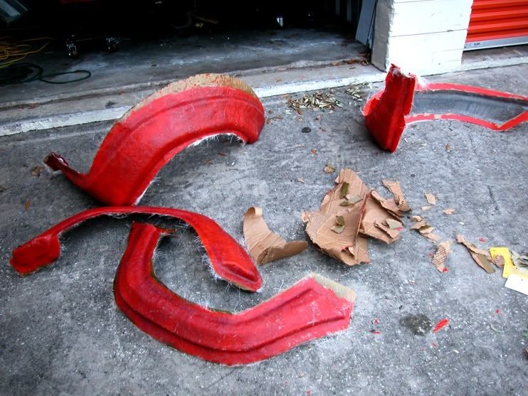

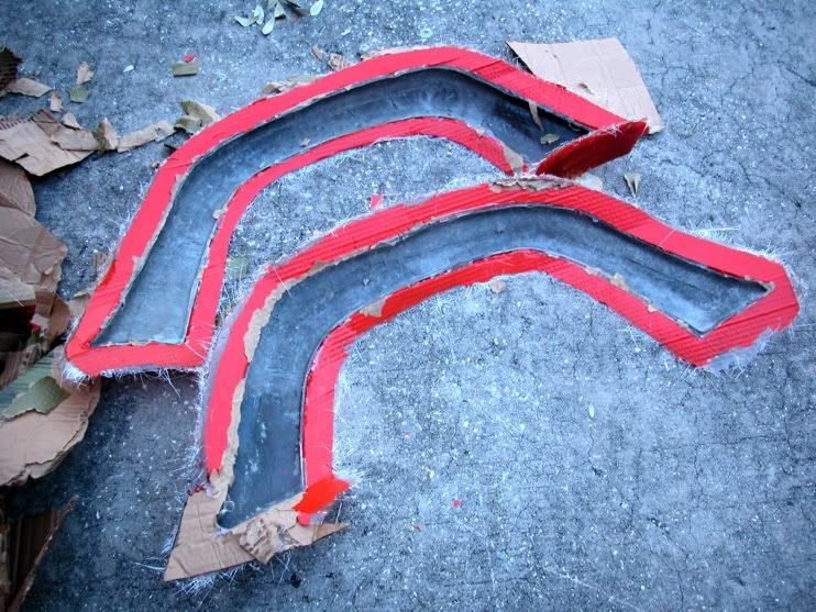

yeah the aluminum tape was for the mold procedure.. ok, working on new pics now

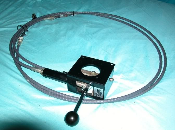

Will, are you sure that shifter will work with your transmissiom?
That link you gave for cable shift shows the shifter mounted to an Audi 016 5-speed which uses the shifter shaft that comes out of the left side of the transmission. In the pic you posted from the rear of your car it looks like you have an Audi transmission with the shift shaft that comes out of the back of the transmission, which I think is an 012.

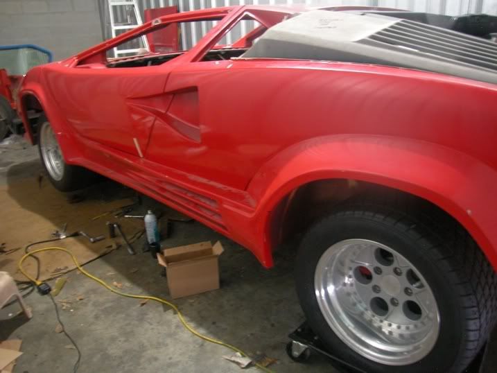

Stan came over this evening and we got to work on the car a little and he got the tools he needed back . We bolted back up the cradle and put the rear wheels on so i can roll it to get it on a flatbed. A lot happening on this build, and a new place to store it shortly, so quite excited by this... I did finally get my V12 and am in the process of purchasing the aftermarket engine management system as well as throttle bodies and various other parts to make this V12 run. I sent off my dash a few weeks ago to be modded into a 25th style per my measurements of Mark's car and these will be available for those that need them shortly. The dash and dash pod were molded this week and just waiting to pop the first casting, then I'll show pics. It will also have the glove box and a cover too. I'm going to have my wing molded as it's the smaller wing for the later years including the 25th. I finally popped out the molds of the wheel flairs, and though a little repair is necessary, they will work fine for reproducing a few sets. I have my oem window regulators now as well as tunnel parts for the quarter lights.The big news is we may soon have a place in states( Florida) that can make the curved glass for these cars, just working out the details and making templates, though it's safety glass.
Will

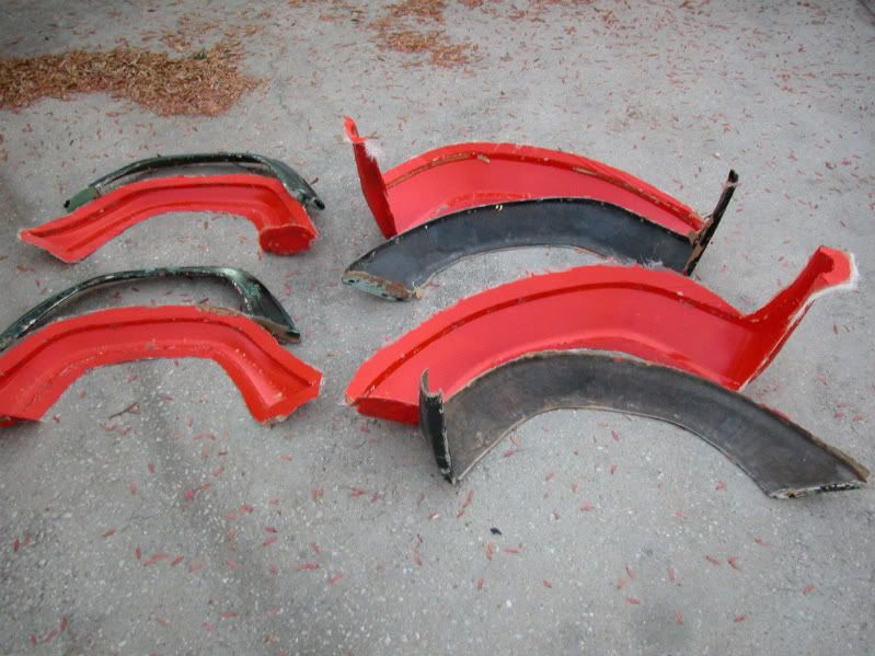

flair molds...........

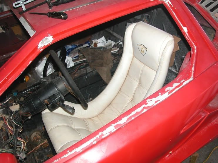

and a pair of old seats form of all things, the Elegant Motors Show car... The seats look really cool, though not 89 style, I really like em, and make a great TV watching seat for now.
I have a pair of 89 style seats i would trade you. They even make great TV-watching seats!
