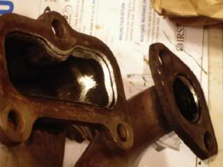

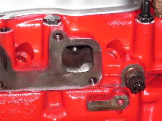

I started with a tired fuel pump with 6 psi and loose piston rings. I will tell you the head was opened 1/8" on 1 side and 1/16" on all other sides for the intake and 1/8" on 3 sides for the exhaust side. I went ahead and bit into the big hunk of metal that is there. see below
The intake is now 2" rather than the 1 5/8" to fit the Holley TBI and I eased the transition to the runners.
I also eased the flow in the exhaust this way, see below
I can tell some of this stuff was useful because it really can rev up to 4000 rpm with no real effort. It flows good enough I think. Now if the engine can take a load... well I think it can go WAY more than people prefer to think. As for comparing to a 2.8 V6 60, I'd say no way if the 6 were in top shape but MOST 6ers are just kept so they keep going....Well that was my idea behind the comparison.
