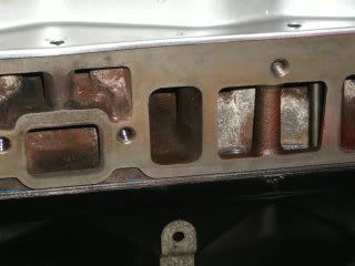

Originally posted by White 84 SE:

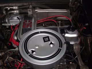

Well, there is a coat of solid carbon over everything in there. Say....1/32nd of an inch. The center intake valves had spark plugs with too hot a rating so they are whiter, not cleaner. But no it's not like caked in there. Here's a closer pic..
Those white valves are exhaust valves. They're slightly hotter because the center two cylinders get a slightly leaner mixture distribution.
Were your plugs "white white" on the ceramic, or were they tan?
errr OhYea!! I knew that...(not really). The plugs were white...maybe tan but only on the metal. Really not far from normal.... They were a different brand so I thought.....probably...

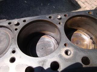

Here's something that seems odd to a 1st timer. The pistion bores look like there has not been extensive wear....and it has 175,000 miles on it.... It's knocking me out! Doesnt look like a bore job is in order but I gotta check the #s later for sure. Oh, notice the 2 bolts that broke off... These will be a pain...ug

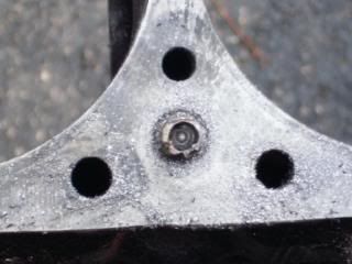

Those broken head bolts may not be as hard to remove as you think. On the Duke the head bolts are "torque to yield", you tighten them to a specified torque and then "go a little more"...and they're not all the same amount, it depends on the length of the bolt. Make sure you follow the torque specs closely.
I had one of those same bolts broken on my '86 Duke when I got it and was afraid it was gonna be bad. I was replacing a blown head gasket and was doing everything in-frame, so I knew it was gonna be a pain. It was broken off a little shorter than yours, sticking up about 1/8". I took a scribe and cleaned all the gunk out of the chamfer, sprayed it with WD-40 (I know, there's better stuff to use, but hey), and let it set for about a day. When I went to take it out I took a cold chisel and hammer and started to back the thing out. After only a few light taps it started turning, and the rest is history.
When those suckers break off in a Duke it's not so much that the bolt is stuck in the threads, but more because of the torquing procedure. The bolts are torqued almost to the yield point, which can introduce tiny fractures in the bolt allowing corrosion to set up inside the bolt itself.
Which brings us to the following public service announcement: Always use new head bolts whenever you do the head on a Duke.

Cool, I will try that now! I cleaned and sprayed yesterday.

Oh well didnt work.... I will try drilling down through the center with a small bit and then expand the hole with larger bits and go for the "easy out" tool. If that doesnt work I can then continue expanding the hole and eventually pick out the pieces of the bolt. This way will work it's just a pain. I think the left handed drill bits might help here. I need a set of bits anyway.

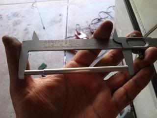

Today was measuring day for the block. Most everything passed. The crank endplay, connecting rod end play, connecting rod bores, crank journals, piston size, block bore, the whole schpeel. Tentative on the bores as I have yet to get the proper tool there. So, it LOOKS like no major surgery, just bearings, bolts, seals and cleanup. There was a ding on the oil pan, cylinder 3 got some scuffing, and mineral build up in the water jackets, and surface rust on the block all of which was remedied today. When I get the locking caliper/divider I can double check on the bore sizings and get the bearings.
Didnt have a telescoping guage for the cylinder bores so I fabricated one out of aluminum pipe shown here. With it I am getting a bore size of about 4.004 which seems crazy for a 175,000 miler. So to be sure I am waiting to obtain a dedicated measuring devise to double check.

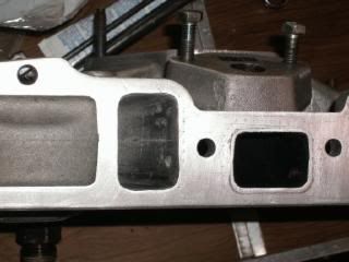

Well had a little down time so I gasket matched the ports on my intake manifold. While I was at it I polished the aluminum. At first I just wanted to clean it good but then I remembered someone saying something about how aluminum can be polished up. Used a small coarse steel wheel for basically all of it then finished with a larger fine. It's not like chrome but it is smoother. I figure it will keep better (grime won't stick as well) so it was worth the time. I hear they have clear engine enamel now....

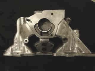

Here's something I dont hear much about. Besides gasket matching the ports I smoothed the transition from the TBI to the runners by carving a concave path. This way the 2" port eases to the 90 degree change of direction. I think this will allow more air than if the charge were to have to go another 1/4" and make an abrupt change.

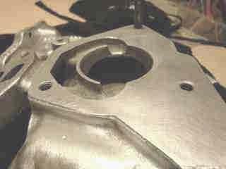

Well I found a lot of metal to remove on the exhaust side but it cant be roughly hogged to match so much. What I could do is allow the exhaust to flow better by carving a shallow transition. The English call this "Gas Flowing" I guess. The pipes and welds wont allow for porting more than a few centimeters in but that's enough to make things flow a little better. See the pic to know what I mean.
...OOHHH so thats how to fit a round hole with a square peg....hmmmm

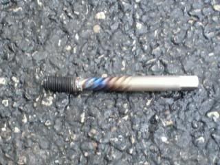

Well, got those bolts out! The heat really worked.. Just heat it up for the time it takes to drink a beer...like 15 minutes and than give a try. All the head bolts get a thread sealing so this may be why they tend to stick.
One of the bolts came out without drilling the other was drilled like this...
Then I heated it up for a good while with the extractor inserted and it came out easy.

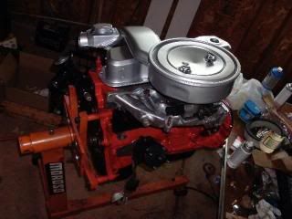

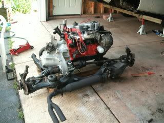

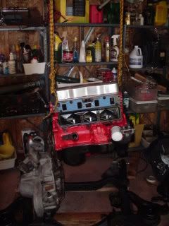

Here's a list of what needed done...
New gaskets: Head, Intake manifold, Exhaust manifold, EGR, Rear main seal
New piston rings
New cam shaft (performance)
New valve lifters
New bearings: Cam, Main, Connecting rod
New freeze plugs all around
New head bolts
Valves refinished
Bores deglazed
Massive cleaning, wire brushing and rust treatments
New paint for the block, pan, covers and snorkel
Porting (gasket matching) basically every port
Previously exchanged the stock EFI with the Holley Big Bore I was lucky to obtain
Also trading out the old muffler for a Glass Pack.
Here she is so far...
Went with the traditional red/black and silver....
Every thing is waiting for those goofey bolts.
And some Decals from Fiero Sails.
84 2.5L Holley TBI Manual Trans White

I wanted to show everyone how easy it is to do the porting.
All I used was a rotary rasp on a high speed drill. Like this one.
It is pretty cheap but decent removal of metal is possible. Another good thing is it seems to work nice and slow. It didn't seem easy to take off too much like I have heard others warn about with the die grinders and flame shaped carbide rotary files.

Here's a pic of my roughest intake port done with above tool. The head ports being iron and much harder are smoother.

Cool! Here's the engine compartment with new paint and Indy decals

Here's as pic of how it looked on the cradle with the VHT'd glasspack and reconditioned cradle.

Here's what I did to lower the engine onto the cradle....used rope!

I wanted to show pics of the gasket port matching...
This is the intake done with the rotary file on a high speed drill. Took off 1/8" on 3 sides and smoothed passage.
Here's the exhaust manifold again as it was quite off the gaskets..
Notice the hole was round and now it's more square to match the gaskets. This was done on all 3 openings.
