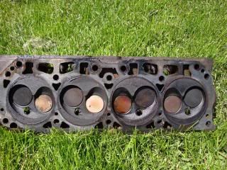

One of the previous owners already ported the intake pretty much. Decent job too. The head hasnt been worked. Just a little clean up needed on the intake. Apparently there was a little leak from the coolant to the #1 intake port. No prob!

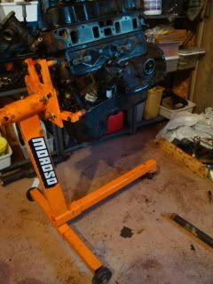

2x4 is actually for motor cycle use ,,you want something you can place the engine on and turn it around ,,try to borrow or rent engine stand,,probably to late for this ,,
you can use 2x 6 not as easy to move as motorcycle engine ,,you have to have a bench to lay it on
I use card board for a lot of different things,,better than a creeper under a fiero,,you would lay cardboard under your engine stand which is just a box ,square or retangle you add 2x4,s to box to bring engine to where you want it.
you can also build a cheap garage stand from a stout piece of plywood bolted to the clutch end ,how you brace the front is up to you
a duke is light enough you can supend it from garage beam or a stout saw horse keep the weight off the beam except when you move or turn the engine..just make sure it will not chrash to the floor

Bought a used engine stand today and removed all accessories and the transmission. Went on Craigslist and got a used Moroso from someone a couple miles over...$50 If I dig the renewed Duke than cool I will pass the stand on to some lucky dude for like $40. If not than I will likely use it to recondition a Fiero V6.
Right now the Duke is the only thing on the cradle. Will mount her on the stand probably Saturday.

Alright, Got the Duke up on the engine stand and romoved the lifters and pushrods. They seem O.K. but I noticed some gouging on the #4 exhaust lifter. Looks like some serious foriegn matter was stuck under that lifter. All the lifters are somewhat worn but not dramatically. They all came out easy. Some of the rockers were looser than others.... This may be a major noise maker..? Anyways some were not torqued to spec.
Oh, I used the garage cross beams and some doubled up 300 lb rope to nudge the engine off the cradle and high enough to mount onto the stand. Used a seperate rope on each side of the engine. I wheeled the dolley to where the cross beam was doubled making it a 6x6" beam.
Oh, just off I notice there is a decent amount I can remove off the intake ports.

Here's something that seems odd to a 1st timer. The pistion bores look like there has not been extensive wear....and it has 175,000 miles on it.... It's knocking me out! Doesnt look like a bore job is in order but I gotta check the #s later for sure. Oh, notice the 2 bolts that broke off... These will be a pain...ug

Oh wow look at all that carbon....maybe 25 years worth. He he, is this something like carbon dating for the auto archeaologist? Makes sense though. When I did the compression test the results suggested major carbon and new rings but with even and minimal wear. This is likely the situation but gotta run the specs to see if a bore or new parts etc..

That doesn't look like an abnormally large amount of carbon. How much of a step is there to that ridge in top 5/16" inch of the bore?
Ya know Kurt, there was so little I thought it didnt even need the ridge reamer. I could barely feel it with my fingers. It was decieving as I found there actually was a ridge but still it was VERY small.
Well, there is a coat of solid carbon over everything in there. Say....1/32nd of an inch. The center intake valves had spark plugs with too hot a rating so they are whiter, not cleaner. But no it's not like caked in there. Here's a closer pic..
The compression check came out at about 150 psi for each pistion that was say 90 at first rev and built up after 2 revs. With the addition of oil compression went to 225 about. That says new rings and a lot of carbon but with minimal piston wall wear is what I was thinking....no?

just HOW MUCH oil did you put in there ?! to go to 225 (should have at the most gone to 150), you put in WAAAY too much oil. in any event, thats not an incredible amount of carbon, the valves look halfway decent, Good luck with those broken Head Bolts. be real careful, plenty of PB Blaster, this being your first time on this, if you can't get them out by clipping a vicegrip onto them & screwing them out, Take It To a MACHINE SHOP, or you may crack the block.
White 84 SE
Posts: 812
From: Chicago, Illinois USA
Registered: Nov 2008
Report this Post05-20-2009 09:42 PM Click Here to See the Profile for White 84 SESend a Private Message to White 84 SEDirect Link to This Post
You know what I had some HD oil hanging about...it's thicker than normal. It was up to 150 without adding oil....The heavy oil is probably what did that... The manual could be more informative here. It only says that they should all be within 70% of each other and that none should be below 100psi. Mine were all 150 about but it took a couple revs to climb there.
Sure wouldnt want to crack the block dang. There were bolts in the there that never seen the sunshine or a drop of oil for 25 years. Regarding a "machine shop" I think they would drop the block and kick it a few times just for some extra $$$ and then charge me for it and say it cant be done. Sorry I am quite pessimistic of those thugs.
