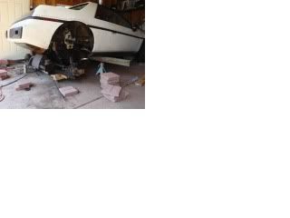

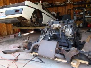

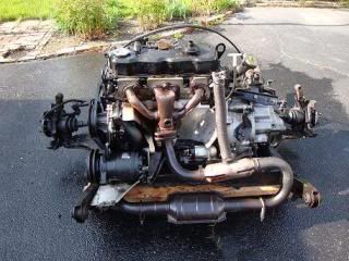

So today I'll saw through the last cradle to body bolt and lower the Duke and raise the body and out she'll be. Wish me luck! ------------------ 84 2.5L Holley TBI Manual Trans White
[This message has been edited by White 84 SE (edited 05-12-2009).]
10:16 AM
White 84 SE Member
Posts: 812 From: Chicago, Illinois USA Registered: Nov 2008
The Duke has left the body. Taking a lunch break! Learning a lot. For one I've switched to 1/2" ratchets as I broke a couple 3/8 inchers. Also the heat type muscle rub is good for the strained triceps! Oh and there are these new gloves with oil proof fingers and palm that fit good. Now I just lift the frame up another 7-8 inches and roll her out. YEEEHAAA!!!! ------------------ 84 2.5L Holley TBI Manual Trans White
[This message has been edited by White 84 SE (edited 05-20-2009).]
01:03 PM
White 84 SE Member
Yea! She's a out! Now that the exciting stuff is over I will be talking to ya later. Gonna get busy. Hold on....I think it's time for a musical number...." I did it MYYYYYY WAAAAY" hehe ------------------ Oh by the way, I used a 4x4 under the car just in front of the cradle bolts (theres a little notch there on the frame--it's not the wheel jack notch but a few inches back) , used a jack stand on each side and used my jack to inch up the car one side then the other about 3 inches at a time. This way it can be done by one person. There came a point where my jack was not tall enough. Since The jack stands and jack were not underneath I felt it safe to use cinder blocks to raise the jack height(not the jack stands!) and support the beam with my jack stands which were tall enough. See the 3 pink blocks next to the jack?

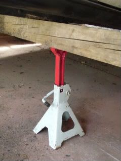

Oh here's a pic of the jack stand. It IS fully extended but it is only a 14" jack stand. On top of that is a 4"x4"x8' plank located just in front of the back wheels with enough clearance for the front of the cradle. This was enough to slide the engine out the passenger side wheel well after removing the splash shields and TBI....! ------------------ 84 2.5L Holley TBI Manual Trans White
