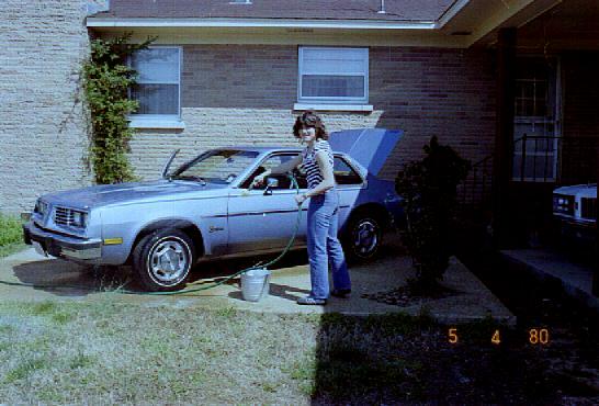

Around 1976 Pontiac was given a version of the Chevy Monza with the 2.5L Iron Duke. The engine was a response to the Vega engine which had a habit of self destructing. The Sunbird name lasted until the model was dropped for the new FWD J2000 but after a couple of years they dusted off the name and stuck it on the FWD. I owned a Chevy Monza Towne coupe (their spelling) but I liked the style of the Pontiac.
The 2.5 in those cars did not have the crossflow head (carb and exhaust were on the same side) but the basic engine block was there, with a little mors internal structure (probably similar to the S10 engine). It did not make very much horsepower, typical of the late 70s, definitely less than 90, possibly less than 80 (remember 305 V8s from that era had only about 120hp, 350s ranged from 150 to 200).
this is the only pic I could find, a 1980 coupe.
