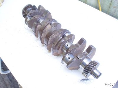

I have just started following this thread, I have to say It takes some Ba11s to get past the naysayers.
I am Very familiar with the Iron Duke and its design and layout problems and benifits. Other than flawed rods, a crappy crank design, and constant oil leaks (Ok, it leaks any fluid you put in it) , the Iron Duke is a decent daily driver engine.
The biggest flaw that hurts the engines ability to produce decent power, is its crank, the design of it is horrible. There is only 1 counterweight on each cylender, so at high RPM's the crank wants to distort, and starts to do so at around 5000 RPMs, it's a weak crank anyway. The stresses it puts on the block and rods cause it to blow up if reved too high. Or at least thats what I have gathered from working with a few of them. I think that if you put in a crank, any crank that has the full 8 counter weights, the Iron duke will suddenly be capable of puting out a decent amount of power.
There are a couple of cranks available. Like mensioned, there is the
1) 153 Chevy crank, I know nothing about it.
2)Mercruiser 3.0 Crank witch has a real long stroke (3.5"?) and is built to sit at revs all day long, It is REALLY good with torque. I don't know if it has 8 counter weights or not.
3)SD4 Crank, witch is a longer stroke crank as well, it has all 8 counterweights, is knife edged and has 2.10" crank pins, SBC rods and pistons actually will fit. Unfortunatly the cost is prohibitive.
I was considering building up a Hi perf Duke for my Indy, as a freak motor. Stock looking but puts out 150 or so horses. It never materialized when I couldn't find a crank.

Here's the picture of a Merc 3.0L crank:
There are the eight counterweights you wanted. Here's my thoughts:
1986 Vin E (from Astro Van) Block
Merc 3.0 Crank
Crower Rods
Silvolite hypereutectic pistons (9.5:1)
+1 Roller Cam and Lifters
SS Stock Sized Valves
Hi-Po Springs
Full Roller Rockers
87-92 S-10 Head, Ported/Polished
Custom Aluminum Flywheel
Adapt an 87/88 Intake/TBI unit to head.
87/88 Harmonic Balancer
Have entire rotating assembly balanced.
MSD Ignition with Rev Limiter
Add a nice 6-8 PSI of boost and tune-it.
This sounds like fun. I wonder what my wife will say when I start collecting parts for this.
