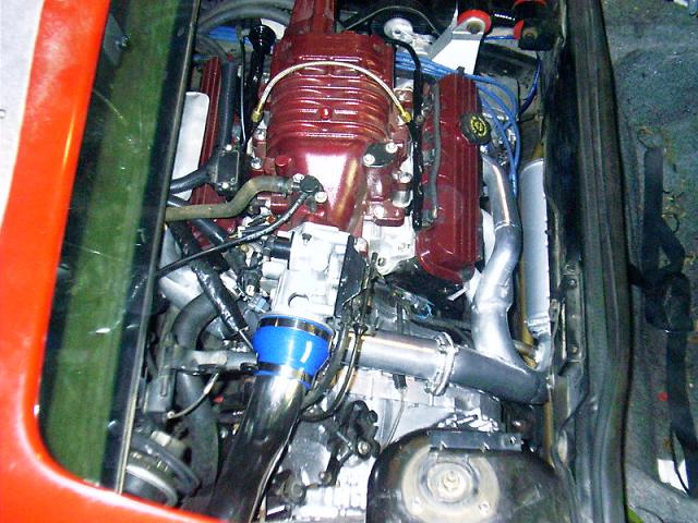

Actually, they are already running around in cars. Read on
Originally posted by zi_gravedigger:
Purple, any more info on the headers?
And unfortunately I've already ordered WCF poly mounts... I read through a bit of your thread and I hope they're good enough for my entry-level swap. I'm not shooting for 400ft-lbs of torque. Just a basic pulley swap and free-enough flowing exhaust to support it.
I hope to hit 240hp at the wheels, which I doubt will be hard to do. Really I could care less what my actual output will be- shooting for 240 is just for bragging rights and comparison to other cars. It'll still be a blast to drive if I fall 30hp short or if I hit all the way to 260... and that's all that matters.

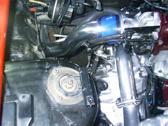

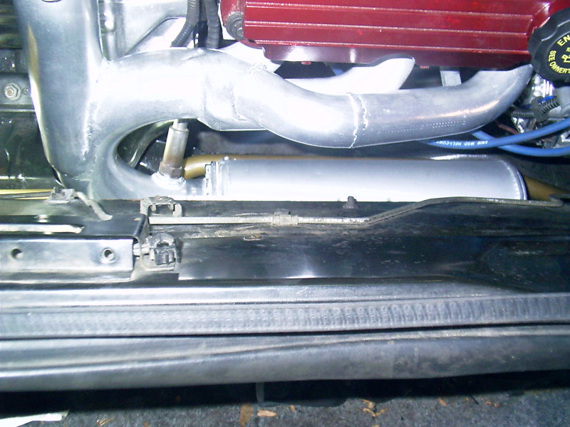

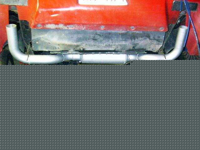

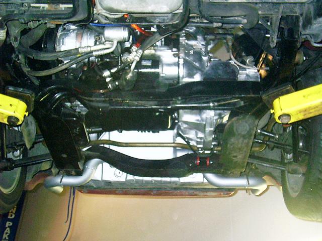

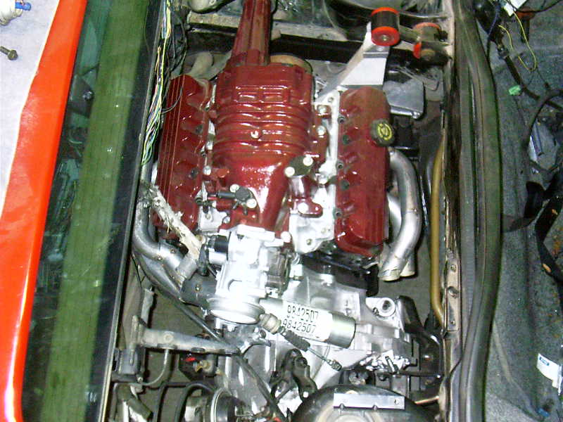

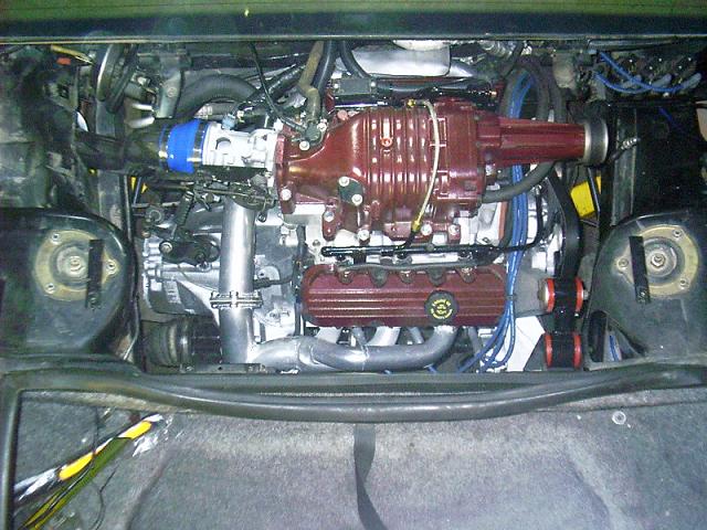

Initally I had no intention of revealing this car or it's headers until the owner chimed in. The following pics are of a car I built for a guy in Chicago. It's an 88 GT 5 speed awaiting bodywork. As you might see the headers were designed to come from the firewall bank and mate with the trunk side & exit into the muffler in the stock location WITHOUT modifying the trunk. They were built in a 2 piece design so they can be removed with little disassembly of the car & less connections to leak. I used 1.75" primary's and 2.5" piping, all mandrel bent, MIG welded, Ceramic coated. I installed them for $700 and $300 for coating. Now I hadnt planned on "building headers" but if there is enough interest in this style, I may be able to reduce costs.
My only issue is I have not tried this on an auto yet, cause there is a LOT LESS room to get the exit pipe to come to the stock muffler location without coming too close to the trans range switch & trunk wall.
The first pic shows the firewall side done & test fit, and the begininng of the trunk side
This pic shows the headers completed & installed ( from a distant view )
This one show the up close detail how the "Y" section comes together & the mandrel bend exits toward the stock muffler location with no modifying of the trunk.
Crossover section detail
This is all I have of the underside the exhaust I already built & installed.
Final product
I'll start a thread on the build of this car soon. This build went a little over budget and over on time ( but hey, what project doesnt )
He started with the request of a 3800SC swap & Cam & porting, to " I wanna hang in front of a stock C-6 " ............O.K. I said it would take a little longer & MORE money. But in the end, you can ask the customer how happy he was when he picked it up & drove it home. That car was stupid fast.
[This message has been edited by PURPLE REIGN (edited 11-21-2007).]

Report this Post11-22-2007 12:11 PM Click Here to See the Profile for darkhorizonSend a Private Message to darkhorizonDirect Link to This Post
PERFECT exhaust setup PR, that is just GREAT. I am way jealous of those things, those suckers would be worth the $1000 if WCF could sell something that nice. The way the exhaust is setup is just what 99.9% of all the 3800 swappers on the forum are looking for, I think i see room for cats in that setup even...
What are the dimensions on the muffler?
Thanks. I could probably get the cost down to $800 to $900 coated. The muffler is pretty much a shortened flowmaster. I should look into the cat issue since I didnt really leave any room for that. But these cars are hitting 20+ years and will only need collector plates in most states.

Report this Post12-29-2007 01:47 PM Click Here to See the Profile for zi_gravediggerSend a Private Message to zi_gravediggerDirect Link to This Post
The WCF mounts
The powder coated engine cradle and 4 speed
The 3800SC series III from Ed after a little cleaning. 40k
Painted the supercharger. I want to paint the valve covers to match but did not have time.
I love it... very shiny. 3 coats of high temp red and 5 coats of high temp clear.
[This message has been edited by zi_gravedigger (edited 12-29-2007).]
darkhorizon
Posts: 12279
From: Flint Michigan
Registered: Jan 2006
Total ratings: 451
Report this Post12-29-2007 02:50 PM Click Here to See the Profile for darkhorizonSend a Private Message to darkhorizonDirect Link to This Post
why is the DBW throttle body still on there?
zi_gravedigger
Posts: 268
Registered: Nov 2007
Report this Post12-29-2007 03:23 PM Click Here to See the Profile for zi_gravediggerSend a Private Message to zi_gravediggerDirect Link to This Post
Because I was an idiot and left all my tools in Toledo, picked up the engine and '98 GPT throttle body, MAF, fuel rails, injectors and PCM in Cleveland, hauled it all home and realized I couldn't tear anything apart. Plus I have not yet ordered the adapter plate to put the older throttle body on the gen 5 supercharger.
