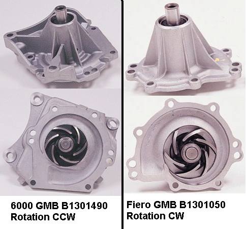

The below image shows 2 GMB brand pumps side by side. (Images from partsdirect.com ) Note the curve of the impeller blades is reversed on the 6000 pump relative the Fiero one. (Direction of rotation when viewing pulley end of shaft.)
Unless one of those image scans is reversed, and I non't think they are.... The 6000 pump will never work right in Fiero. Even a straight blade pump would be seriously impared.
This means, as I pointed out in your other thread about part interchange, that You Must change the pump and the housing to Fiero parts.

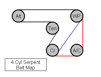

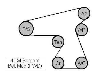

Think of the belt, well, as a belt. (This also holds true even for V belts but you rarely ever see things run on the back of a V.)
Anything inside the belt, meaning all your grooved pulleys, will turn the same way as the crank.
Anything running on the outside, All smooth pulleys, turns the oposite way of the crank.
Here's the normal Fiero belt map.
Here's what I remember of the FWD map. (It's been awhile since I had one in front of me.)
Now, follow the belt path with you finger. On the fiero map only the tensioner is on the outside of the belt. In the FWD one, both the tensioner and the WP are outside.
[This message has been edited by theogre (edited 04-08-2002).]
