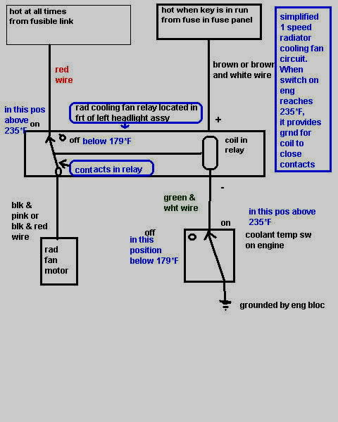

Report this Post04-07-2002 01:59 PM Click Here to See the Profile for maryjaneSend a Private Message to maryjaneDirect Link to This Post
You can disconnect both hoses on your rad. Put the cap on the rad. Put the garden hose on where the lower rad hose went, leave the other (upper) connection open. You will need to put a rag or something around the garden hose to help seal it off. Turn the water on, slow at first. Water should now be flowing backwards thru your rad & coming out the upper connection. If you have steam showing up at your thermostat housing while the engine is running, that sounds like a bad hd gasket, but may be the eng is trying to run hot because of the lack of flow.
Back flush the rad as above, back flush the eng as Ogre said. connect the rad hoses back up, fill the system properly. Remove the thermostat & cap. YOU squeeze the hose leaving the thermostat housing, while someone else starts the car. At cold start, the high idle should provide plenty of rpms to the water pump. If you get no flow out the top of the thermostat housing, you have water pump problems, or the passages in the eng are totally plugged up. I've never seen passages that plugged up tho. You should get some flow. **Post back here***!!!! with results of flushing-watch to see how dirty the flush water is, it will give some indication of your system condition. We're tryin to help ya, don't leave us hangin
Here is a simplified drawing of how the cooling fan system works. I've left off the 2speed fan part, the a/c part of it, and the eng blower part to make it easier to read.
[This message has been edited by maryjane (edited 04-07-2002).]
