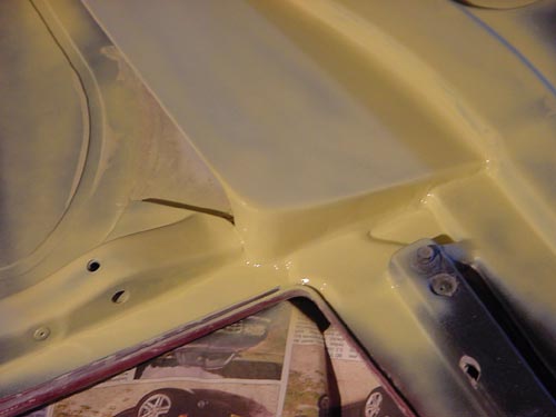

Oops, updates:
sanded and primered the inner sailpanels
mockup with the mesh I want to use on the vents.

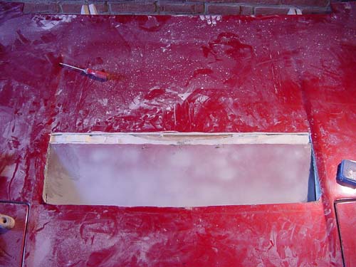

time to talk about clear hatches FieRo
this was a quick sketch I had done about a month ago before I ended up getting two notchbacks..
it was designed to mimic one of Aus's front hood chops..
but the vents along the sides could easily move over next to the solid pillars

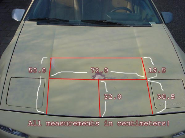

09-16-2004 01:42 PM Click Here to See the Profile for Fie RoClick Here to visit Fie Ro's HomePageClick Here to Email Fie RoSend a Private Message to Fie RoEdit/Delete MessageReply w/QuoteDirect Link to This Post

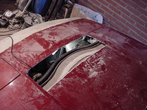

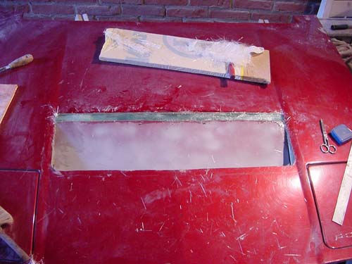

I started drawing clear hatch ideas when Ducattiman asked for a F40 type of hatch for his BMW V12 conversion...
So I have been researching the F40 style rearhatch for some time now, but I dont know how to make these shapes in plexiglass only...plus I am looking for a cleaner style for the "stock" fastback and trying to make it relatively easy to build.
The idea is a twin-hatch: stock decklid with the middle piece cutout and an added fiberglass piece (between the sailpanels). The seperate top piece has a fiberglass frame with a piece of "bendable" plexiglass plate that can be screwed or popped in place. It is hinged to the rear roof. Ideally it would be nice to have some linkage between the upper/lower hatch so you could open the decklid the normal way and the top hatch would move up a bit more so they dont hit. A one-piece design would be much more difficult to build because it needs to be hinged at the roofsection which is to weak to bear all that weight without reinforcing.
Ow btw, I will also try to incorporate a row of small vents on both sides (like the newer ferrari's) so the rest can stay smooth and clean.
This is one of the latest ideas. I am not going to do this to mine soon, but maybe in the future...hehe.
I need to update the buildup. I havent done much but there are some new detailing pics and ideas I will post as soon as possible.

09-16-2004 01:47 PM Click Here to See the Profile for KohburnSend a Private Message to KohburnEdit/Delete MessageReply w/QuoteDirect Link to This Post
yeah I was planning to have it be a 2 peice also - the idea was to have two struts positioned like Kameo's rear sun deflector ..
i think that last pic of yours chopped but adding some rows of vents at the very top (high suction and it doesn't block any view) and down the very edges would look very very slick

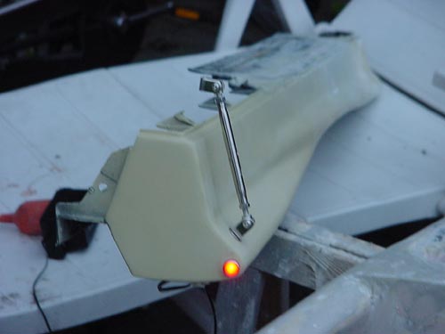

Some mods to the sideskirts (I had to use the stabilisers "somewhere"!) Mockup:
Weatherproof Leds:
Testing:

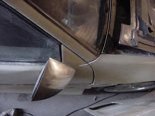

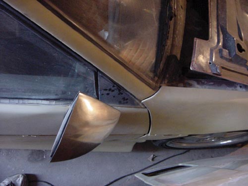

Now it would be nice to shave the moldings on the fiero but I know I break stuff so I want the bodypanels being removable.....but that doesn't mean you cant smooth anything. I have been looking at the triangle thingie:
And thought about something like this (PS):
I think I will do this mod...
I will also try to take some pics of the smoothed (not shaved!) doorhandles and the cleaned up underside of the hoodvent.

09-16-2004 03:34 PM Click Here to See the Profile for Fie RoClick Here to visit Fie Ro's HomePageClick Here to Email Fie RoSend a Private Message to Fie RoEdit/Delete MessageReply w/QuoteDirect Link to This Post
Untill now I have looked more for a nice "shape" than "function" in the first ideas... but a good combination is the challenge Yes, efficient venting and a clear view is the main challenge I guess... So I are you going to build yours?

Well, I have my windows up and the doors closed most of the time I think the mirrors also stand out much more natural with the triangle smoothed to the doors. I tried M3 style mirrors, they were different but not better looking than the stock mirrors. Plus a lot of work to make them fit. Skipped that one. The polished stock mirrors are now part of a set of polished/chrome/aluminium accents on my fiero. This mod might make them look even better... I hope

as for the triangles by the mirror - they deffinately look good.. for me its just a matter of do they stay attached to the frame, or do they travel with the door.. maybe if they were molded into the door and then the mirrors had little camaro/vette style wind defflectors between the mirror and the triangle portion to blend it all together..

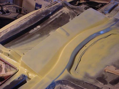

"Smoothing" is is what it is all about in the rest of this post pics of today. years of work....hehe.
Some more smoothing of the rearpanel and the rearclip:
Smoothing of the underside of the fronthood vent:
notice the hinge vents

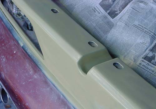

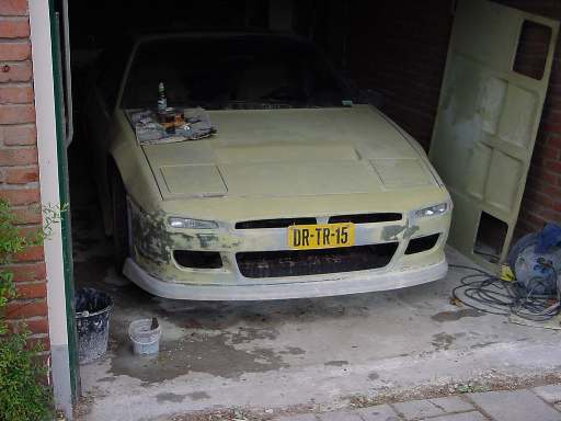

It's getting closer to paint! At least its finally back on the road again. It cost more than a month and several new parts but after getting a fuelpressure gauge it showed some idiot sent the wrong fuelpump to start with!
Anyway, some new parts never hurt...
I looked for a piece of metal to mount my new FPgauge, first piece I found was the spare shim that came with the new starter motor!
exactly what I was looking for! No drilling required.
The new rearbumper has gotten another hundreds of houres of sanding and sculpting, but it just has to be finished soon or it never will! The car really needs some ass.
Most of the time now is spend on smoothing the smaller details of the body
I have a new small added piece to the frontscoop (pics when finished) and I have looked over several
"smoothing the mirror triangle thingie" options and I guess I have decided I will do it and also how to do it... !
Painting is postponed by another two weeks!

10-04-2004 02:38 PM Click Here to See the Profile for KohburnSend a Private Message to KohburnEdit/Delete MessageReply w/QuoteDirect Link to This Post
you just keep teasing..
when are you gonna start selling your style nose.. I want one
your front and rear bumpers fit perfectly with stock aero molding - so its a great mod for any aero notchy or fastback.

Today I got some chemicals and stuff to play with:
Real carbon fiber!:
Did some more PS tryouts on the triangle thingie:
a PS on my own fiero, original:
Now this would be relatively easy to make; A little raised edge molded to the door, and a CF cap mounted on the stock triangle...:
Thanks to sewing_guy to remind me of CF

Baked a cake (that was fun!):
Cut some pieces (and did a mockup):
Still thinking of different options of mounting and smoothing....details details details...but its fun to do those little accents...if they work. Skip them if they dont. Looking at the pictures I just changed my mind again
man i really like how you caried the seem acros along the edge of the mirror..

Originally posted by Master Tuner Akimoto:
I think those mirrors are too big.....sorry, not trying to bash you. I have tried a such a setup with M3 style mirrors and they just didn't look right. I skipped them finally. Now my challenge is to incorporate the stock mirrors in an updated design...

Originally posted by 2fn4wrds:
Your vented hood is soooo what I want!!!...and need. Maybe in ten or twenty years when you have time you can give the dimensions for cutting etc. and the procedure. And your steeper taper/shorter front end is brilliant, elegant/simple/ a bit 944 meets 2004
Thanks! If you're thinking ten or twenty years than I better give some measurements right now!
The main trick is respecting the stock lines and extending the horizontal lines of the headlights
metric dimensions in centimeters
The idea was to reuse most of the cut parts. The cut decklid part angled and moved forward about 2 inches:
Filled the gap with a few layers of fiberglass and bondo later:
