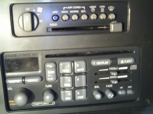

Bought & installed factory radio wiring harness connector.
Bought & installed late model radio wiring harness adapter.
Bought & installed Pontiac factory AM/FM/CD player.
Bought & installed trim plate for radio.

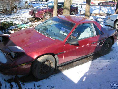

Some before photos taken in Parsons, Kansas:
Photos taken in the driveway of one of my previous homes.

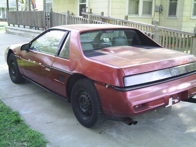

A before photo:
An in-progess photo:
