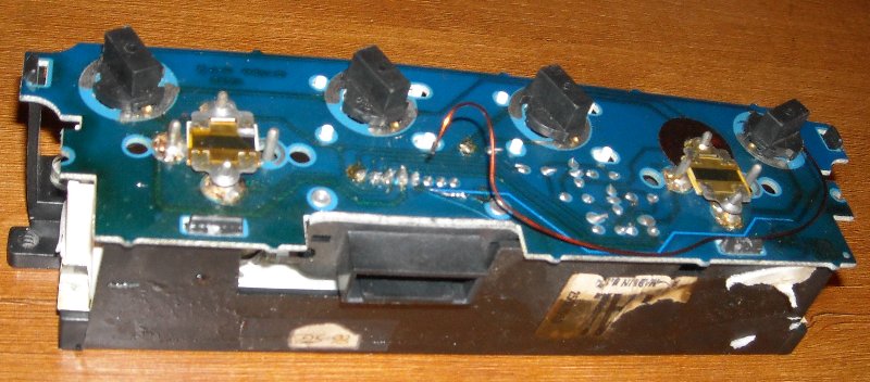

Took advantage of the 78 degree weather. Resoldered a loose repair wire on the Aux. gauges PC board.
Lights work again.

Temp gauge stays at 100.
Grounded sensor connections, no response from the gauge.
Time to check the IP area.
30+mpg
Posts: 3954
From: Russellville, AR
Total ratings: 94
12-28-2009 06:27 PM Click Here to See the Profile for 30+mpgClick Here to Email 30+mpgSend a Private Message to 30+mpgEdit/Delete MessageReply w/QuoteDirect Link to This Post
The green wire from the sensor, the solder connection at C500 C2 has broken.
An easy solder repair.
