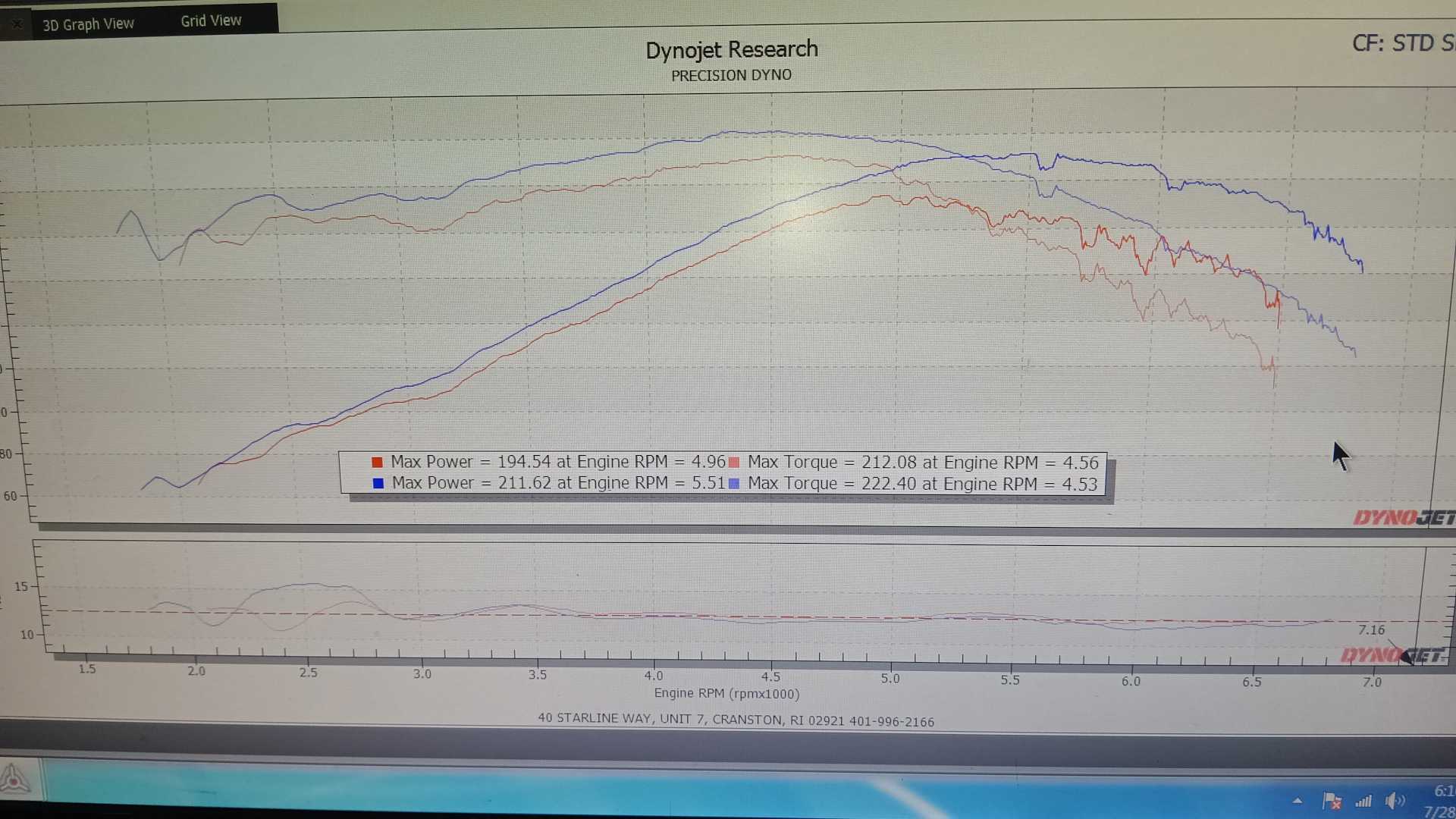

Went to the dyno last night. Did a base run to look at the changes I made after not feeling completely comfortable with the last dyno in June...
We calibrated my rpm by speed by setting 2000rpm on the dyno. Once done, I got a smoother graph that shows RPM instead of speed.
Turns out that me backing off about 1.5 degrees up top and slightly over the course of the rpm range as well as removing some fuel by targeting 13.5 in the low-to-mid range really helped! I had left the 12.5 target up top.
However, with better timing, the misses, or rather detonation became more pronounced up top from 4600 on up. As a result - I didn't gain any peak horsepower.
I did gain torque. I now make 230 ft*lbs at 4100 rpm. That's +20 ft-lbs! Same horse power of 209 due to the fuel/iginition/timing issues up top. That's kinda insane!
We then did a run with my exhaust cut-out open. While I lost 2 ft*lbs at peak. I gained 2 peak rwhp to 211. However I gained 10 hp past peak so it is useful for +5000rpm...if only then.
After that, we set timing to +26 (+base 10). We also removed a little bit of efficiency from the VE table from 4600 and up.

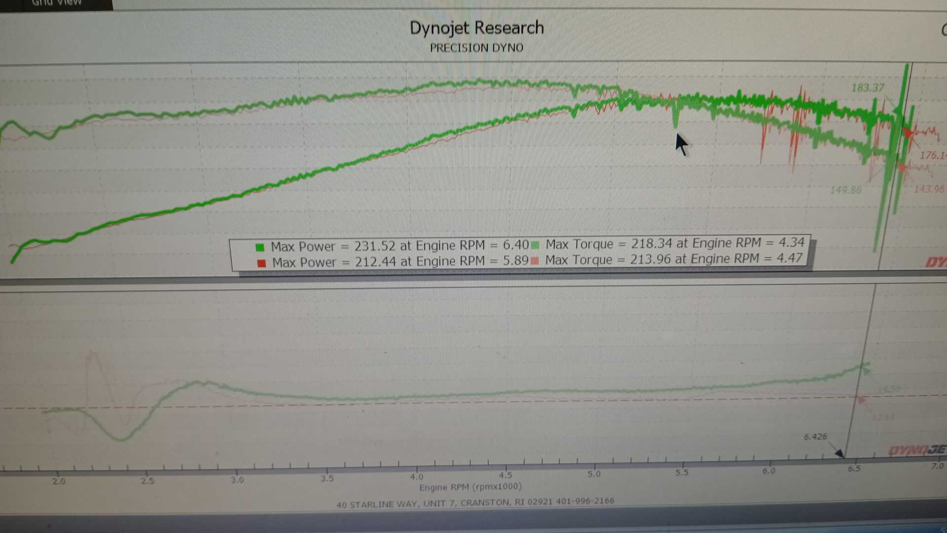

Here's the promised dyno of the extra ~21 ft*lbs of torque I picked up just by leaning the mixture closer to 13.5:1 below 4000 rpm.
The red line is with the cutout closed. The green line is with the cutout open. Same tune. Only difference is the open cutout...
You truly don't see some gains from it until past 6000 rpm.
Increases start to come on at about 4800rpm but not worth it yet.
Looking forward to fixing that Code 41 and pulling some timing and fuel out. The pre-detonation is killing my peak power.

Report this Post05-26-2025 10:31 PM Click Here to See the Profile for lou_diasSend a Private Message to lou_diasEdit/Delete MessageReply w/QuoteDirect Link to This Post
Dyno from a couple of weeks ago.
Gonna add fuel across the map spectrum at high rpm to see if that fixes things.
La fiera
Posts: 2304
From: Mooresville, NC
Registered: Jun 2008

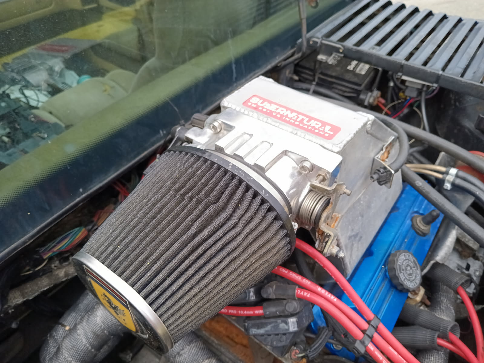

Report this Post05-27-2025 11:04 PM Click Here to See the Profile for La fieraSend a Private Message to La fieraEdit/Delete MessageReply w/QuoteDirect Link to This Post
I can see the car is fast now and here is the reason. Comparing your last dyno with the previous 3.4L to this 3.5L Iron head L32 is that the increase in HP and torque are at the right places. Forget about peak numbers and look at the area were it matters the most. Lets take for example peak HP and TQ at where it matters in your kind of racing, you need HP and TQ to increase as RPM increases right? Look at your last 3.4L dyno results and let's just concentrate on HP and TQ at the 6000RPM mark. If you follow the graphs it is conclusive and predictable to see that at 6000RPM the 3.4L produced 125WHP@6000RPM and about 115WTQ@6000RPM.
Now look at the L32 3.5L Supernatural I made for you. Pay attention at the 6000RPM mark. The 3.5L is at right about 197WHP, that is a 72WHP gain at that specific RPM and TQ is right about 170WTQ which is a gain if 55 lbs/ft at the same 6000RPM. To get this kind of gain, the majority of individuals would opt for a turbo.

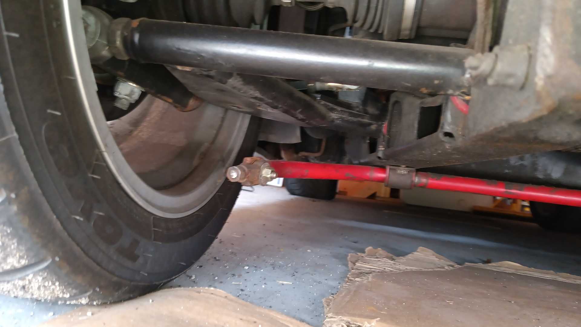

For the last 2 races, I feel from my steering wheel a knocking sensation left and right on the highway driving to/from the track so I suspect I have a bad front wheel bearing.
I've had a broken rear sway-bar end-link.
I think both those issues came to light when I had to go WOT in the final 2 races I did yesterday in turn 2 to keep up with the fastest competitors. I am awaiting the videos to be released. We've had FIOS out for over 24 hours. It got restored this morning so I'm sure that delayed the youtubers from uploading.
I will add the pic of my broken end-link in an edit.
Next race isn't for 4 weeks. I have a lot of changes planned including fixing the swaybar end-link, possible front wheel bearing...probably use an S10 bearing if needed.
