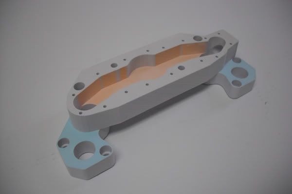

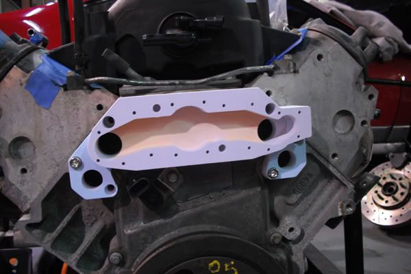

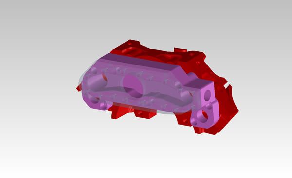

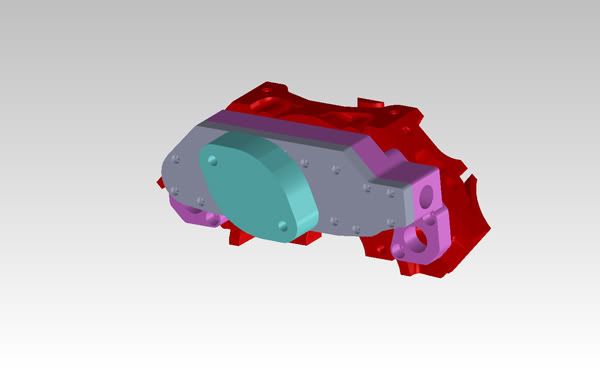

Report this Post10-24-2011 08:10 PM Click Here to See the Profile for Dan86GTSend a Private Message to Dan86GTEdit/Delete MessageReply w/QuoteDirect Link to This Post
Dan86GT
91 posts
Member since Mar 2010
So instead of modifying the LS4 water pump assemby I decided to design a manifold that could accept -12AN fitting inlets, incorporate a heater bypass, and allow a SBC thermostat housing to bolt right up.
Something like...
The red is the engine block. The purple is what I plan on making, the gray is the lid. The light blue is an off-the-shelf thermostat housing. The heater bypass is a -10AN fitting. It exits to the front of the car. I am also going to have a plug on the top of it for bleeding.
So I threw this into the 3D printer and got...
Bolted to the block...
I can actually make it about 3/8" tighter to the front cover. I want to make this as narrow as possible. Obviously the lid is not shown in the pictures. I also noticed that the head actually protrudes the front of the block. I will have to cut the back of the area around the heater bypass to clear it.
Next step is to bolt on the lid, thermostat housing and see how everything fits in the car. Actually first I need to deal with the motorplate and starter...
Dan

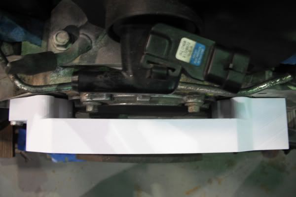

Report this Post10-26-2011 08:03 PM Click Here to See the Profile for Dan86GTSend a Private Message to Dan86GTEdit/Delete MessageReply w/QuoteDirect Link to This Post
This is the initial design for the motorplate.
The starter has its own bracket that bolts through the trans and threads into the motor plate. The starter is the purple piece (only the important section is drawn).
The starter is going to go in a pocket on the transmission. Cutting the bell is required. A shorter shift arm is also required but that should be no big deal.
After the initial fit I see a few things that need to be modified but nothing too major. I should have the threaded inserts for the starter bracket tomorrow so hopefully it won't bee too long before I can see how the starter is going to align with the flexplate.

Overall the motor plate worked. One of the starter holes didn't line up perfectly so I made a quick two-piece motor plate just to test the rest of functionality. I had to shim the starter precisely "one thick washer" for it to mesh properly.
Here's the "hey look the starter works" video.

I hadn't really considered it until I received inquiries from this thread. I am sure we can work something out. The first step is to test a working prototype. I want to make sure the flow is decent, the thermostat works like I think it should, and overcome any unknowns that arise. Plus all those AN fittings are expensive (not to mention the solid brick of billet this is machined from). So for now, let's see if it works. I am sure the design will get refined as we go. I also appreciate any feedback other Fiero guys on this forum have for improvements. When we have something that is worth sharing we can talk and figure out how to move forward that works best for everyone.
Does that sound Ok?
