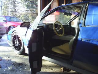

Spring is here yet again. Another year of spending money, and doing something different. Since I plan on making the 25th show with a "finished car" (Cross your fingers!) I'm going to push the envelope on getting my 87GT out of the garage.
Heres where we left off...
The drag radials are obviously just sitting next to the car, I need to find out if I can use them on the fiero even (The tires , rims are 5x120.7 from my 87 GTA Trans Am.). 275/50R15 BFG. I have 18"s for the rear, but they take forever to get here from japan! I hope to have them in by next week (been waiting since dec!) I would really like to be able to use the drags for a few 1/4 mile runs.
Incase you've never seen this car, its an 87GT with a 94' 4.6L Northstar
I'll be working on the interior a little bit today, hopefully at least organize things a little better and get the console / seats / wheel in.
Thats it for now, expect some more pictures a bit later.

That's a most excellent console ya got there. Wherever would one get such a piece?

It is a good looking piece... It'll be a little better looking once I'd modified it a little bit though.

Originally posted by j hood:
concept fabrications- sick ideas for your sig.
fiero is coming along nice. liking the wheel set up!!
the reinforcement you put in on either side, is that not going to get in the way of any part of the northstar?
looks good!
Thanks for the kind words! I'll be running the intake pipe through those panels, so I'll have to alter them for various things when everything gets installed. I want to keep it pretty clean though.

Do the sterring wheels come in different shapes and color combinations, like in a "D"-shape with red/black colors?
Custom2M4
Posts: 4414
From: Winnipeg, Manitoba Canada
Registered: Sep 2004
Total ratings: 114
Report this Post03-19-2008 09:56 PM Click Here to See the Profile for Custom2M4Send a Private Message to Custom2M4Edit/Delete MessageReply w/QuoteDirect Link to This Post
No, sorry curly. That steering wheel is only available in that color. It's a replacement 78-82 Corvette wheel *6 bolt*. It was actually kind of a pain matching up a hub / horn that actually fit the wheel. But luckily it was all available to me.
