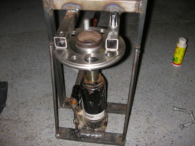

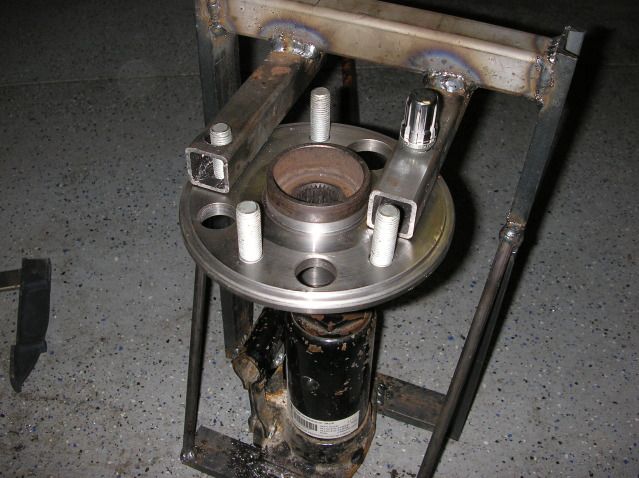

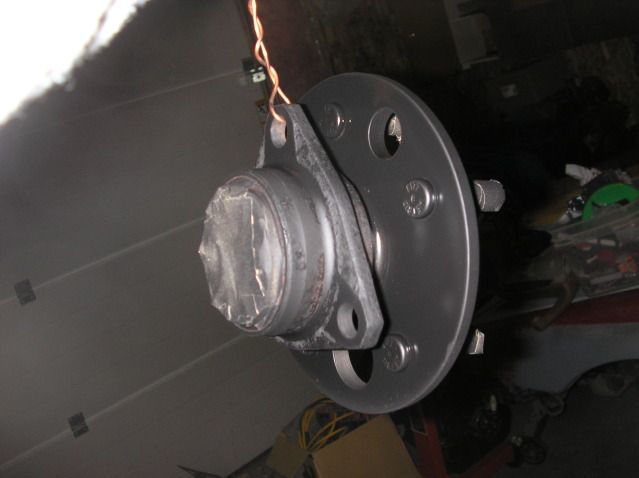

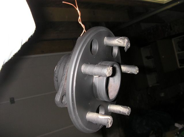

Heres a better update. I've been working on my house lots as of late due to the baby on route in 3 weeks. So I haven't had any real time to update this. But for anyone still following, and curious about my 5x114.3 swap.. Heres some finishing updates.
My homemade stud install jig.
My custom rear hubs. Costed close to 600 dollars by the time I was said and done for this set. With a brand new machined hub flange welded to the factory splined hub, balanced and cleaned up. Then rebuilt / packed with the factory bearings.

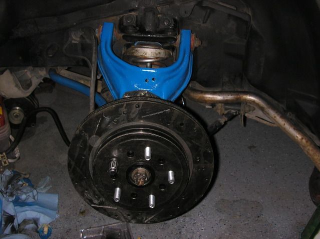

And the completed fronts. Costed me about 100 dollars for the pair. With a new flange made, welded, drilled, cleaned up and studded (extended studs).
I hope to have more next weekend to post up. Enjoy.

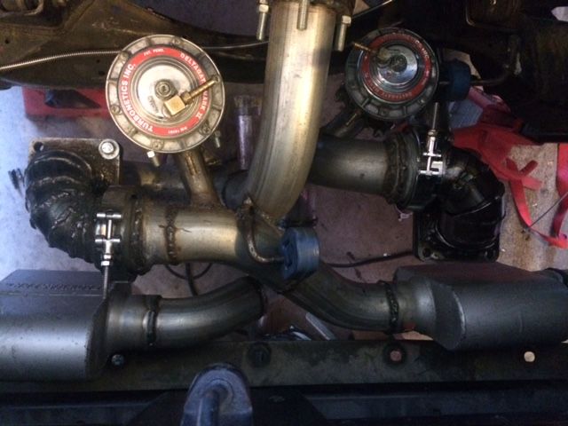

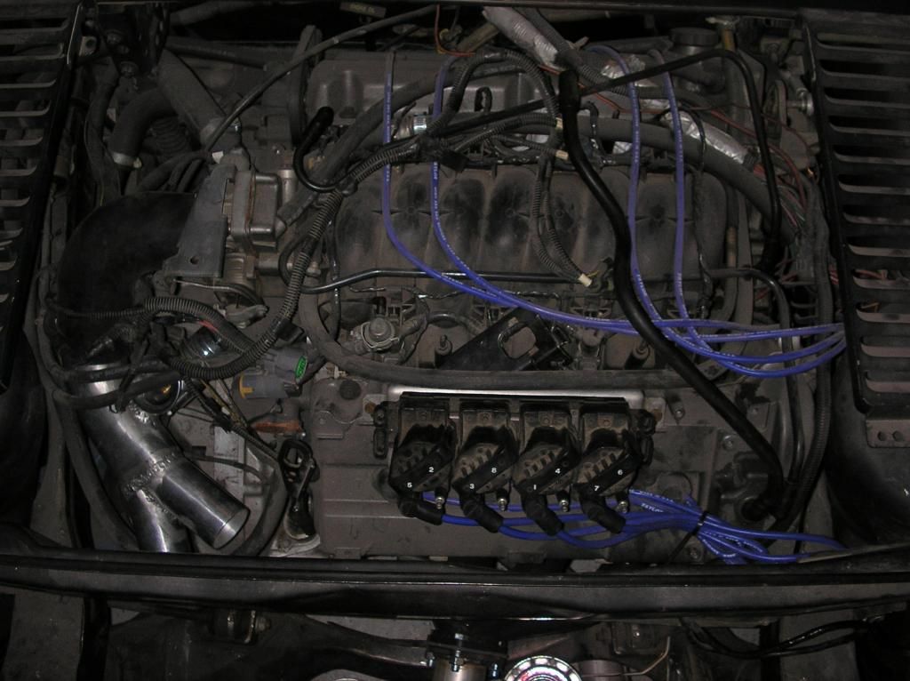

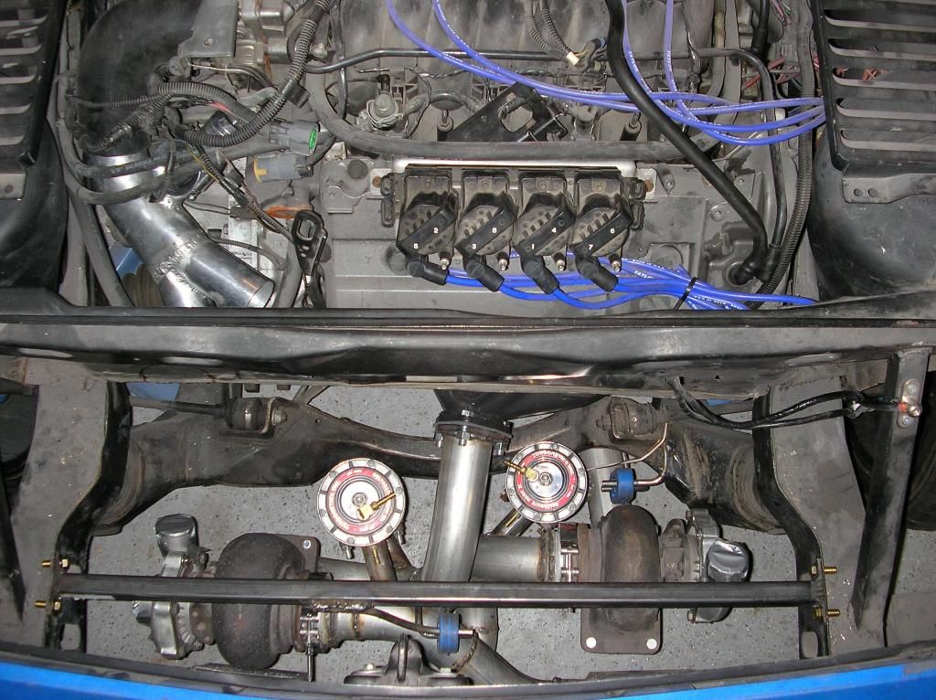

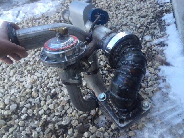

Update!

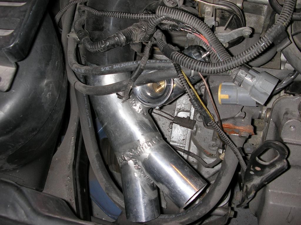

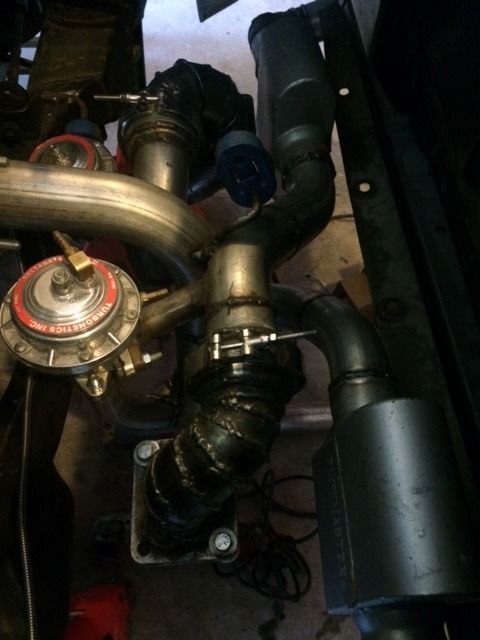

Heres the hot side, I think I'm still going to change out the wastegate pipes for larger, but they are okay for now. I also have a couple more support hangers to build in order to hold all this together.
Heres how I did the cold side splitter;

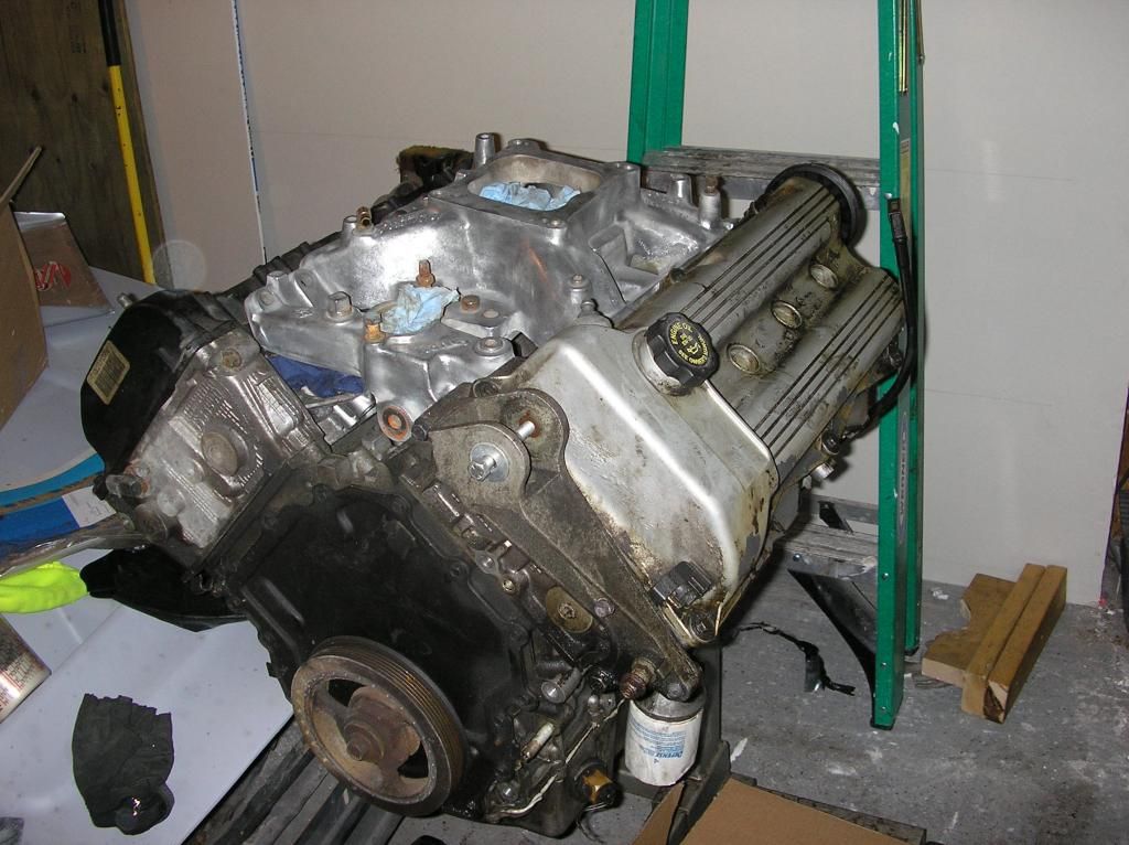

Cleaned up the spare N*

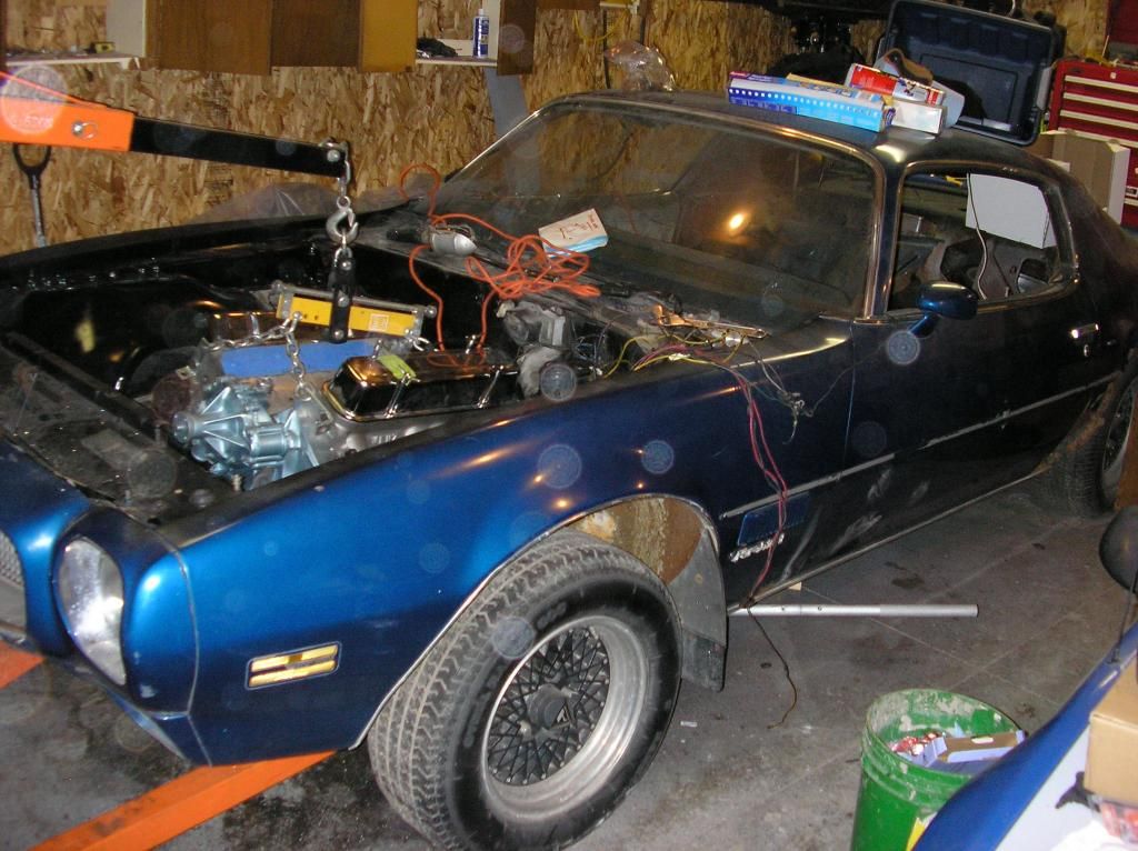

Just finishing up on the motor for my 71' Firebird, 400ci pontiac 448hp, 460ft.lbs

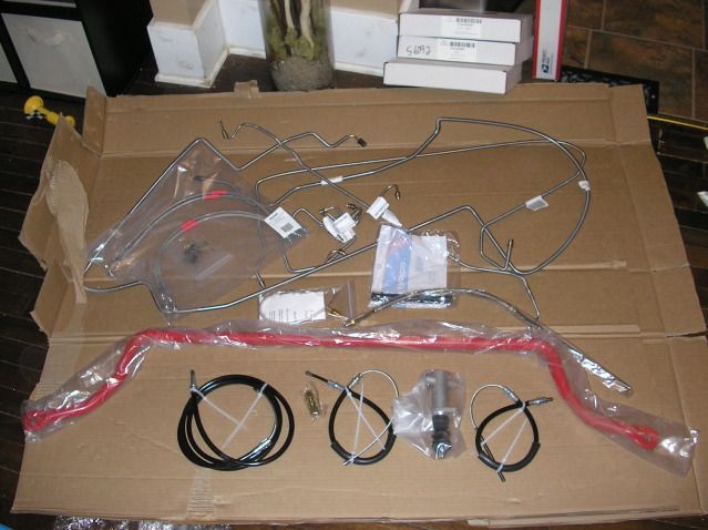

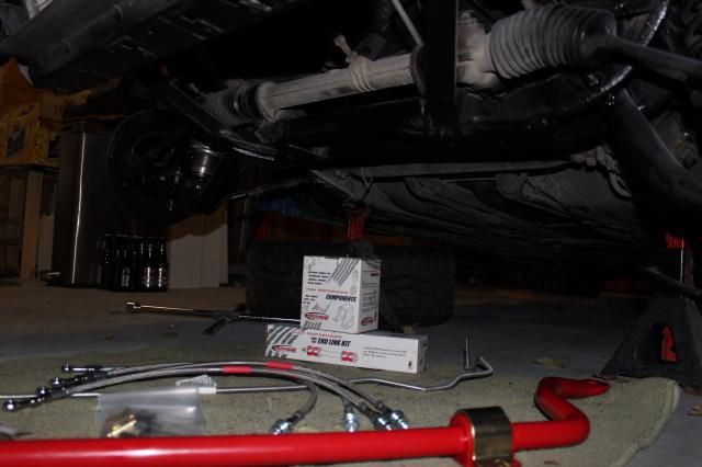

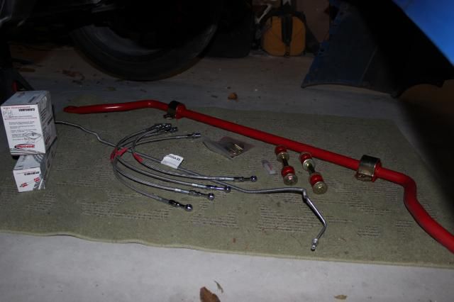

Packages Arrived!
Another awesome transaction with rodney dickman and the fierostore.com.
All new brake lines
SS brake hoses
All new ebrake cables, and hardware / adjusters
Aluminum Slave Cyl
New slave clutch line
One man bleeder kit
and a 1" upgrade front sway bar.
Sweeet

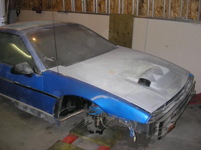

Doing some sanding / blocking lately.. Lots of blocking..

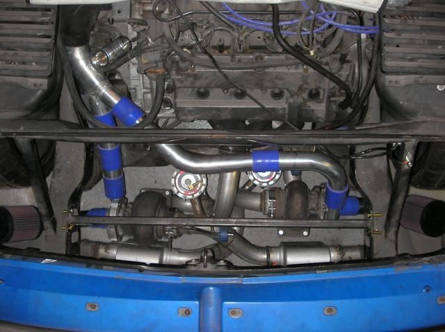

Here is the finished picture of all the turbo plumbing.. Including the air filters.
I just made an order for a blue 3" 90' for the intake, as well as the flanges and parts for the turbo oil lines. She should be all buttoned up mechanically really soon.

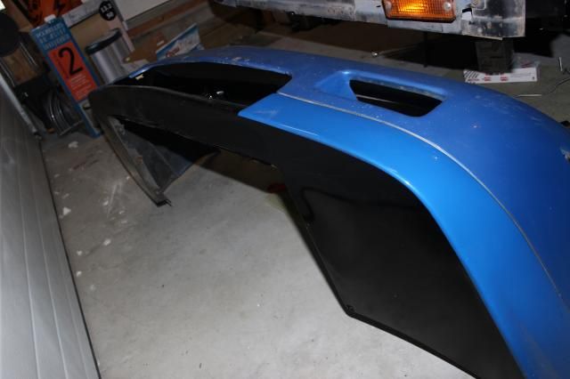

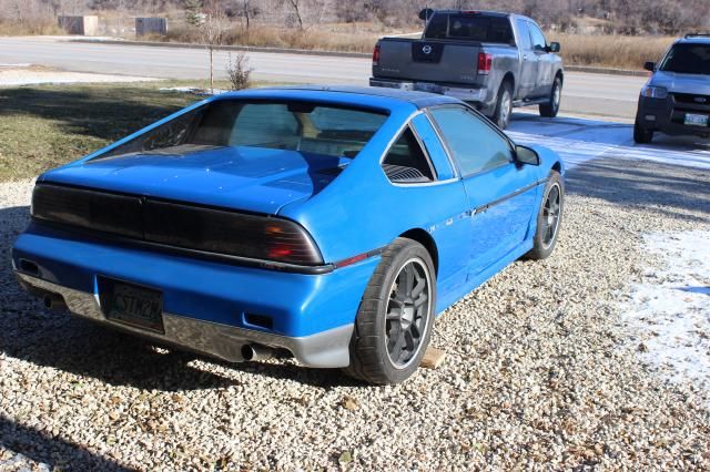

Report this Post11-10-2013 01:49 PM Click Here to See the Profile for Custom2M4Send a Private Message to Custom2M4Edit/Delete MessageReply w/QuoteDirect Link to This Post

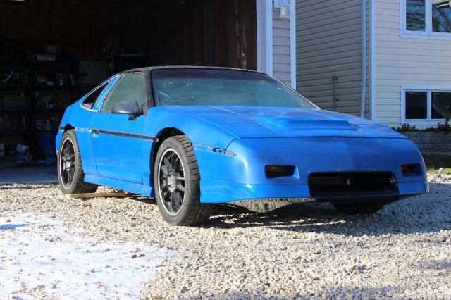

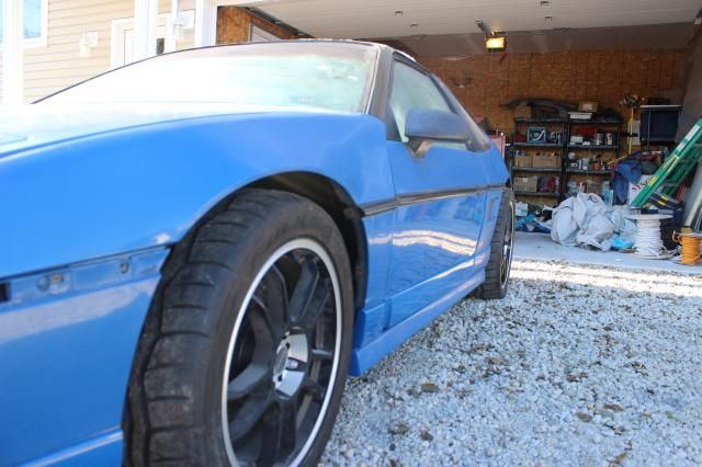

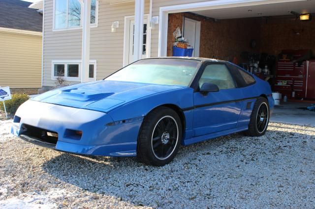

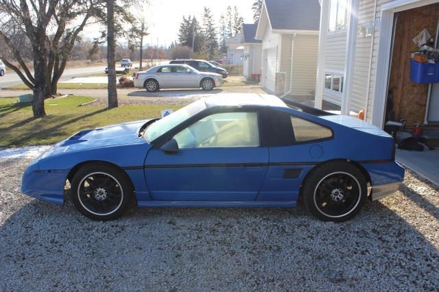

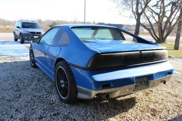

Wow, been a while since I've updated. I just recently moved, and didn't have the internet for the last couple months. So here's the newest, pictures and all.

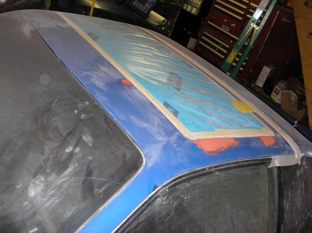

-I painted the roof black,
-painted almost all of the lowers blue, the hood,
-black valance in the front,
-worked on the interior a little more.
-Not much on the engine, other than totally finish the cold side,

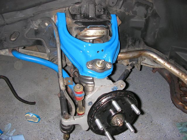

-Re-installed the stock front spindles, painted and refinished the front end,

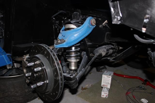

-Installed my 11.25 brakes in the front (still have to install the brake lines),
- Installed new ball joints and tie rods where applicable.
-Removed and got ready for new upgraded sway bar and links. (didn't want overspray)
-The wife is pregnant, having another baby, still not selling the cars.
-And then ran out of paint and didn't have enough to finish the rear bumper valance. Oops.

Let me know what you think of the black two tone. I still want to do a black insert in the widebody on the doors when that gets completed.

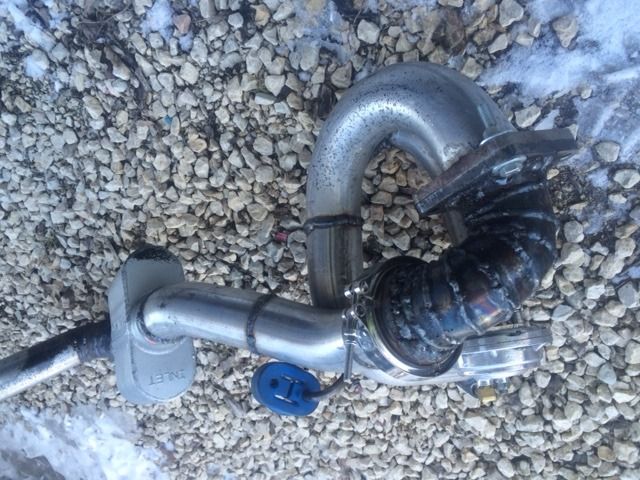

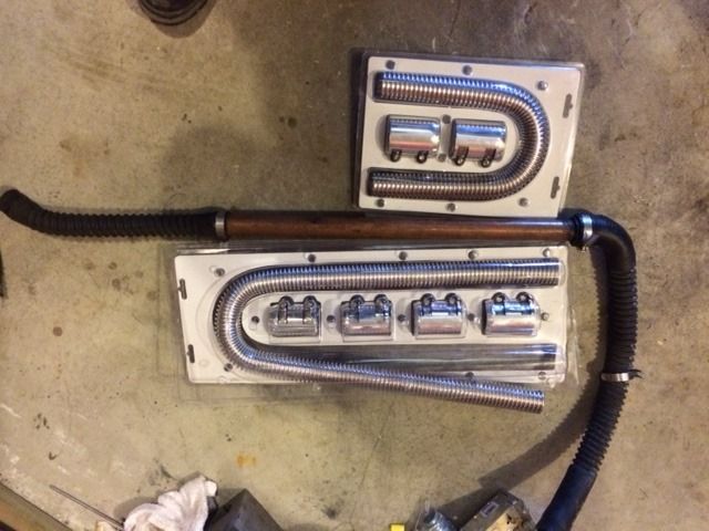

I decided to take it easy on my Getrag 272, and I built these turbo deletes this weekend. It will allow me to drive the car N/A for a while, so I don't nuke my transmission right away. Later in the summer I'll put the turbos back on, and have some fun. See how much abuse that 272 can actually handle.
Heres an update. Just started back up on the car this year, started her up, going to change all the fluids (brakes to DOT4), coolant, gas, oil, trans oil. I just finished changing the coolant pipe from my rigged up feature (copper pipe and hoses) to a stainless flex line (the one pipe is 6' long so I have to use two kits). I'm also going to start building up my trans (F23), I bought a crate trans as I said above, and I have another one I'll be picking up in the next couple days for a bellhousing. It'll be taken apart and cryo treated and the new bellhousing installed. I won't be actually swapping it over until fall (id like to drive the car as is for the summer).
I'm also looking at sending out one of my motors to northstar performance which is only an hour and a half from my door, and having it built up a little and studded. That way I can swap it in at the same time as the trans swap in the fall.
I'm also looking at a Lokar throttle cable to replace my slightly short one (annoying), and also getting my ebrake handle moved and operational.
So thats what my year for the fiero has in store! Once I get my new engine and trans installed, I'll be taking it to a dyno tuning shop to get a good base tune for the turbos, and im curious as to how she will do! I'll see about posting a video of the car running, as these super 10 flowmaster mufflers sound outrageous on this car! Please feel free to comment!
