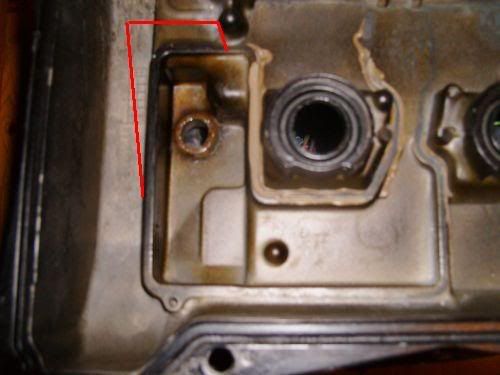

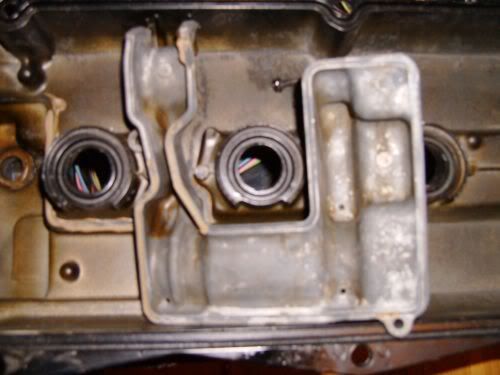

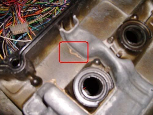

Report this Post03-04-2008 11:09 PM Click Here to See the Profile for AJxtcmanSend a Private Message to AJxtcmanEdit/Delete MessageReply w/QuoteDirect Link to This Post
AJxtcman
1098 posts
Member since Nov 2006
Hey this is a picture of the valve cover. It is not your problem.
Loose sealer
Lack of RTV and you can see that it had been sucking in oil.
The baffle

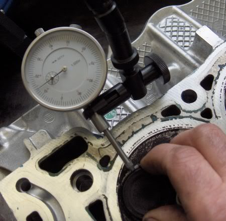

Well, I just took the heads apart and measured the valve guide clearance and they are perfect. With the valves in the head I siliconed a plate with a barb over the intake and exhaust ports of the cylinders that were burning the most oil. Hooked up my vacuum bleeder and there were no signs what so ever of any leakage past the valve seals or guides. I did find out why #6 had low compression duing my compression tests though. One of the exhaust valves wasn't sealing very well. I had ground the valves and seats so it shouldn't have leaked but i'll relap them and test them before i put it back together. I had ordered a set of pistons from Ontario Reman because they had said that they were in stock in their state side branch. It turns out they were wrong so now they're factory back ordered. I have no idea when i'll get them but hopefully they'll come before the summer is over. If the oil burning isn't the rings than i'm completely stumped. The only places where the engine can really burn oil is either through the rings, the valves, and the PCV system. The valve guides are right in spec and the seals are brand new and sealing great. After pulling the PCV valve out of the valve cover and looking down into the baffle while the engine was running it was totally dry, so it's not the PCV. The only thing left is the rings. The pistons were pretty sloppy, i could rock them back and forth, so it needed new ones anyway. The ring gaps on the new rings were .025 which is double the spec but i've never seen large ring gaps burn oil like this. I'm still stumped but i just hope it's fine when it goes back together this time with new pistons and rings.
