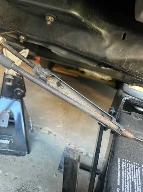

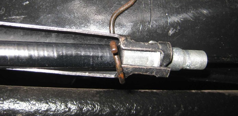

Hi - I have found that the passenger side brake cable had seized slightly - so I have sorted the cable out But------------- Has anyone got any pictures of the Equaliser in position - More importantly of the Tang that holds the cable in position.
Unfortunately on the front page of this forum on adjusting the e brake topic the pictures have gone so I cannot see how the cable is seated with the Tang in position.
Many Thanks in Advance
Jon

Thank you vintage nut - I don't suppose you have a pic of the other side showing the Tang ?
I am looking to see how the passenger side cable sits with the Tang in position.
Jon

I'm searching photos for you...this end?
PS - The year?
I'm a '88 guy...
https://www.fiero.nl/forum/...090907-2-094490.html
E Brake Cable Routing - 1986 SE
https://www.fiero.nl/forum/...110502-2-097704.html

jon m
Posts: 1202
From: ENGLAND
Report this Post10-08-2025 11:31 AM Click Here to See the Profile for jon mSend a Private Message to jon mEdit/Delete MessageReply w/QuoteDirect Link to This Post
Many thanks for your help - Much appreciated
As an update - in the last 1/2 hour went to the car and the dreaded tang snapped off - Bugger
However as I live in the UK - when I order parts I always get a couple of extra items and fortunately I had a spare in the bag GM equaliser.
that said I Tried adjusting and only the passenger side is locking on - So I am thinking its the lever arm on the drivers side that maybe out by a quater turn.
which I will post another thread for this
as I said Much appriciated
Jon
