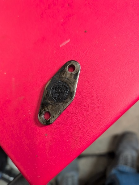

Today so far I was able to remove the upper intake manifold. While doing that I discovered that the EGR plate on the intake manifold (not the exhaust side the side near the throttle body) was completely jammed up, like no way anything was getting through that. I broke through it and will soak it in some degreaser to clean that up. Its not tuned for an EGR delete so I'm sure that wasn't great, but I don't think causing anything too serious.
Other than things are going OK so far, just slow. Even after getting all the bolts off the manifold I'm surprised how hard it was to break loose.

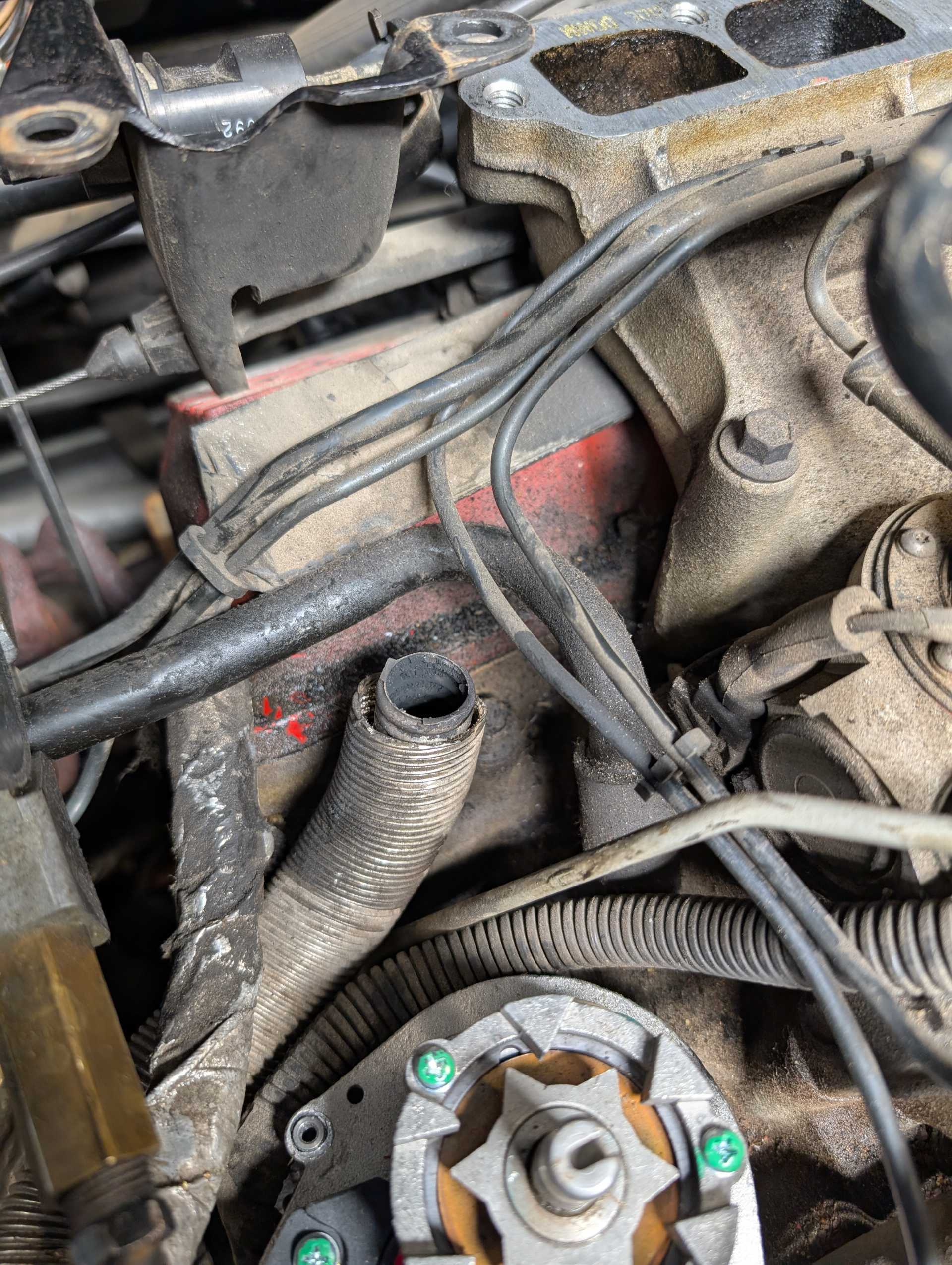

Im starting to think this was actually the tick.
As I looked again at this plate and the EGR tube that's not supposed to come apart.
Looks like it jammed up then busted loose, then once the EGR opened up I bet that pips is bouncing around against the plate and manifold.
Didn't cause a vacuum leak because the plate was so jammed up.
That would also explain why it would get better with some RPMs, the more exhaust volume probably pushed it away from the plate more.
That also explains why I was burning through ICM's as it was dumping hot exhaust gas right by the distributor causing even more heat in that area.
Whats everybody think? Was it that simple or do I need to get into the listers/rockers still?

Replace the broken EGR Tube and then test....
Rodney still have them:
https://rodneydickman.com/p....php?products_id=314
https://rodneydickman.com/p....php?products_id=308

What the heck is a "pips"? I can't say I fully understand your explanation.
If it was me, I'd replace the EGR tube, put it back together, and see if the problem's been resolved.

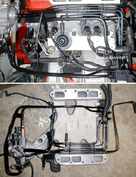

Since you removed the upper plenum, this is the 'perfect time' to check on the plastic vacuum pipes under the manifold, especially the EGR valve vacuum line as the exhaust 'cooks' the plastic.
These plastic vacuum lines can lose strength from prolonged exposure to high temperatures making them brittle and prone to breaking.
Both Rodney and TFS sells metal vacuum lines to replace the factory lines:
https://rodneydickman.com/p...o.php?products_id=86
https://www.fierostore.com/.../Detail.aspx?s=52389
Merely A Thought...
PS - IF you decide to replace the plastic; my suggestion is to use the factory ENDS as the metal tubing doesn't allow much moment when assembling the upper plenum.
[This message has been edited by Vintage-Nut (edited 10-27-2025).]
