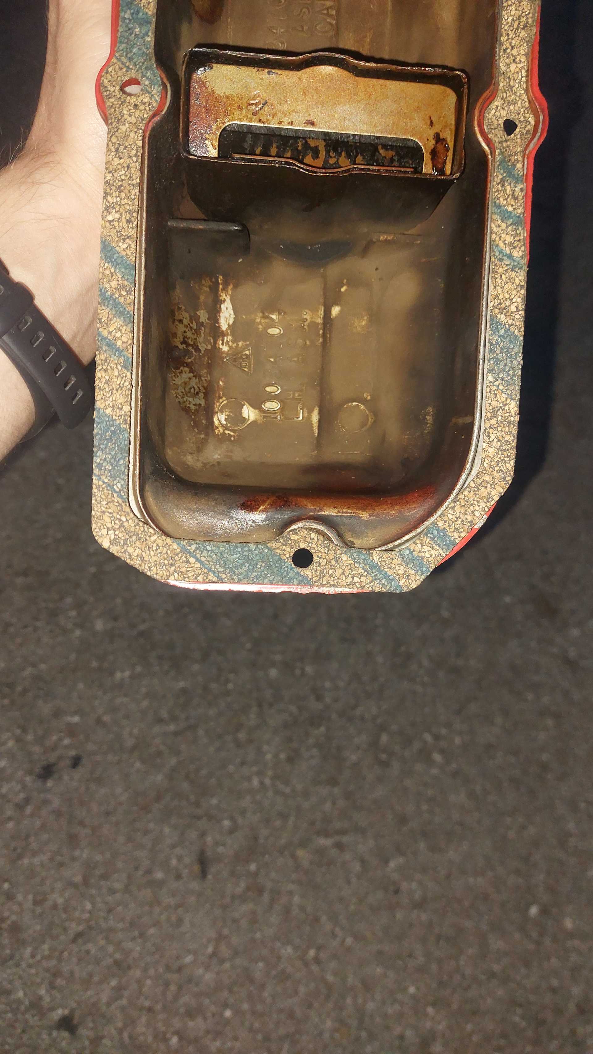

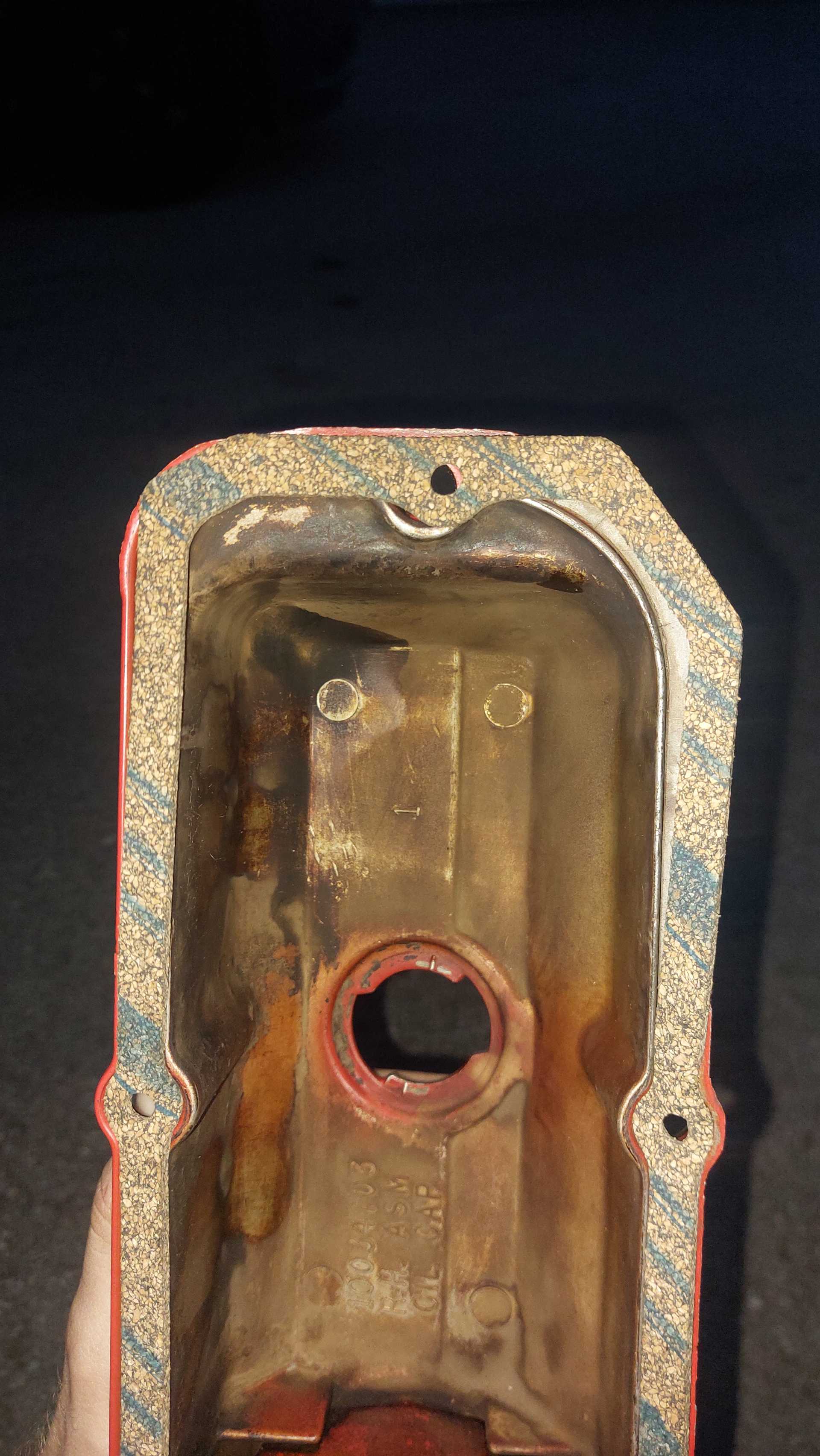

Can anyone please tell me what this gasket is? Does it always look like that? It is from a original Fel-Pro Gasket set, should I cut the gasket so it fits or somehow press it in? Has anyone else had this problem?
Any help is appreciated!

Report this Post07-27-2024 05:51 PM Click Here to See the Profile for pmbrunelleSend a Private Message to pmbrunelleEdit/Delete MessageReply w/QuoteDirect Link to This Post
Those flat cork gaskets are meant to be used with the stamped steel valve covers used on other GM 2.8L V6 engines. The flat cork gasket is meant to seal against the flat flange of the stamped steel valve cover.
The Fiero 2.8L V6 uses a special cast valve cover, with a groove for the rubber seal. The flat cork gasket is not compatible with the Fiero valve cover.
You need the FEL-PRO VS50077R gasket set which works with the special cast valve cover.

Cruzenoob:
What Fel-Pro part number?
My full gasket kit for the '85-'88 GM / CHEVROLET V6 2.8L - 173 MFI Engine came with TWO PAIR of valve cover gaskets: Cork AND Rubber {silicone}
Obviously to me, I used the 'rubber' set with the 'special' groove and tossed the 'flat' cork pair in the garbage.
As pmbrunelle said very clearly with a Fel-Pro part number; get the 'special' rubber/silicone valve cover gaskets and throw out the cork.

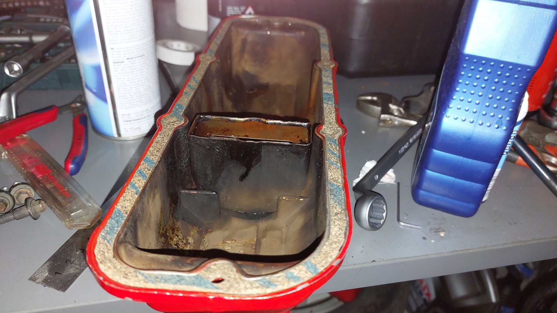

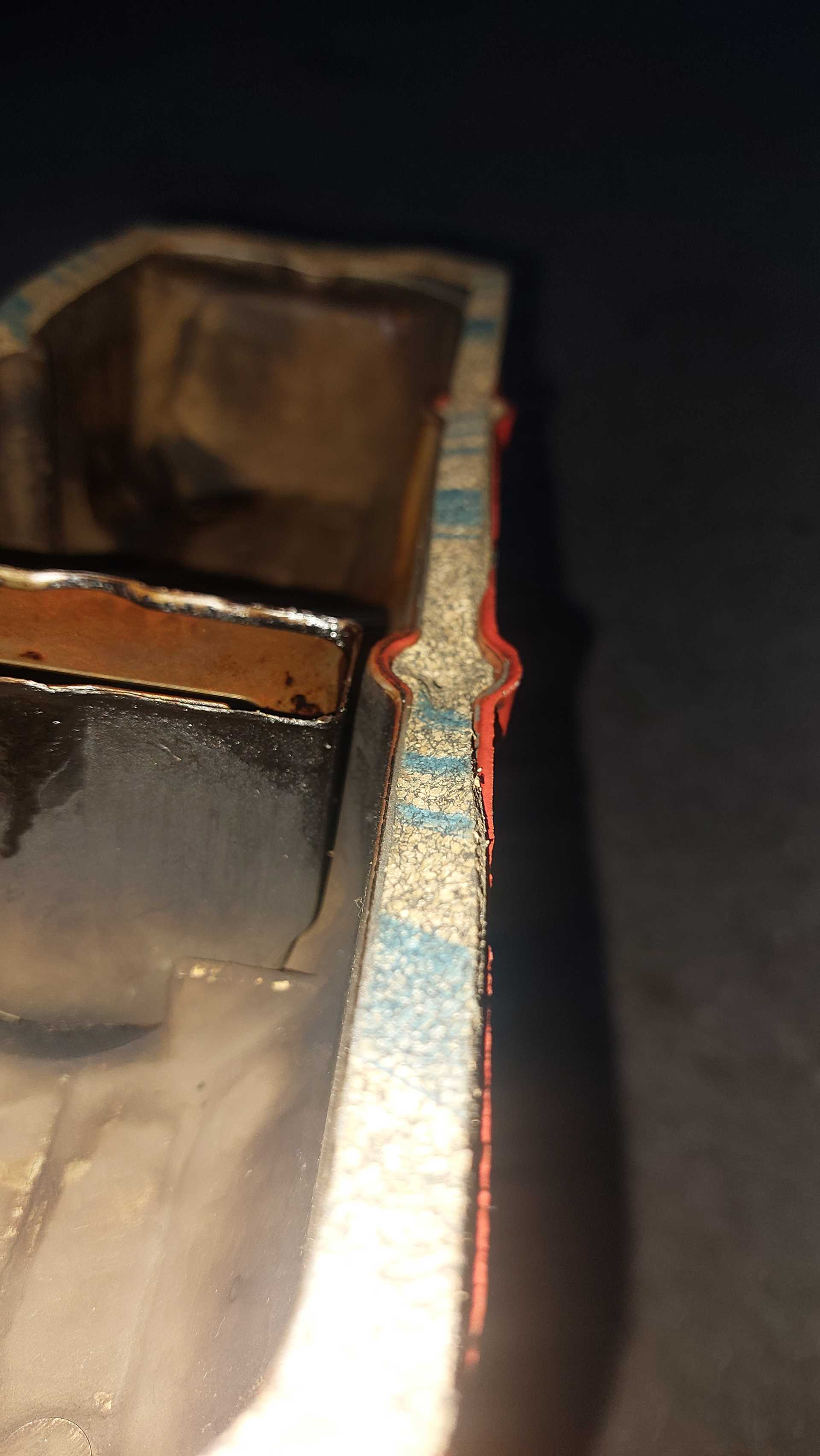

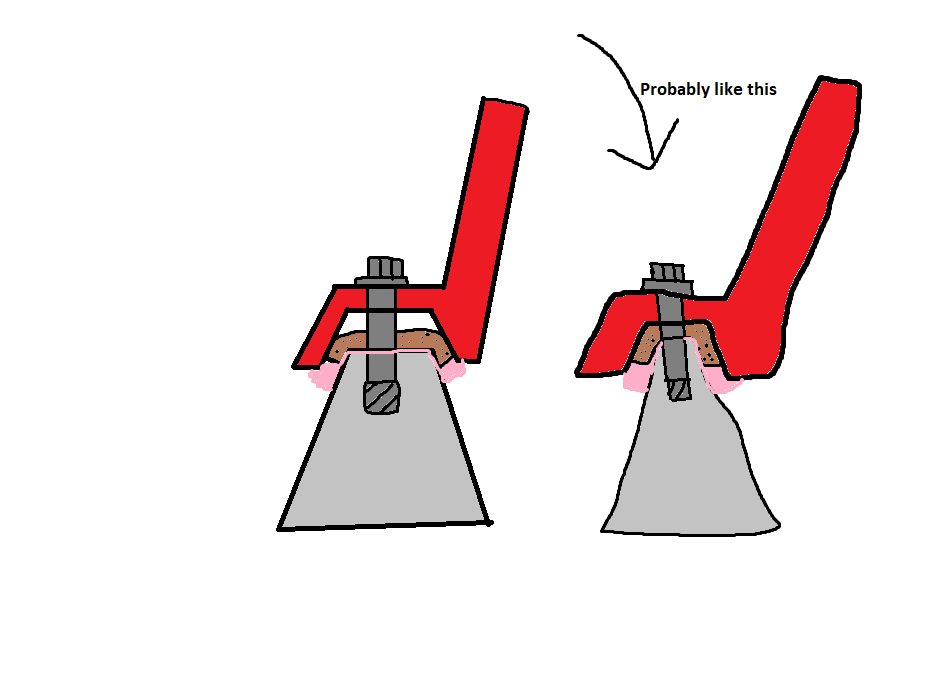

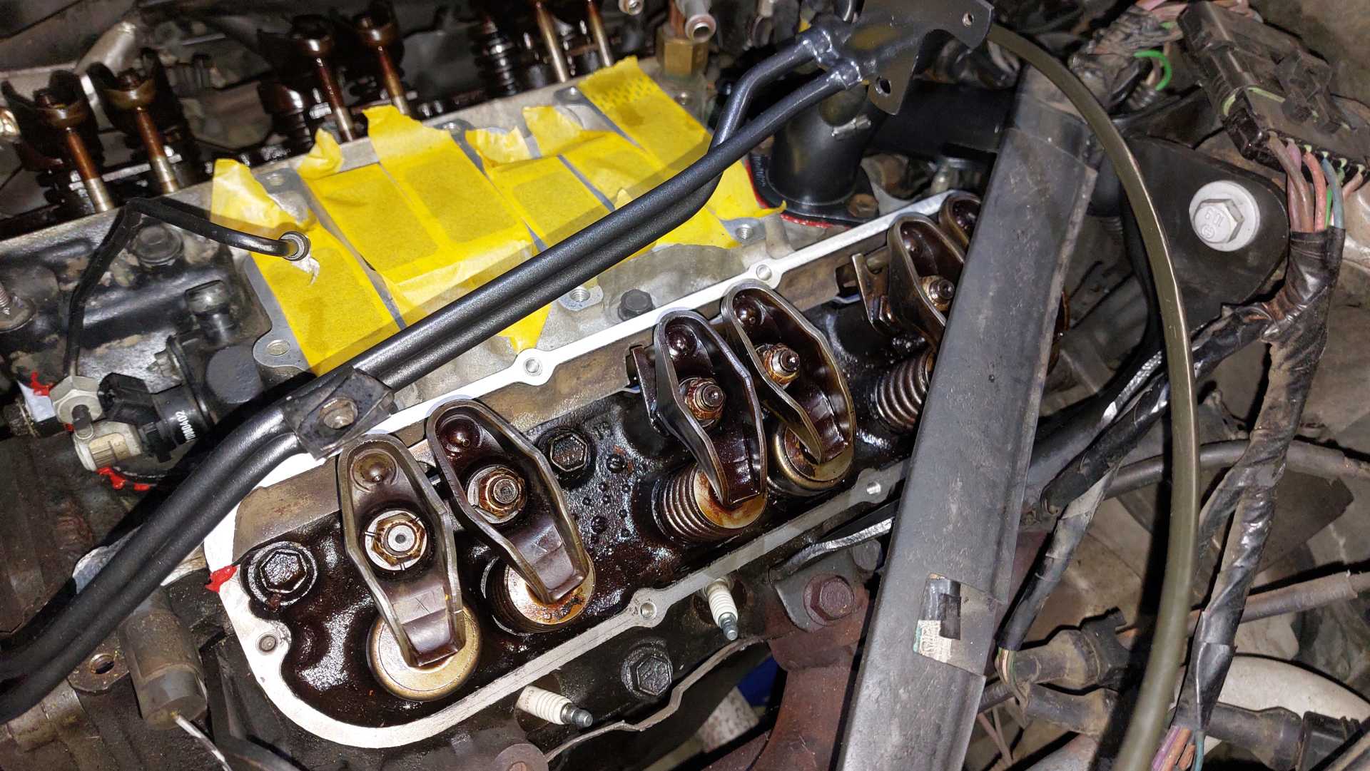

I did read it, and I get it there is a groove. I would never be able to put it inside unless I cut it carefully. It is not normally made for it, but what I want to know is WHY won't it work. Is it the material? I cut it in shape and applied a small track of high temp gasket silicone on it. Because the cork is compressable and it fills so little gaps, wouldn't it be good because the surface where the valve cover gets put on will squeeze it and seal everything?
This is the worse looking one, I guarantee you the gasket for the valve cover in the back sits perfectly inside the groove

Normally I would say "Try it out. What's the worst that could happen, a little leak and you have to redo them again?)
But then I always remember the front cover sits nicely over the exhaust catalyst so any major leaks could end up with a fire.

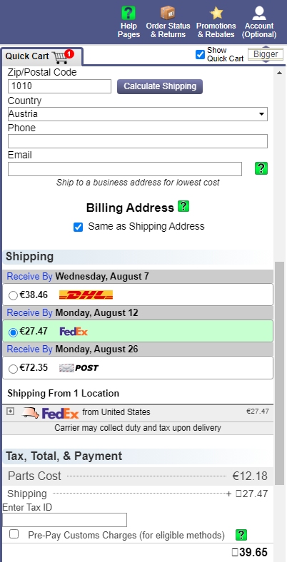

Originally posted by Cruzenoob:
I can order a new pair, but it takes time again and from Rockauto to my location it will be around 60€ just for the valve cover gasket. (Keep in mind for our standards that is a lot of money)
So you're saying the shipping fee to Austria is €47.76 ($51.86US) for a set of €12.24 ($13.31US) valve cover gaskets?

From what I remember doing mine just a few months ago, the head sealing surface is flat, with a groove on the valve cover, the rubber seals look like an upside down T , the point to go into the groove, and a flat base to extend out between the edge of the groove and the head (I can see the blue of the rubber gasket showing all the way around between head and cover with my engine assembled). With those cork gaskets, it would pinch those down a little (likely not enough to seal) and be sitting metal on metal between valve cover and head. Furthermore the bolts used have built in spacers, which won't let the covers be over torqued, also means without the added height of the rubber gaskets, they will be loose.
The cork gasket cannot function because there is a groove in the valve cover.
A gasket needs to be squeezed on both sides to seal. With the groove, the gasket is not squeezed.

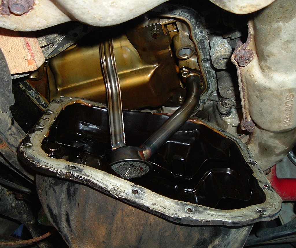

This is a photo of the original oil pan coming off my Subie. You can see grooves in the oil pan. The new pan has them as well. Are there any "dead end" areas evident here? How does this differ from a valve cover? I'm genuinely interested!
CLICK FOR FULL SIZE
[This message has been edited by Patrick (edited 07-29-2024).]

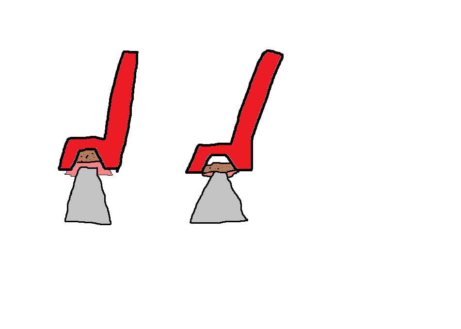

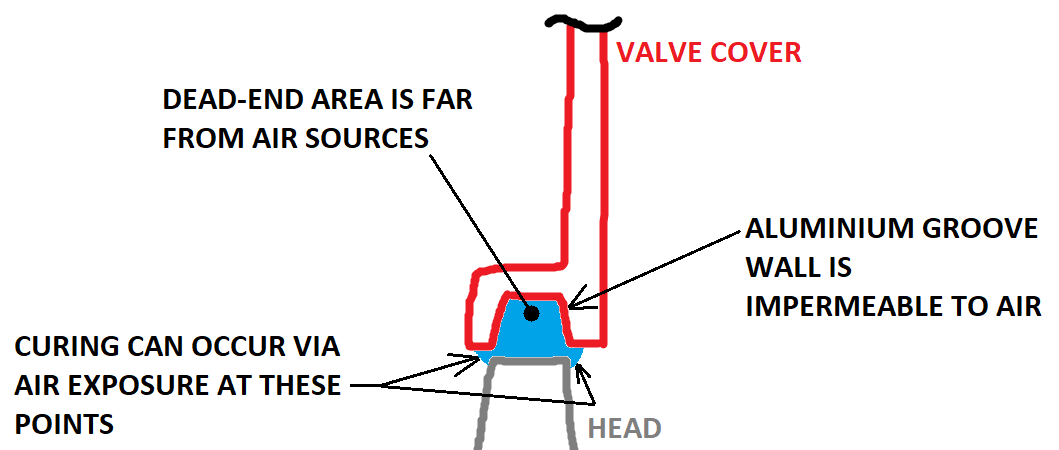

Here is a picture to explain what I mean by dead end:
RTV itself becomes airtight as it cures, so as the outer layer cures, it makes it harder for the inner parts to cure.
Here is the datasheet for Loctite 5910, a flange sealant I am familiar with that can be used for this sort of thing.
On the first page of the document is a graph showing how the "Depth of cure" varies with time:
https://datasheets.tdx.henk...TE-SI-5910-en_GL.pdf
There are some slight debossed regions in the sealing flange; in the event of crankcase pressure, this makes it harder for the pressure to blow out the RTV; the RTV that flowed into the debossed region acts like a key which locks it in place.
These debossed regions appear shallow to me; they don't have the depth of the Fiero valve cover groove.
CLICK FOR FULL SIZE
Does the valve cover actually sit way above the head like that, or would it sit more like the following image? (The use of non-factory valve cover bolts without the shoulder might be required if RTV was to be used.)
pmbrunelle
Posts: 4661
From: Grand-Mère, Québec
Registered: Sep 2008
Total ratings: 63
Report this Post07-29-2024 08:35 PM Click Here to See the Profile for pmbrunelleSend a Private Message to pmbrunelleEdit/Delete MessageReply w/QuoteDirect Link to This Post
I drew the valve cover position roughly as it sits with the rubber gasket.
I'm not sure how low the valve cover would go without a rubber gasket; my memory is insufficient.
Patrick... I don't understand why you always question everything. I see on many posts people ask for help and you just comment anything, no offense, but yes... shipping a pair of gasket around the world costs money...

Thank you, that's a solution I was thinking too, but then I decided to put high temp silicone on the surface where the gasket will sit on, the there's the cork gasket stuck inside and on bottom will be silicone to fill the remaining gaps. I just saw 2 days ago a german us oldtimer shop sells 2 sets of the proper silicone gaskets for like 7€ per set (which is very cheap and for around 25€ shipping fee on top, the last 2 sets) If the cork fails, then I'll be able to change them with proper ones.
See photo what I mean the Area (I don't know what you call it in english)

RTV cures with exposure to air. When a bead is thick, the RTV near the centre can only cure by breathing through the thickness of the RTV surrounding it. In general, there is a maximum joint thickness that is recommended for a given RTV product.
In this case, in the groove, there is a "dead end" of RTV with little air exposure. This area may not cure properly.
A joint that is designed for RTV will not have a dead-end like this.
RTV on the Fiero V6 valve cover remains a "Mickey Mouse" solution; I suggested it as the least bad alternative that OP can try since using the correct gaskets appears to be a no-go.
Hello pmbrunelle, I was thinking the same, here is a selfmade illustration I am also not 100% sure how it seals it. I know what you mean by not sealing in the center cause the outside will harden and the inside remains soft, but I think for that to happen it's kinda unlikely, since that silicone layer is not that big and I let it cure for more than 24h atleast.
I did put some "RTV"? (temp resistance silicone on the gasket surface before placing it.
Do you maybe know how it seals it from oil, is it like oil splash or will the valve cover be filled to a certain point with oil? Because if it just splash and not pressurised oil shooting out I think it might be fine.
Or I think it is more likely looking like this:
And it would necessarily be €47.76 ?
I often ask questions to dig a little deeper into what's been mentioned, much like I tried to do immediately above. It only took a few seconds to discover that there are shipping options less expensive than what had been previously discussed.
