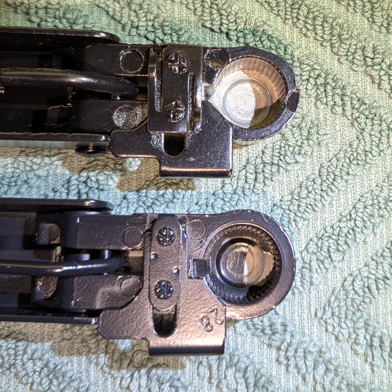

Here's the photo. Again. It's obvious why the parts that I had would not work. I was not the only one.
I don't know what your problem is that you keep saying people were too stupid to install wiper arms. It's pretty insulting and misleads new people in the community.
https://www.fiero.nl/forum/...ML/101621-2.html#p52
Originally posted by Will:
The Fiero wiper blade is on the right.
As you can see, the splines in the Fiero wiper blade's socket are MUCH deeper than those in the truck wiper blade's socket.
Even though they look close... even though the both measure 0.620" ID, the new ones don't work because the splines do NOT engage.
ETA: I'm willing to try this again... Maybe I got dud parts; maybe only the Dorman parts have the right spline
Continuing to lie and insult people about whatever this controversy is doesn't help anything.
ETA2: RockAuto has GM Genuine left wiper arms in stock, so I ordered one of those and one of the Dorman lefts, so we'll see if it works, and I'll document any differences.

The date on the post I linked above, which is where I originally posted the photo that clearly demonstrates why the parts I bought didn't work, is 3/29/2014. That's been up for 7 1/2 years.
If you don't see the photo of the parts, I'm sure we'll all be willing to pitch in to get you some psychiatric help.
Edit:
Is there an explanation? Of course there is. As I mentioned above, maybe only some manufacturers used the right spline. Maybe a batch of parts with the wrong spline came out of China. Whatever the cause is, my photo demonstrates that the problem is with the parts themselves. I really don't have a problem with finding different parts that work, as long as the reason the wrong parts don't work, as well as the specifics of the parts that do work is documented.
Looking at that photo and continuing to maintain that people are too stupid to install wiper arms correctly is a genuine dick move on your part. Fess up and we can all move on.

Will's photo showing the different splines is overwhelming evidence that (some/all?) Dorman/Motormite wiper arms don't work, yet you have never directly addressed that photo. Instead, you choose to skirt around discussing that evidence (the photo), and change the subject...
How did I not address it? What part of 'some parts may be defective or the installers are defective' are you having trouble comprehending? While the splines look smaller on the new part, the diameters appear to be identical, and the splines are either defective, or it's an optical illusion due to lighting (even modern cameras have trouble photographing objects that small).
We've disproven this theory by the fact that dozens of people have tried this, and it worked. The fact some people have had difficulty, as I stated several times above, means there may be defective parts out there, or people that can't figure it out.
So here's the deal: I have NOTHING to defend. Either you retards post overwhelming proof of it NOT working, or SHUT THE **** UP. I'm done. Again.

7 & 1/2 years
It's obvious from looking at the photo that the splines that drive the stock Fiero arm will not drive the parts I received.
Other people have had this problem too and from you only received insults about their ability to install wiper arms.

sorry for the thread revival, just wanted to catalog my 2025 findings and didn't want to gate keep.
it appears that most have already discovered that the Dorman parts (42579 and 42580) are currently rubbish due to them not actually seating properly on the posts. i can't say if this has always been the case, but clearly something changed over time and they became unusable. i can confirm this for 2025 after having just purchased them.
however, some people had mentioned having better success with ones from Chevy trucks. i gave that a whirl right after the failed Dormans and it was a success. you will want original GM Genuine parts 15043063 and 15043064. i got mine off amazon, but i think RockAuto has some too. now on to the comparison.
Dorman on top, GM original part on bottom.
the Dorman (for whatever dumb reasoning) appears to have shallow recessed slots, which basically makes the majority of the visible surface area flat and incapable of gripping onto the splined post. i doubt these would work on the Chevy trucks either. when i installed these they simply shook loose and fell off.
the GM originals have pronounced raised teeth, allowing them to grip onto the splined posts really well. when i installed these, they firmly walked onto the post and required medium effort to dislodge again. the GMs also come with J hook design and can lock upward (with your hood up) just like the Dormans.
