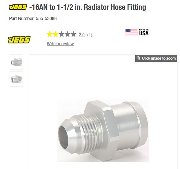

Out of the water pump blocking plates with the NA fittings how are you making the transition from an NA fitting to the stock cooling system?
Are you using something like this?

Nope not that kind of adapter. See my picture above showing the remote thermostat.
1. The inlet to the water pump is from the bottom of the radiator with the usual fiero lines and custom/cut radator hose.
2. The outlet from the water pump goes to the TOP fittings of the blocking plates using AN hose and fittings.
3. The water outlet from the engine, from the BOTTOM of the blocking plates, go to the remote thermostat housing.
4. Regular rubber radior hose goes from the "goose neck," on the remote thermostat, plus Fiero lines to the top of the radiator.
5. The heater core hoses attach via T-fittings. From thermostat housing to core, and return from core to water pump inlet.
[This message has been edited by cyrus88 (edited 08-31-2021).]

I'm still trying to figure out the connections but I am sure I'll get there.
