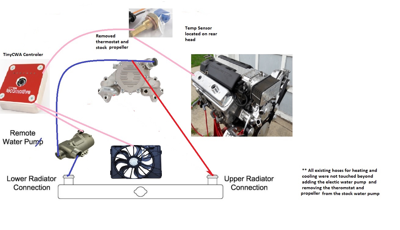

1- I installed it on the head because it is the where the temperature is the highest in the 60*V6 iron head. Tecomotive recomends installing it at the hotter spot.

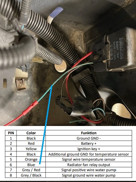

2- I tapped the stock fan relay. Cut the wire that suplies the ground from the stock fan switch. Or you can use a regular relay and pigtail.
3- Since I don't have windows I use that circuit because it is on when ignition is on.

Coolant sensor location
Green/White wire controls the fan relay.

Need a little clarification on the fan wire.
On the Fiero side; CUT the Green\White off the FAN rely , CONNECT to the blue wire on the TinyCWA side?
Yes

Would you post a diagram of exaxtly how you are running your cooling system pluming?
str8maxn
Posts: 303
From: Fontana CA
Registered: Aug 2018
Report this Post04-24-2022 02:01 PM Click Here to See the Profile for str8maxnSend a Private Message to str8maxnEdit/Delete MessageReply w/QuoteDirect Link to This Post
Is this what your looking?
[This message has been edited by str8maxn (edited 04-25-2022).]
cyrus88
Posts: 414
Report this Post04-25-2022 12:22 AM Click Here to See the Profile for cyrus88Send a Private Message to cyrus88Edit/Delete MessageReply w/QuoteDirect Link to This Post
Well I see a big problem with your setup.
1: Without a thermostat in that stock water pump, most of the cold water bypasses the heads and block and goes back to the radiator.
2: According to your diagram, only a small heater hose connection goes to the top of the radiator. You should have a 1-1/4" hose off the water pump goose neck going to the top of the radiator.

Sorry Cyruss88 ... I am do have a 11/4" neck on the stock water pump. With regards to not using a theromostat here are the instructions on the TinyCWA manual .
Use a thermostat or not?
It is possible to use the pump / controller in combination with or without an
ordinary mechanical thermostat.
If you use one just make sure you set the controllers target temperature as
close as possible to the temperature of the thermostat.
(Of course you can play with the target temperature a little for eventually
better cooling results.)
A cooling system with a thermostat can benefit from an even shorter warmup time and a more exact actual temperature.
A system without one on the other hand got fewer mechanical losses but
the actual temperature can vary a bit more from the target you set
I may just need to lower the target temperature.
cyrus88
Posts: 414
Report this Post04-25-2022 02:04 PM Click Here to See the Profile for cyrus88Send a Private Message to cyrus88Edit/Delete MessageReply w/QuoteDirect Link to This Post
The stock LT-1 water pump is not an ordinary mechanical water pump found on the old SBCs.
It needs a thermostat or another way to block the internal passage between the hot and cold. Look up the water pump description on the internet (or run water through a spare/junk one and you will see) .
OK.. what's the recommended thermostat 160 \ 180?
cyrus88
Posts: 414
Report this Post04-25-2022 04:04 PM Click Here to See the Profile for cyrus88Send a Private Message to cyrus88Edit/Delete MessageReply w/QuoteDirect Link to This Post
Use the 180F
