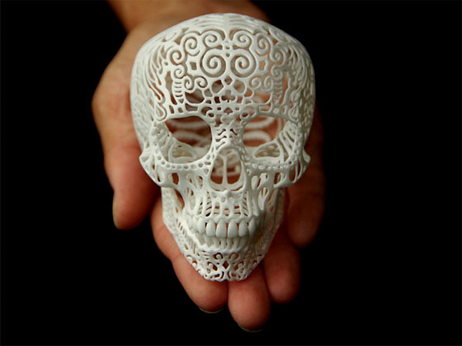

Art is NOT my strong suit, but shouldn't there be imaginary lines to the vanishing point? The far side of the car seems to be bigger than the near side, and something is wrong with the proportions of the rear end.
I tried the FlashForge Pro 2, or some such similar model to that. Mine was a dual extruder. The software used to create the object is very important. Then there is the slicer software, which needs to be good. The printer surface needs to stick, and everything must be lined up correctly as far as the bed and extruder heads. You have to use the right filament type (quality), and the right temperature for the filament. Then wait. Then there is the removal of the printed object. I ran a job that failed more than 30 days into the job.
In our office building, one of the tenants has a 3D printer that will print a life-sized person--as long as you hold your arms by your sides. Who would wait that long?
