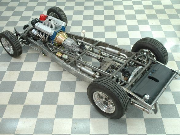

If you really do want to do it, you'll basically have a slightly shorter version of this:
CLICK FOR FULL SIZE

You asked about dropping a Fiero on an S-truck frame. You get a truck with a Fiero on top with that. They aren't the same wheelbase or anything. There's a big difference between a chromoly tube chassis for a drag car, and a box truck frame, too. It's going to take a lot more than channeling the Fiero chassis, to make something that looks decent, on top of an S-truck.
If you really want to chop up a Fiero and put a turbo 4.3 up front, it'd be better to use the front from a C4 than an S-truck, I would think.
Unless one wants to build a purpose-built drag Fiero, I don't really see the point of spending all the money and time to make it a front engined car. Just buy a Corvette at that point. It'll be cheaper, and just be a better car.
The Syclone/Typhoon drivetrain isn't all that great anyway. If you really want a turbo 4.3 though, why not just take one and put it in the back, with the TH425/435 pumpkin? It'll keep the Fiero mid-engined, shouldn't require cutting into the passenger bay, and you have pretty much the same drivetrain as the S-truck. Plus it won't be another Fiero chopped all to hell and never finished.

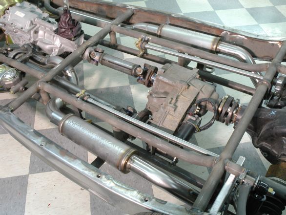

Here is an example of just how wide the transfer case is. This guy has the transfer case in the back instead of attached to the rear of the transmission, but that is a custom setup. The main reason for showing the pictures is to let you see exactly how far apart the driveshafts are so you can see how much cutting would be required to get that type of an AWD setup in a Fiero. That driveshaft on the driver's side would be in the driver's side foot well. You can't even offset the two because the main driveshaft still goes straight back from the engine so you would need to offset the entire engine. I still stand by the FWD type layout from a Vibe or minivan or the 6000 ste awd such as below. Then just replace the motor with whatever you want.

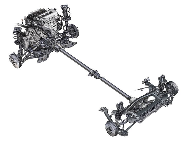

I like the simplicity and potential for the least amount of weight increase, but most of the GM FWD based AWD setups were only designed for winter driving, not high power/dry pavement applications, so I doubt they will hold up to much abuse unlike the RWD stuff that was designed around true off-roading and other forms of abuse.
I would love to take a setup similar to this (preferably the F40 based AWD from the Saab) and flip it around to keep the engine in the back of a Fiero with a 4 cyl or small V6 and use it for my winter commuter (90 miles round trip) vs. my 13 mpg full size truck.
I recall my local Pontiac dealer telling me that the rear end setup in my 1990 6000 STE AWD was basically an S-10 front end flipped around and mounted in the back.
