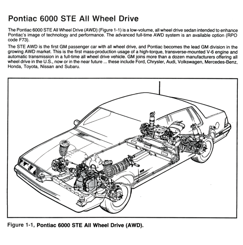

Although they would be tougher to find, there also was the Pontiac 6000 STE AWD. However the GMC trucks had the turbo V6.

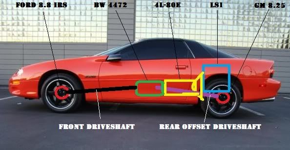

One other, slightly crazy possibility for AWD is to take a transverse engine/trany, and turn it 90* so the two output shafts face fore and aft, then a diff front & rear with a driveshaft to the remote one. The fuel tank is in the way, and it would probably require lengthening the chassis to put the rear axle far enough back to make room for the diff.

All the LS motors are basically same externally, within the same generation and excluding the ls4. The LS9 is basically an ls3 with a blower on top. The cool part about the motor is the blower itself and how low it all sits. Not much taller than the heads.If you want a real beast of a motor build an ls7 and put that blower on top.
I don't think the Syclone or Typhoon setup would work for the same reason as the TBSS. They have a transfer case with a driveshaft going back to the front that would be in the driver's side foot well.
Thunderstruck GT, can you post some pictures of the hood open on that car and also the center tunnel inside the car? That motor is sitting way back to the rear and looks like it would still have some decent balance. I see some sheet metal in the wheel well so I assume you basically cut out the entire front bulkhead and built from scratch? What motor is that also?
Running a motor placement like on Thunderstruck's car would require you to run a driveshaft back to a front differential that would actually be in front of the motor due to the motor being mounted so far back in the chassis. I don't think any AWD system would work in a fiero with that configuration. Although I suppose you could cut into the passenger side foot well and put the driveshaft on that side.
