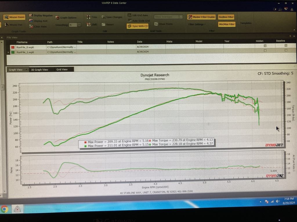

Went to the dyno last night. Did a base run to look at the changes I made after not feeling completely comfortable with the last dyno in June...
We calibrated my rpm by speed by setting 2000rpm on the dyno. Once done, I got a smoother graph that shows RPM instead of speed.
Turns out that me backing off about 1.5 degrees up top and slightly over the course of the rpm range as well as removing some fuel by targeting 13.5 in the low-to-mid range really helped! I had left the 12.5 target up top.
However, with better timing, the misses, or rather detonation became more pronounced up top from 4600 on up. As a result - I didn't gain any peak horsepower.
I did gain torque. I now make 230 ft*lbs at 4100 rpm. That's +20 ft-lbs! Same horse power of 209 due to the fuel/iginition/timing issues up top. That's kinda insane!
We then did a run with my exhaust cut-out open. While I lost 2 ft*lbs at peak. I gained 2 peak rwhp to 211. However I gained 10 hp past peak so it is useful for +5000rpm...if only then.
After that, we set timing to +26 (+base 10). We also removed a little bit of efficiency from the VE table from 4600 and up.
I start my car and immediately code 41 comes on. We replaced the crank sensor and checked the connections and still it wouldn't go away. It had come on earlier in the week when I had the heater core replaced but had gone away. Had to end the day there. I bought a new, this time - expensive - ICM. This one does come with thermal paste so perhaps that's what killed my new ICM early and the current one did not. I had to leave the car at the dyno shop.
I'm going there tonight to swap the ICM. No time for a dyno run. I have to drive it home (if the new ICM cures the issue) and race tomorrow.

Here's the promised dyno of the extra ~21 ft*lbs of torque I picked up just by leaning the mixture closer to 13.5:1 below 4000 rpm.
The red line is with the cutout closed. The green line is with the cutout open. Same tune. Only difference is the open cutout...
You truly don't see some gains from it until past 6000 rpm.
Increases start to come on at about 4800rpm but not worth it yet.
Looking forward to fixing that Code 41 and pulling some timing and fuel out. The pre-detonation is killing my peak power.
[This message has been edited by lou_dias (edited 09-11-2024).]

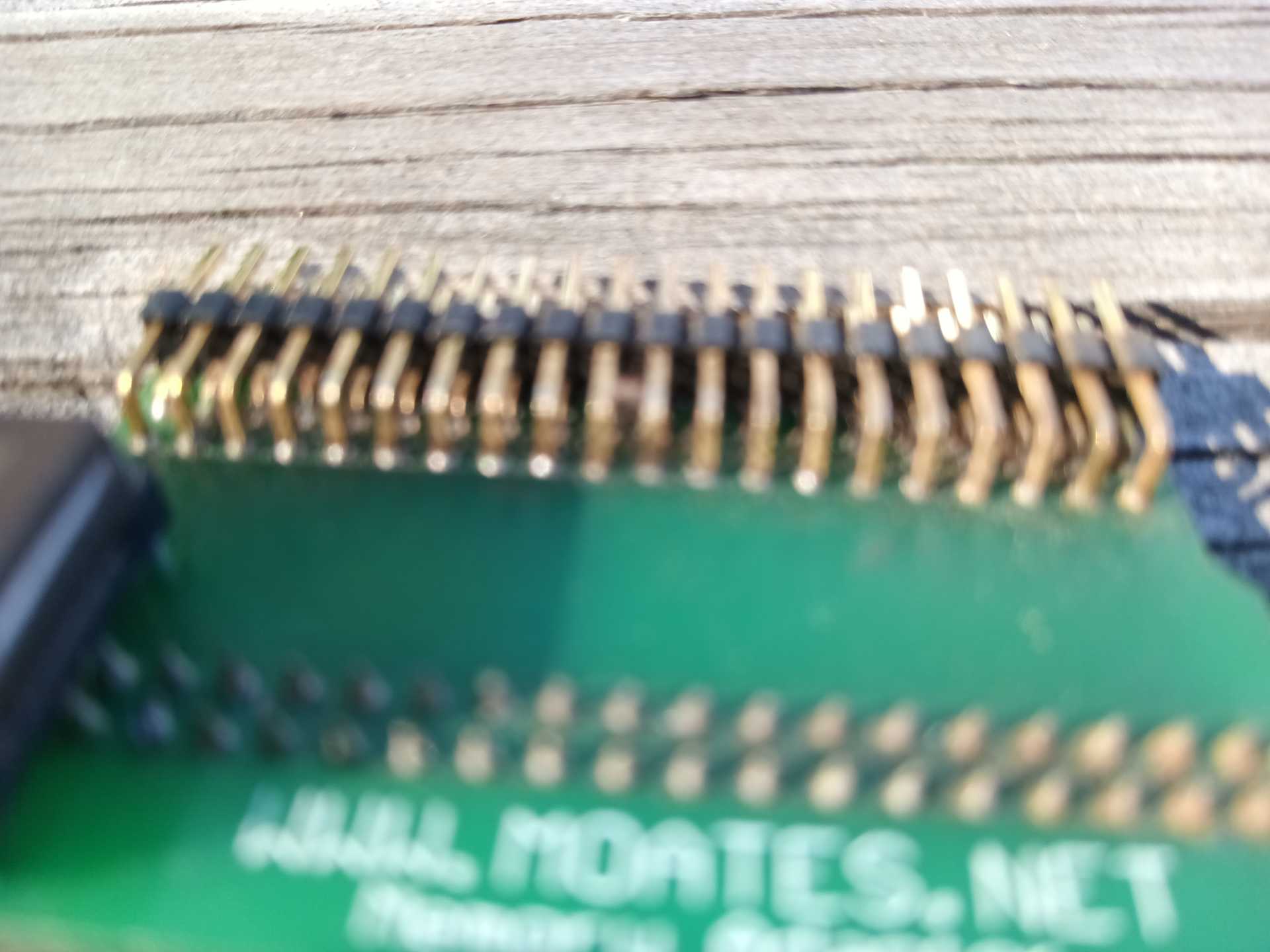

I purchased new connectors to create a new ICM / Crank Sensor cable adapter. Hoping that fixes code 41 as moving the engine ground didn't fix the issue.

Apparently my problem was f@cking dust!
