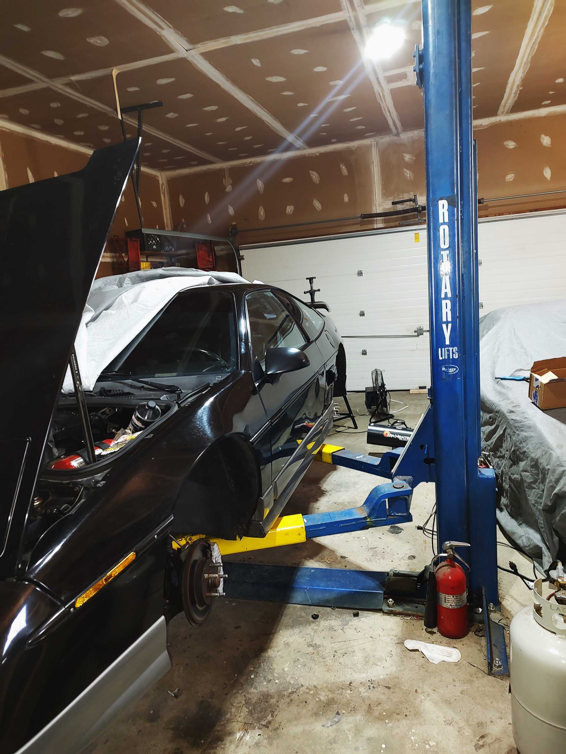

We have a 10 ton hydraulic Rotary Lift in the garage. That brand is 100% USA made, high quality, made of heavy steel and built to last. This is the brand that the pro's use. Expensive but
when its locks and you work under it, you feel very safe. Its mounted on a 6" reinforced concrete floor and we added outrigg stabilizers.
Here the car sits low for changing the tires but we can rise the lift to get space 7' or 8' under if needed.
