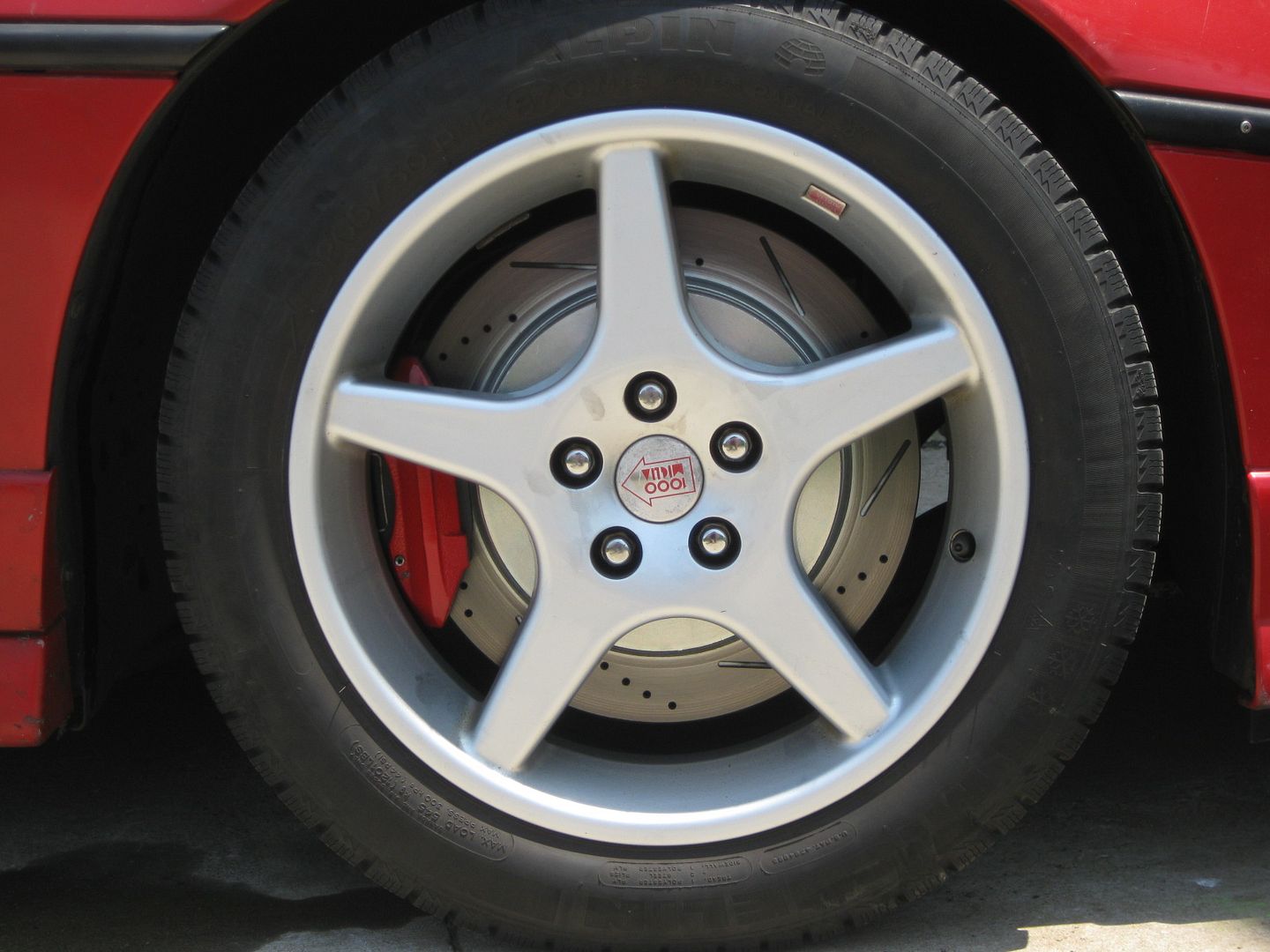

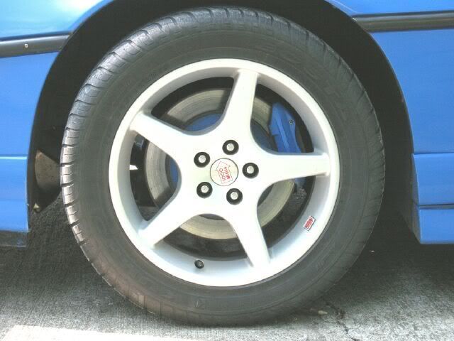

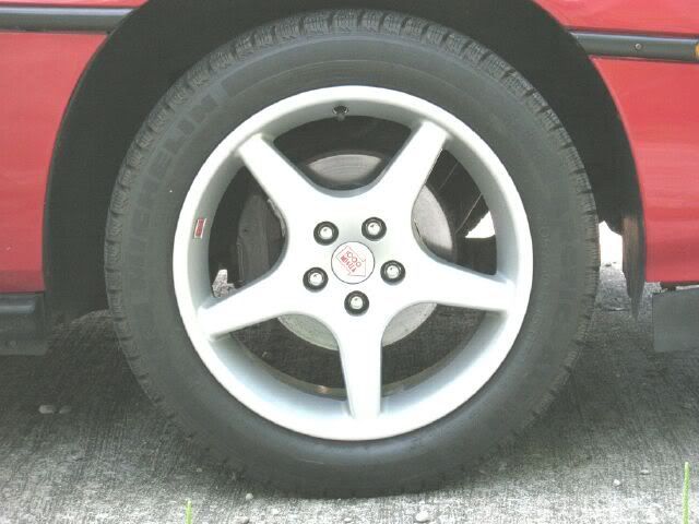

Great pictures Alex! These are my favorites and really show off the visual impact of this kit vs. the 12" C4.
Originally posted by Alex4mula:
Rotor comparison;
With wheel before & after look;
[This message has been edited by fieroguru (edited 02-22-2012).]

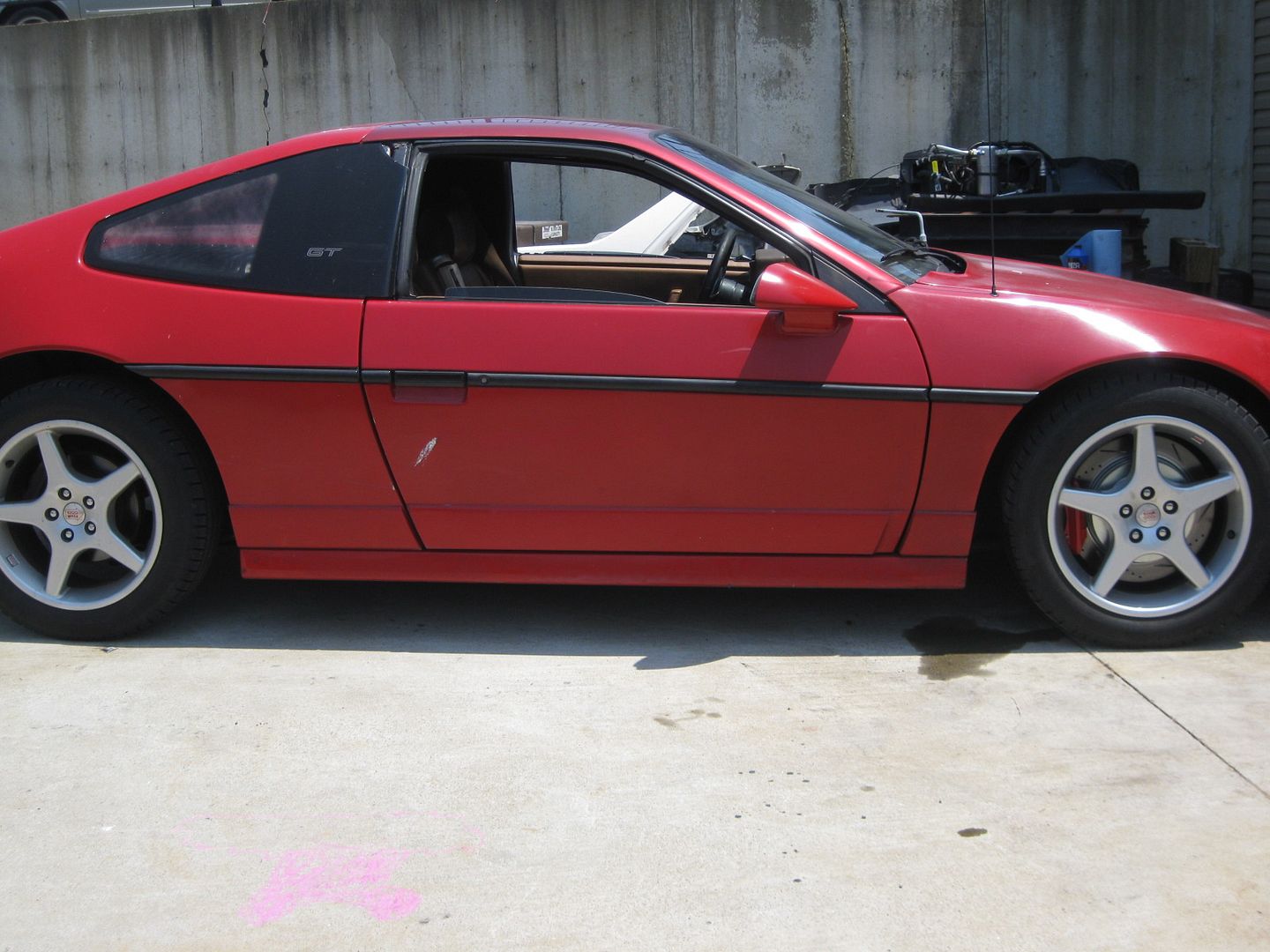

So today I put about 50mi on these new rotors. I really like them. Now the car has some whoa! Not pushing super hard as they are still somewhat braking in. It is a huge difference at least from this specific car perspective. They just need a slight touch and they slow like now. Don't even have to push hard. They respond very quickly and I think most of the time you won't need to use full power. At the end of the run I went a little harder and could lock the front maybe too easy. I'll need to modulate these with manual ABS on panic mode. Will test more on that once I get them fully brake in. You won't like this Paul but I think a front only upgrade is what most people will need. Maybe at the track the rear ones may help some more but most of the braking is at the front anyway. I probably won't even bother with the big brake booster. Will see later but up to now I think I have plenty. Just in case I am using the EBC green stuff pads at the front. Not sure how much they add to the good performance. I'm happy. Get this kit and you will be too

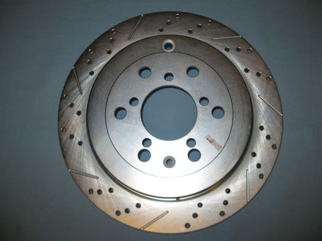

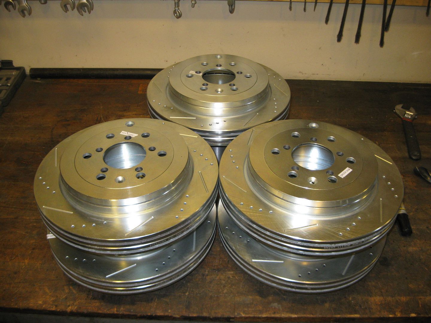

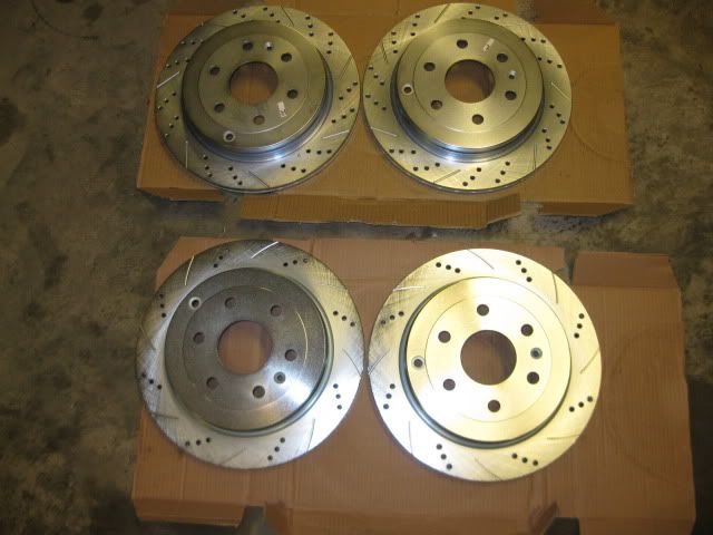

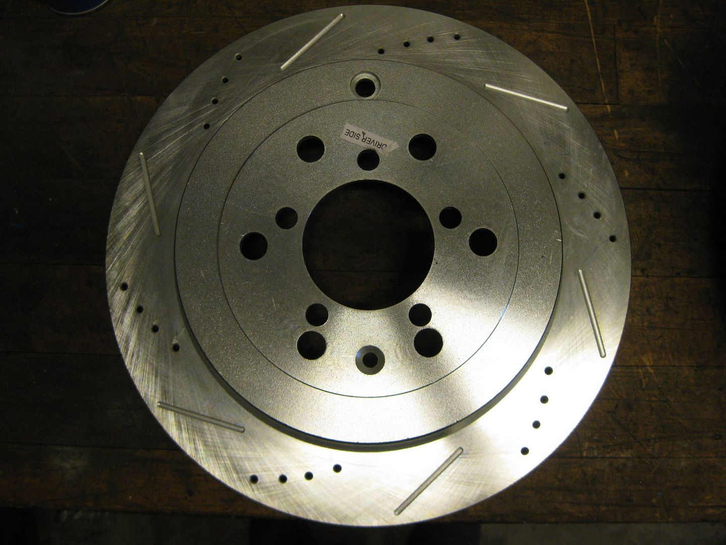

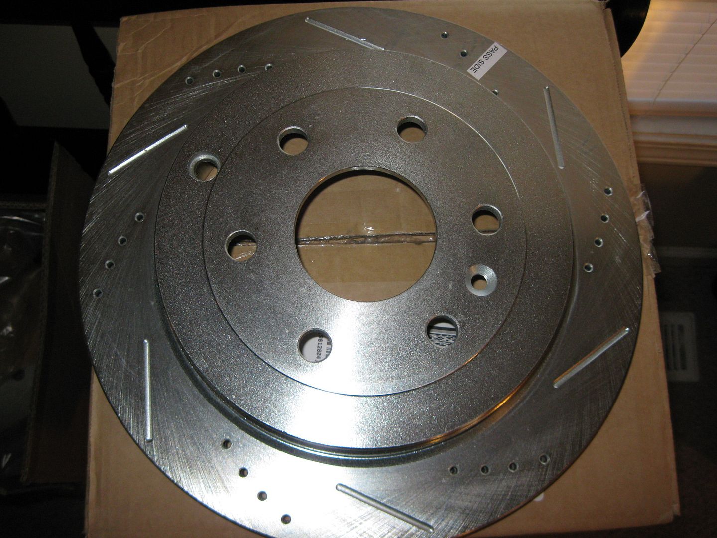

UPDATE: I am working through an issue with the vendor for the Style 3 Blingy Rotors... just ordered a new batch (Same vendor, same part #) and it looks like they have changed the drill/slotting pattern since my last purchase.
Old Style 3:
New Style 3:
This new style just does not have the same visual impact, so I am checking to see if they will get some of the older style 3 rotors even if I have to buy them in larger quantities. Also checking with a few other vendors to see what their drill/slotted pattern looks like. Anyone who had recently PM'd with interest in a brake kit already has a PM from me explaining the issue.
The Old Style 2 (bottom of pic) has more visual impact than this new design...
More to come...
[This message has been edited by fieroguru (edited 03-06-2012).]
Finally got these installed. Did only the front to test that first. If good enough then I would do the other half on my other car. Install was pretty straight forward. I used a Dremel to clean faster the area where the centering ring goes. The rings fit tight. The brackets also fit tight and good. Had to push the sliders all the way back to fit the caliper over them with the new pads. Tis was the hardest part but ok. They look great. Won't be able to test yet as I need to fix one of my mufflers. Hopefully by the weekend I should be done.
Rotor comparison;
Sweet. What is your wheel diameter and please give us the details on braking once you're back on the road.

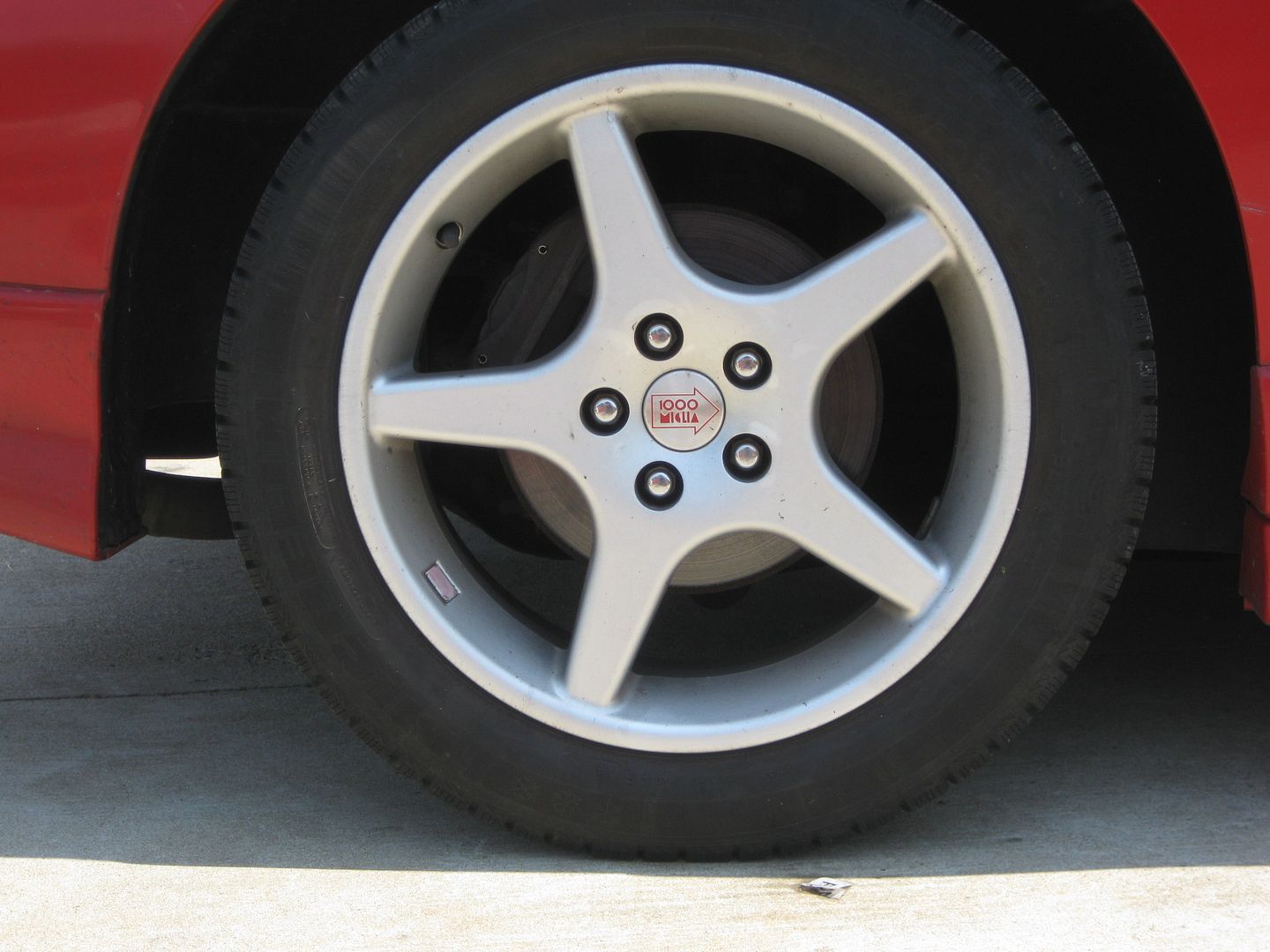

I finally installed the rear ones two weeks ago. Need to post more pics.

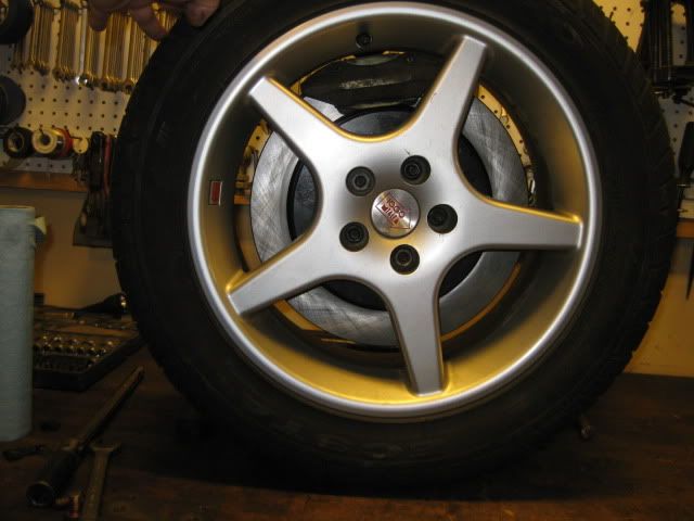

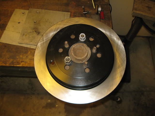

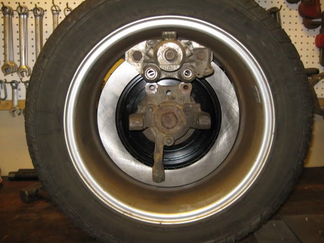

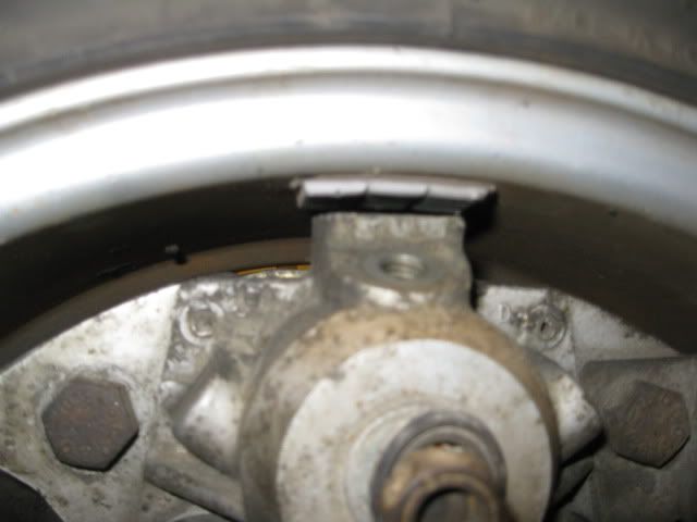

My daily driver 88 was in need of new brakes but it has 16x7 38ET wheels. I just couldn't bring myself to run the C4 12" rotor setup again, so with 1 mod each to the caliper., bridge and brake hose end, I was able to install my 13" brake kit behind my 16" wheels.
I have the fronts done in these pictures and took it out for a test drive, bedded in the brakes (multiple stops from 70 to 15 mph), and then again checked everything for any rubbing... now I get to do the rear.
Stock rear for comparison:
Even though I got this them to fit on my 16" wheels, I am still marketing this kit for 17" and larger.
[This message has been edited by fieroguru (edited 05-26-2012).]

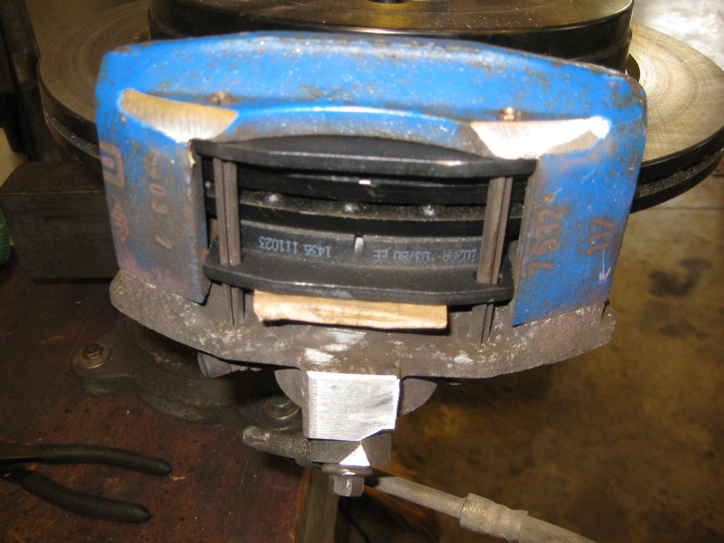

Wow, not much clearance there. Do you by chance have pictures of what the required modifications are to the calipers to fit those brakes?
fieroguru
Posts: 12646
From: Champaign, IL
Feedback score:    (45)
Total ratings: 258
Report this Post05-26-2012 02:51 PM Click Here to See the Profile for fieroguruSend a Private Message to fieroguruEdit/Delete MessageReply w/QuoteDirect Link to This Post
The shiney parts had material removed from them.
The nose of the bridge had about 1/16" removed, the square block on the caliper 1/8" and the corner of the hose end had it's corner ground down as well. These amounts were what was needed for my wheels, but others will probably need different mods. This caliper was for the initial mockup, then I grabbed a set off the shelf and did all the mods and painted the bridges. The car is getting Russel Stainless Braided hoses, so those were modified when installed.
While I have the front apart, I removed both front wheel bearings and repacked them with fresh grease. The car still needs a lower ball joint and the rack bushing, but those will wait for another day... have several customer projects to get done by Tuesday.

Finally got some pictures. The brown thing is not coffee spill Car just got parked after being driven in Beryl tropical storm. After doing the rear the front does not lock up as easily but I have one side (not sure front or rear) that still locks faster than the rest. Need to do some 60-0 testing but these feel so much better and makes feel my GT so inadequate now.

One of the major downsides of the larger rotors is their higher weight:
Stock 88 rotor: 11.2 lbs
12" vette rotor: 14.6 lbs
13" fieroguru rotor: 18.x lbs
At around 18 lbs, the 13" rotor upgrade would add about 30 lbs in weight overall, but the benefit will be about 31% increase in braking torque vs. the stock 88 rotors.
Along with the additional braking performance, the larger rotors better fill out the wheels. Here are some pics with 16x7 Mille Miglia wheels:
Stock 88 Rotor:
12" Vette Rotors:
13" fieroguru Rotor (in a 16" wheel):

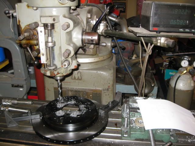

Here the rotor was drilled for the 5x100 pattern (I will have concentric rings, but for mock up the wheel studs are precise enough):
Rotor on the wheel bearing:
Back side showing the caliper clearance as well as the general shape/size of the needed bracket:
The next step is to slide the 13" rotor in place on my stock 88 and confirm clearance to the lower a-arm, then finish the design of the brackets to optimize the available clearance between the rotor/caliper and caliper/wheel. If I can get it all worked out to my standards, then I will entertain selling a 13" rotor upgrade kit for the 88's (and only the 88's).
