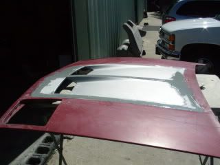

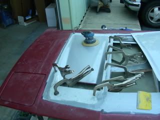

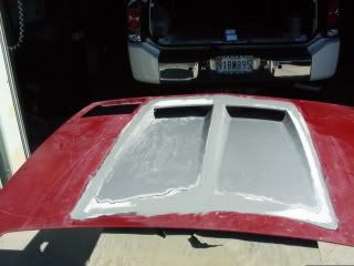

Pics of the "glueing". Didn't go quite as I had planned. I would not recommend using the FUSOR T21. Very hard to work with. very thick, and hard to get out of the gun. Then because it was so thick, I had to use vise grips to get the scoops to fit flush. Well, I got a ton of sanding ahead of me.....
[This message has been edited by SOULCRUSHER (edited 09-18-2007).]

Report this Post09-18-2007 10:45 PM Click Here to See the Profile for F-I-E-R-OSend a Private Message to F-I-E-R-OEdit/Delete MessageReply w/QuoteDirect Link to This Post
Remember this comment?
F-I-E-R-O, your in luck, I decided to go in a different direction with the hood, so its yours......................
NOT!!!!
Let that be a lesson to all y'all... when you tease F-I-E-R-O, bad things happen.
Seriously, sorry to hear about the way this product has worked out for you so far. I've been thinking about this and was glad when I first saw your post that I had learned about what was thought to be the premium product to use on these projects. Thanks for sharing your experience. I'll be watching to see how this turns out, maybe it won't be as bad as you think.
If I can remember some of the hexes I used last night to help the Redskins win over the Eagles, maybe I can come up with something that might help you out on my end. Though one of the hexes did involve having my daughter (an Eagles fan by birth) pull on my finger to simulate a leg injury hex to one of the Eagle players (she didn't realize that she was actually participating in this until after she did it), maybe I can figure something out that might help you----------- but not until you say something nice.

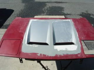

just finished the mud work yesterday, now its ready for primer. Hopefully will get it done soon.

Can you prime over the glue stuff when it's dry and paint? Or is that simply to bond the back of two panels together.
I have a crack in my rocker panel I was thinking of cutting 1/8" along the crack and filling that with the glue stuff you guys use then painting over.
Nice scoops I wish I could do that sort of work.

God i really love them,i have to say thats the best front scoop that looks gr8 and i SSSOOOOOOOOOOOO want them.
