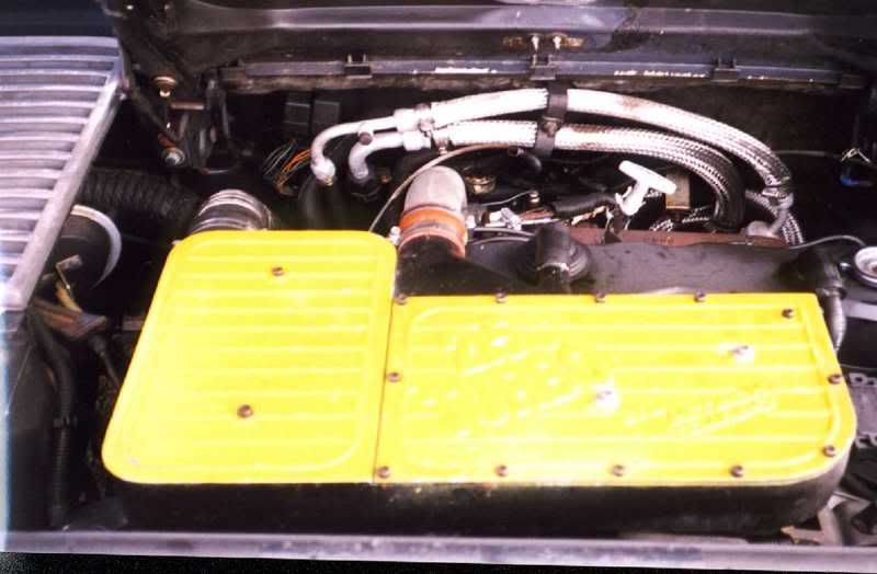

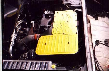

Are the first two pictures... the yellow setup... the IRM turbo kit?
RWDPLZ
Posts: 15085
Registered: May 2002
Total ratings: 306
Report this Post12-18-2011 05:09 PM Click Here to See the Profile for RWDPLZSend a Private Message to RWDPLZDirect Link to This Post
Looks like it. I also missed one, FieroScott has the IRM fastback with the IRM turbo kit. Apparently IRM and Pontiac couldn't get it to run right, and the project was cancelled.

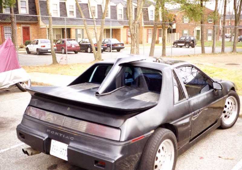

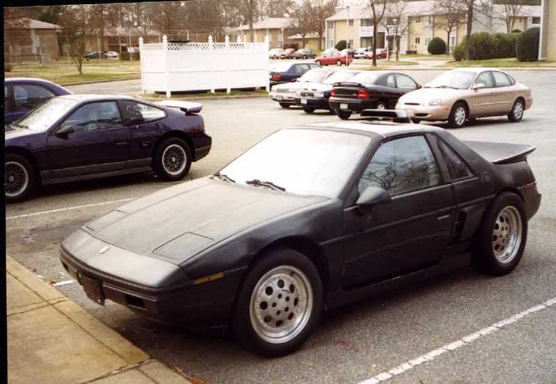

I had the 84 t-top turbo car. I bought it in the last 90's from a guy for $500. It was a cracking great car. IRM had a few bits, and if I am not mistaken, had enough parts to supply another kit. But remember this was over 10yrs ago. I sold the car to a guy in Williamsburg Va. Jim(?) was in the local Fiero club called FOCOSEVA. I am sure those guys know of him and the car. Maybe he still has it but if he does I'd buy it right now, sight unseen. It was 1 of 8 according to Ed Parks (who had it on display for a few yrs at his shop).
It was a very simple setup. I didnt know alot about turbos back then but man, I'd love to have another go at it! Power was rated exactly even with a stock Fiero GT. Honestly, dukes are terrible motors but thats not the point. Its different, cool and well AWESOME! The kit I built and sold to OSLO all those years ago needed PROPER engine management. Something that was not all that easy back then. Megasquirt or pretty much any other EM could do the job and make it liveable these days.
I wish I could offer more info and pics but alot of those pics have been lost long ago. Hopefully someone from FOCOSEVA can help track Jim down. But if they do, I got DIBS!

Here are some pic's of the IRM Turbo from the 84 IRM Turbo Fastback.

Cool! I've always wondered though, what's under those covers? I'm guessing the two-screw cover has the air filter?
FieroScott
Posts: 76
From: Menasha, WI
Registered: Jul 2007
Report this Post12-21-2011 07:41 PM Click Here to See the Profile for FieroScottSend a Private Message to FieroScottDirect Link to This Post
The Plenum contains two chambers. The cold air comes in the left side rear inlet, flows through the filter and comes out the bottom which feeds into the turbo. The turbo then pushes the pressurized air through the aluminum pipe back into the right chamber and into the throttle.
