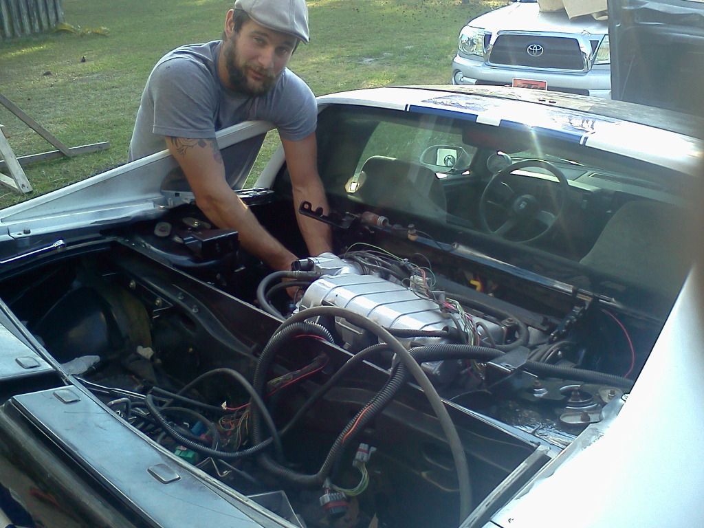

Report this Post04-18-2012 11:55 AM Click Here to See the Profile for BV MotorSportsSend a Private Message to BV MotorSportsDirect Link to This Post

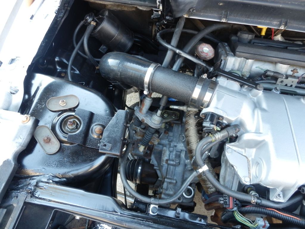

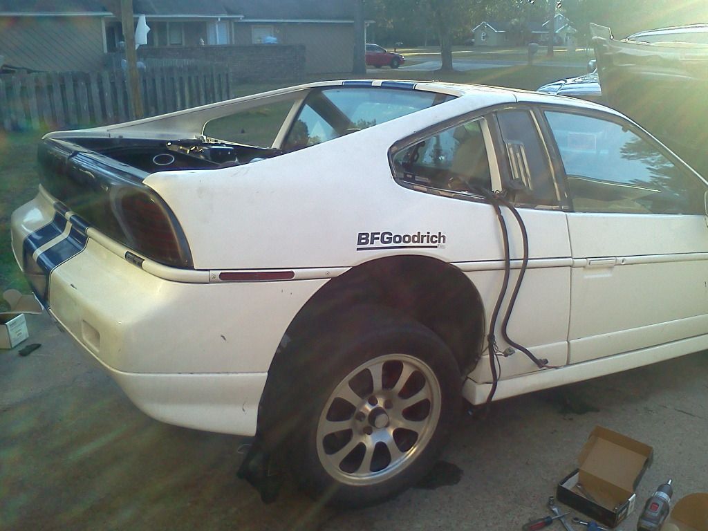

Look whats out of the garage for the first time since Thanksgiving!
Yeah, it looks worse than went it went in. However, I replaced the decklid, fenders, bumper, inner fenders, headlights, headlight motors, and the entire front suspension has been rebuilt, including the brakes (Sunbird GT). I also cleaned and painted all the sheet metal under the front clip.
Next section will be the engine compartment.

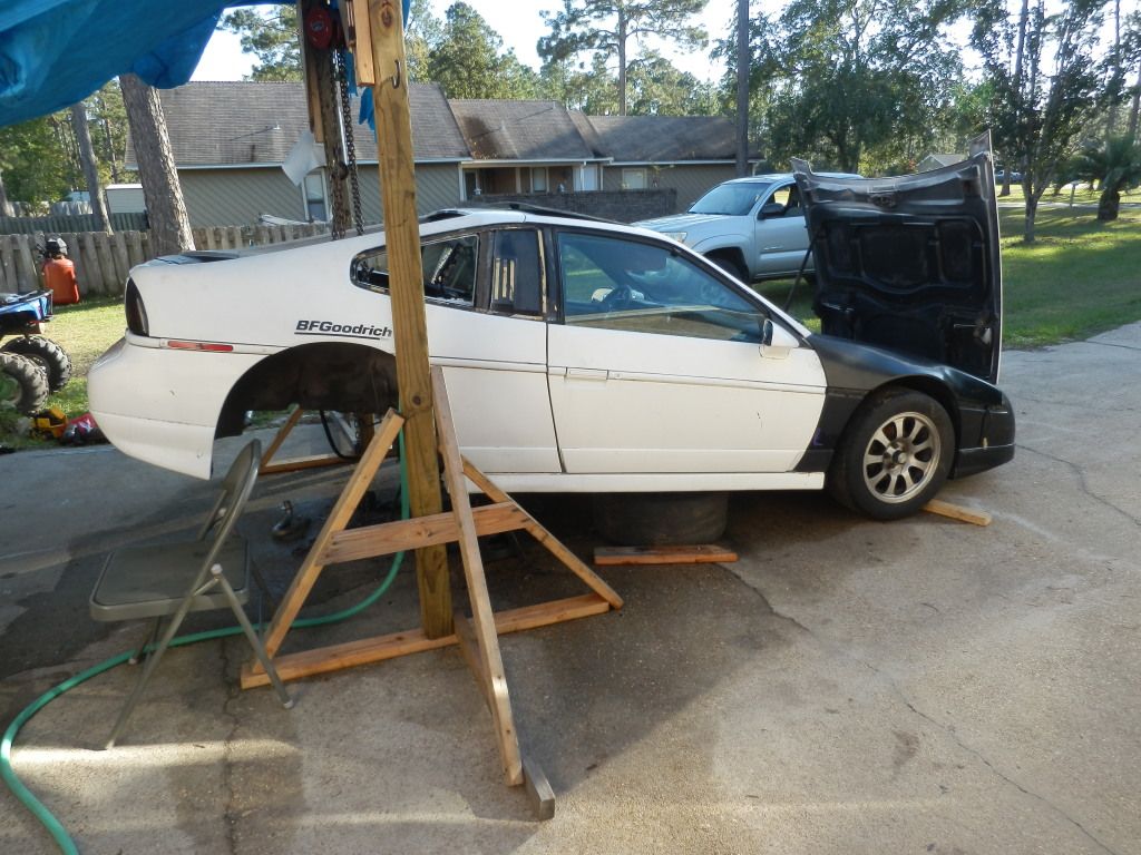

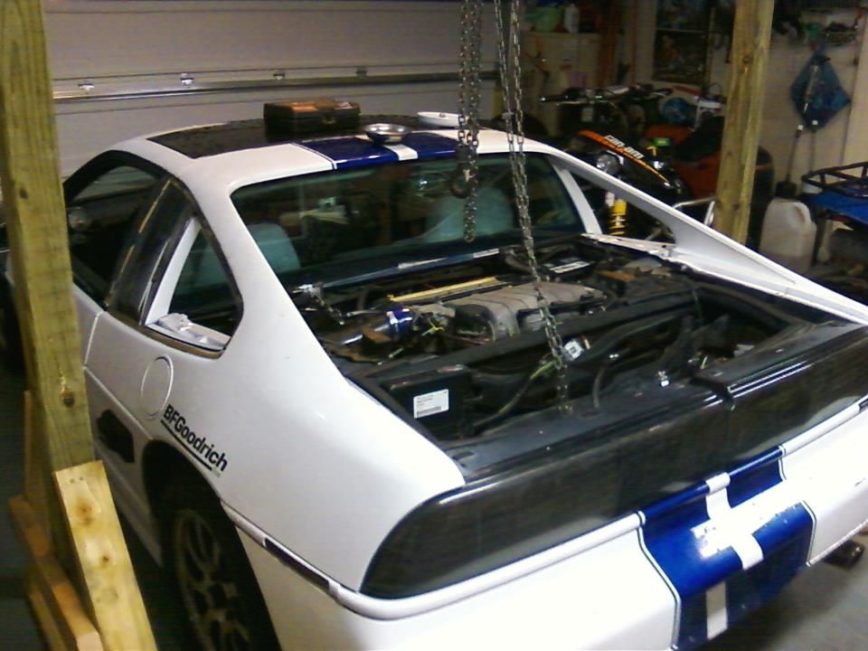

So... I guess I should post an update on Garths car. I received a box full of parts on Friday. Even though its my car and now in Florida, I believe Garth wants it back. I think all the talk about my 88 got him excited about the car again. When we went to the LeMons race with Jesse and his badass LQ1 swapped 87 race car, I KNEW Garth would be on the hook again! I cant say that I was surprised when a box from MegaSquirt arrived. Garth ordered the harness, WBO2, ING-6, and MS3 w/ the daughter board. LOL he spent about $1200 on a car he doesn't own! Unfortunately, MS sent a MS1 EMS so I have to RMA that tomorrow. No biggie, I have a lot to do anyway. I am going to pull the cradle tomorrow. I have to set my gantry back up first though.
Plan:
Drop cradle & inspect the drivetrain
Clean & paint everything
Send the KONI's off to be rebuilt
Redo the exhaust (its too loud and split at the Y-pipe)
Source another front manifold to eliminate the shared collector.
Tune up & change the WP while its out.
DOHC top swap (I have all the parts, but need all the intake manifold bolts (the long ones, apparently they are different)
Move the coil pack from the stock location to where the battery is located
Move the battery up front and replace it with my own mini-battery kit
Lay out the harness and prepare the original ECU location for the MS3.
Remove the N20 bits as the car will be forced induction.
Here goes! If there is any interest, I'll try to keep this updated as I go. Anything goes wrong its on me, I don't have to worry about a shop pulling some hocus pocus BS on this one.

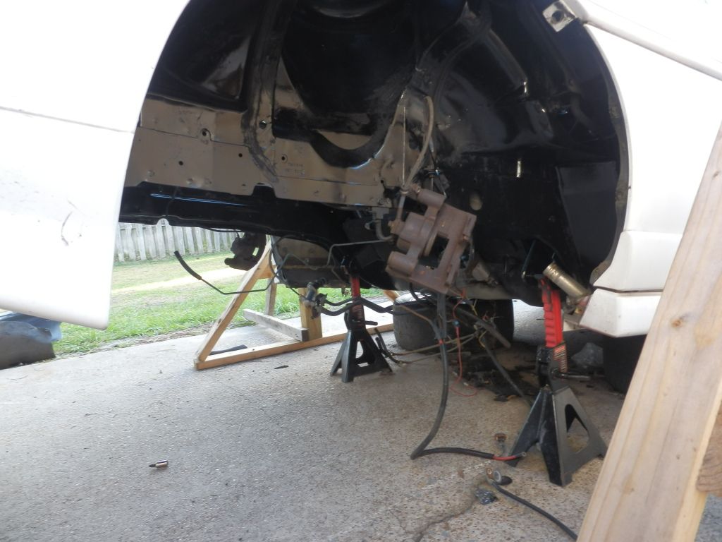

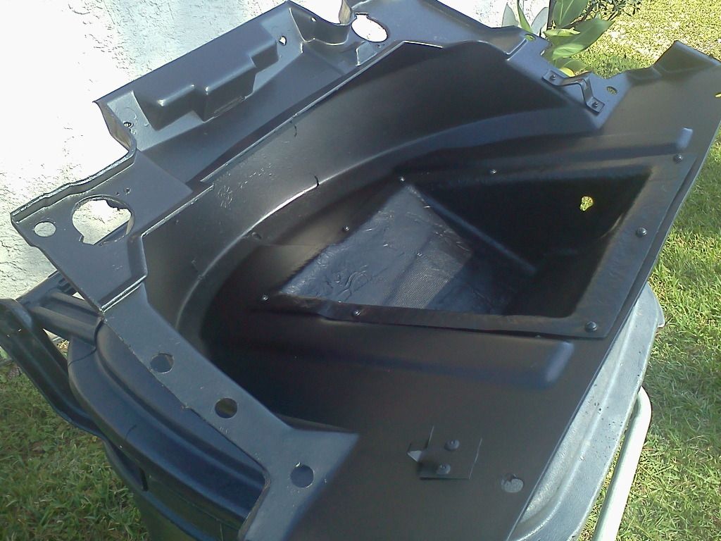

I removed the OE dog bone mount and started cleaning up the engine bay. Car is in really good shape and practically ZERO rust.
1st coat of paint

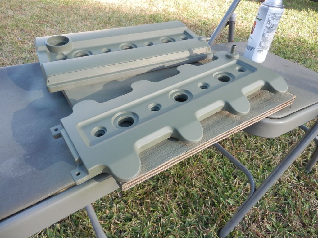

I put in some hrs today! Nothing worth posting pics. Just a lot of cleaning and painting. Ok, now I am off to strip and paint the cradle....

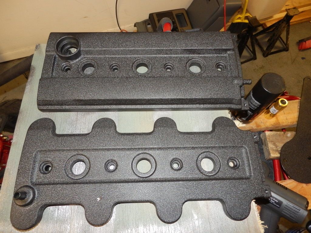

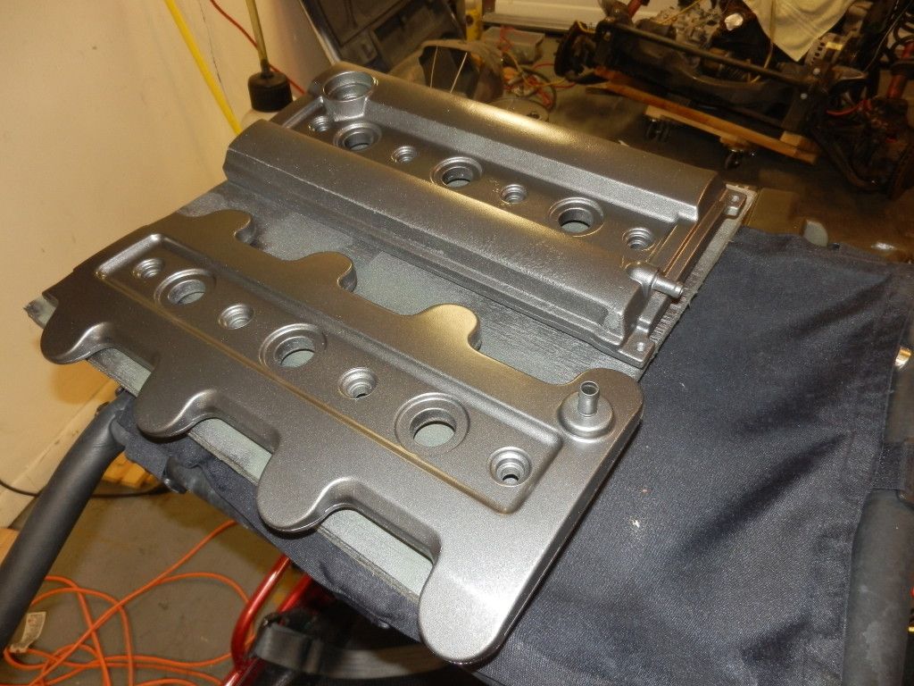

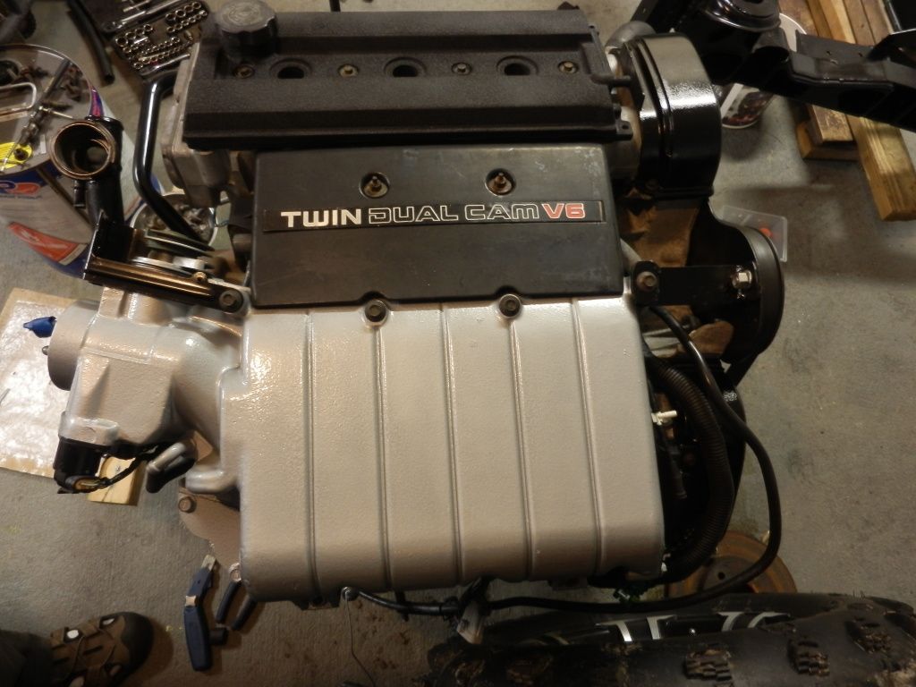

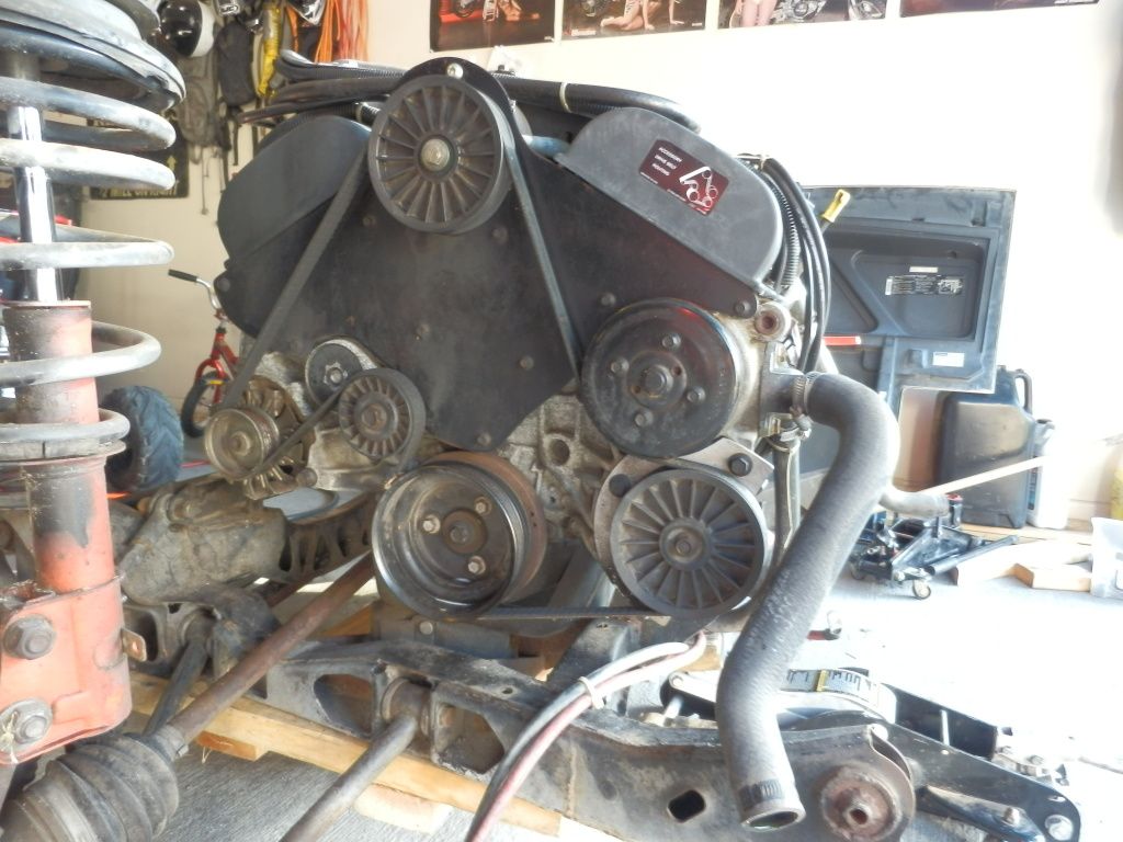

Here are some pics.. kinda boring.
Cam covers (still drying so they look a little blotchy):
Timing belt/PWR Steering elim plate:
Engine in progress:
You'd never know this was a custom built, re-geared Quafie LSD equipped Isuzu trans:

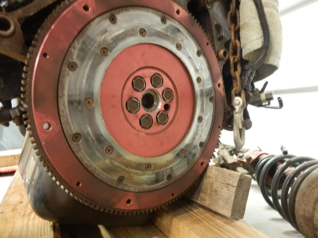

This is gonna suck.. even my smallest thin wall 17mm socket wont fit. I hope I can catch the Snap On truck tomorrow!

Flywheel botls are kicking my BUTT!
fieroguru
Posts: 12589
From: Champaign, IL
Feedback score:    (45)
Total ratings: 258
Report this Post10-25-2012 12:59 PM Click Here to See the Profile for fieroguruSend a Private Message to fieroguruDirect Link to This Post
Get get a cheap socket and grind the nose down to make it thinner at the end.
BV MotorSports
Posts: 4821
From: Oak Hill, WV
Total ratings: 189
Report this Post10-25-2012 01:48 PM Click Here to See the Profile for BV MotorSportsSend a Private Message to BV MotorSportsDirect Link to This Post
I have one that I modded years ago. I dug it out of my spare sockets. Even that one is too thick! I guess I can hit it with the grinding wheel again or put a ball grinder on my dremel and go to town on the flywheel. I really dont want to ruin a $500 flywheel though.
Thanks for the advice.

I hope you put socket heads back in that flywheel upon reassembly
BV MotorSports
Posts: 4821
From: Oak Hill, WV
Total ratings: 189
Report this Post10-25-2012 03:37 PM Click Here to See the Profile for BV MotorSportsSend a Private Message to BV MotorSportsDirect Link to This Post
At this point I am going to pour acid on the flywheel for revenge. LOL

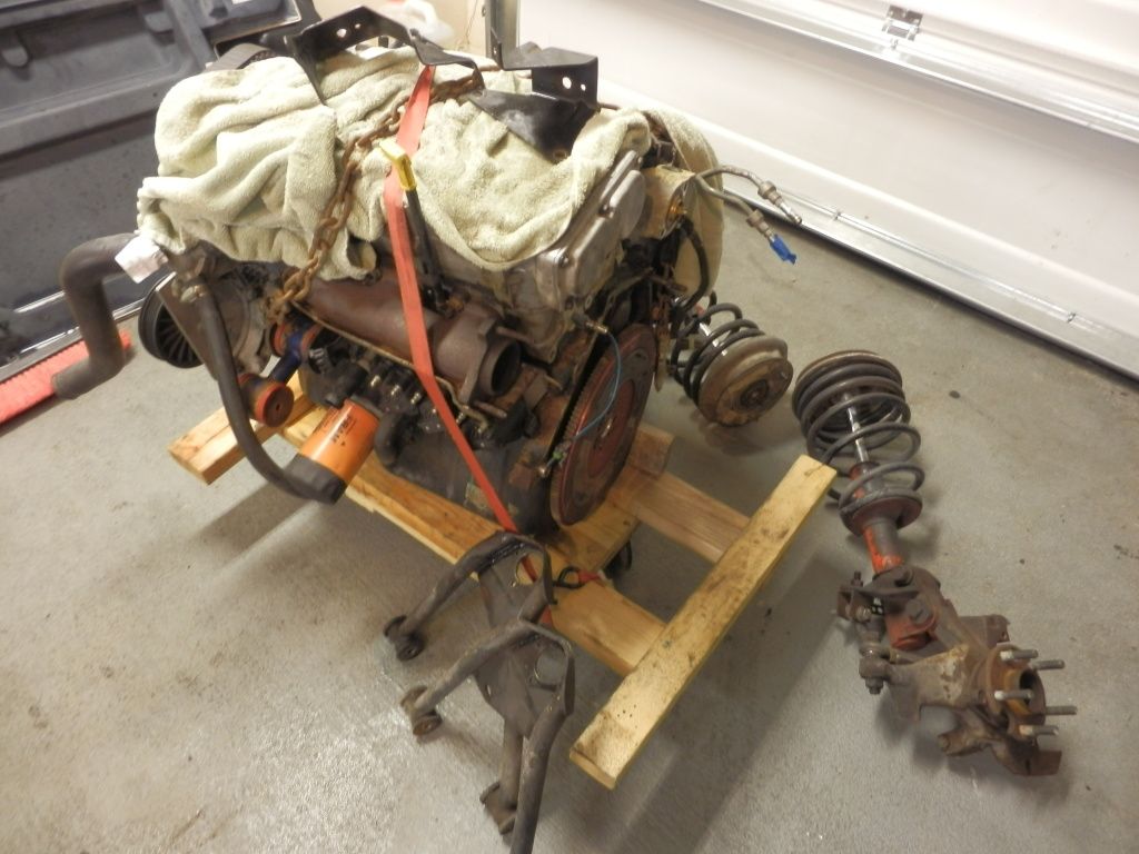

Report this Post10-25-2012 07:17 PM Click Here to See the Profile for BV MotorSportsSend a Private Message to BV MotorSportsDirect Link to This Post

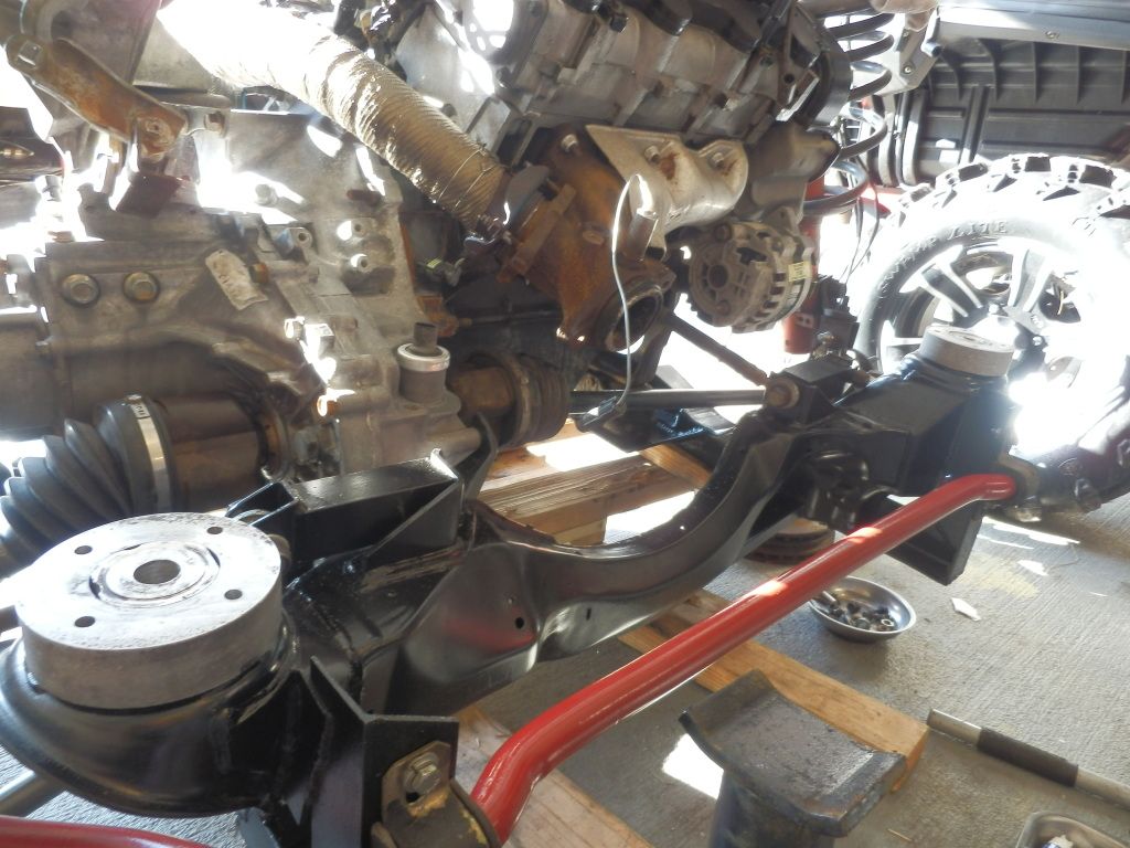

BV MotorSports
4821 posts
Member since May 2001

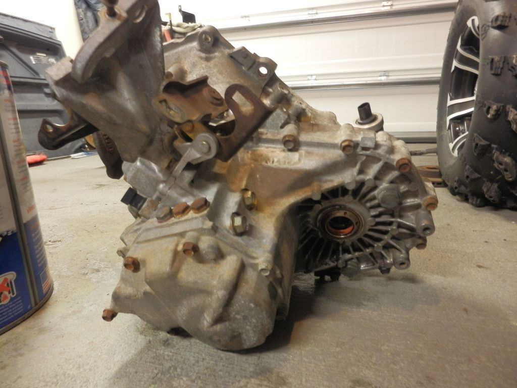

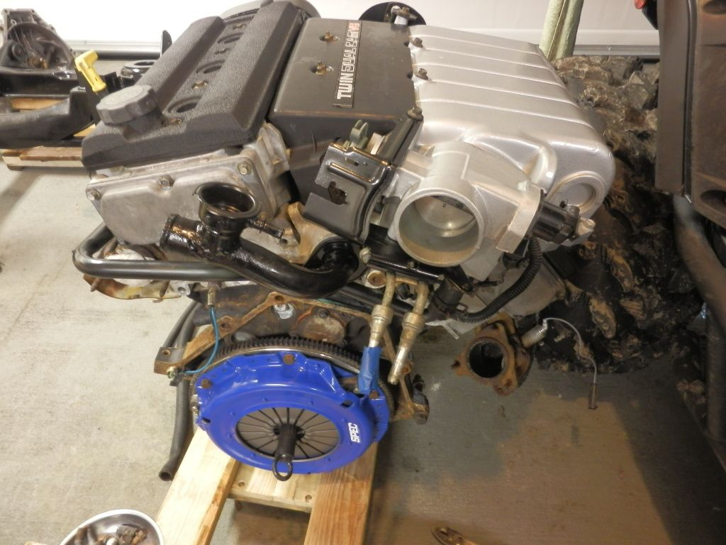

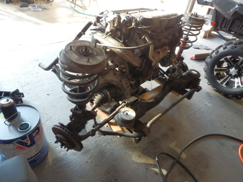

My son, Chase (6) helped with Garths car today. If you see pics with the axles and they are covered in paint runs etc... just be proud, like me, that he helped! He scuffed them up with scotchbrite before he hit them with the paint.

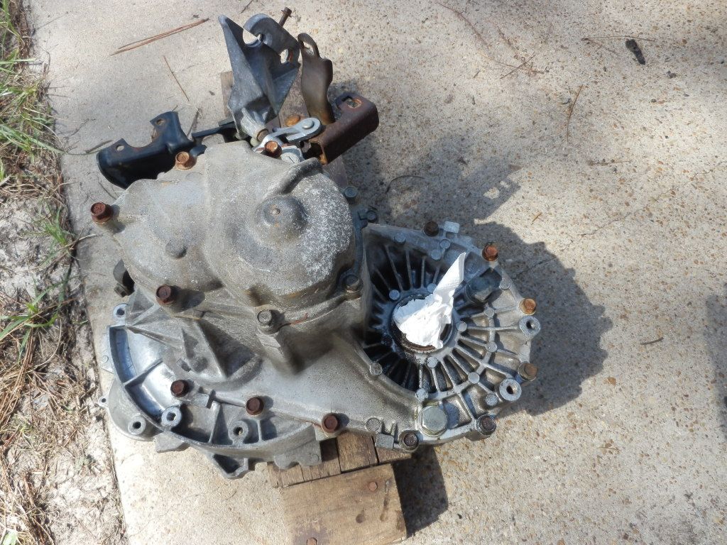

The trans before:
After:
EGR delete:
Intake (you can see the MAP sensor delete on the left)
Cradle:

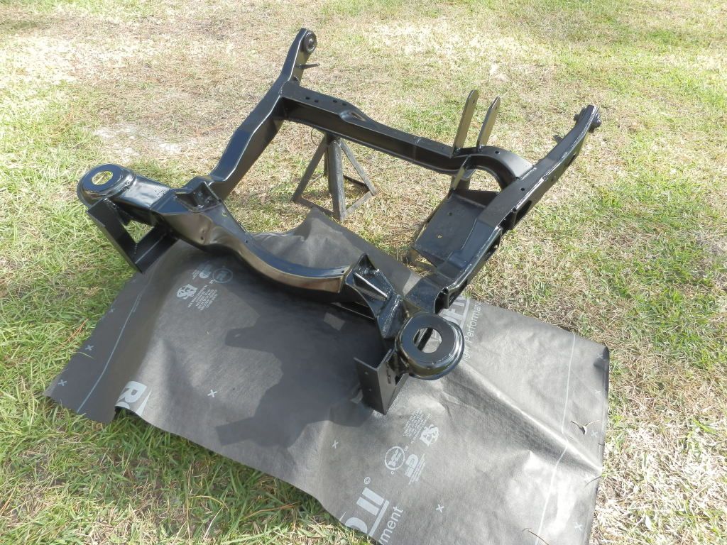

Report this Post10-26-2012 05:44 PM Click Here to See the Profile for BV MotorSportsSend a Private Message to BV MotorSportsDirect Link to This Post
Not much to report. Just doing some wiring for the MS3 and running the vac lines. I also cut the heat shield off the stock crossover pipe and used some DEI Titanium heat wrap. BTW the genuine DEI wrap is 20 times nicer than the ebay "titanium wrap".
Tomorrow i need to mount the battery relocation kit (Norms) and route the wires. I have an AWESOME mod for that. The wires will be almost completely hidden... its gonna be SWEET!

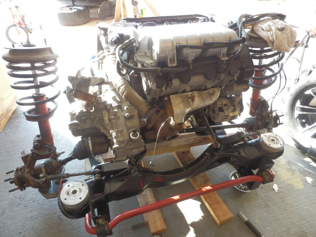

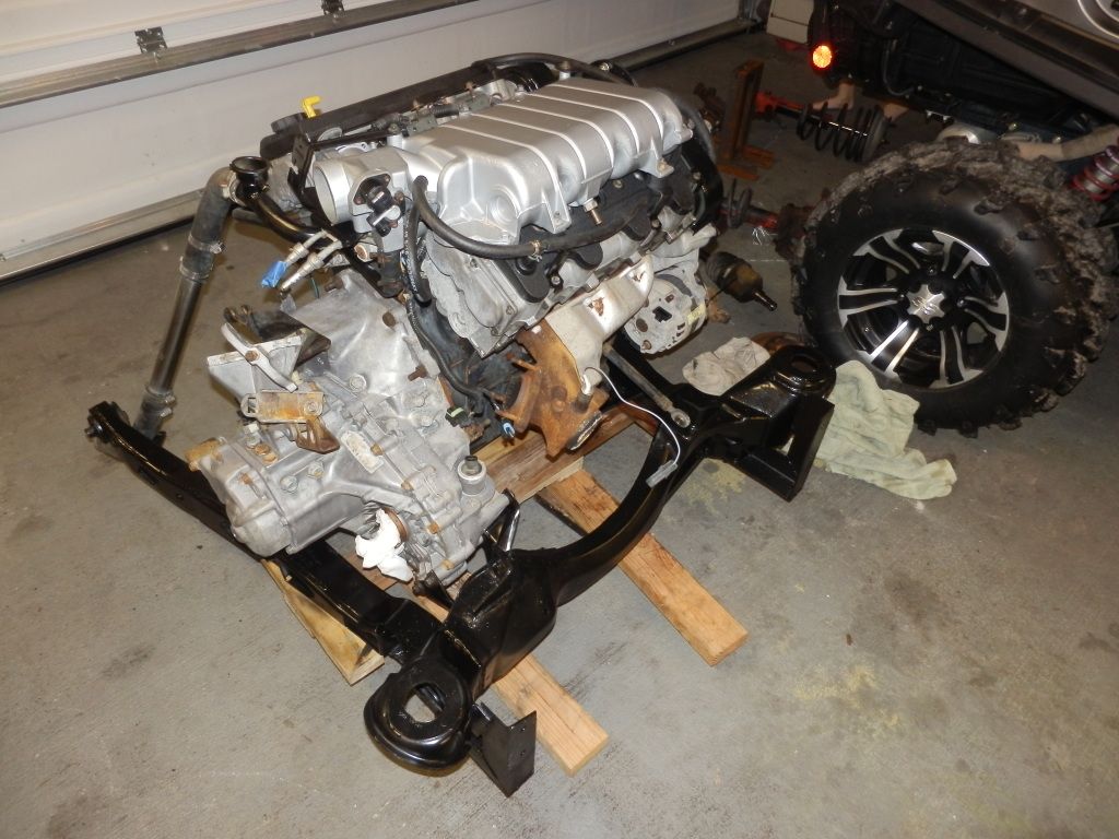

Engine & trans are on the cradle... I'm taking the weekend off. Its so nice, time to hit the track!

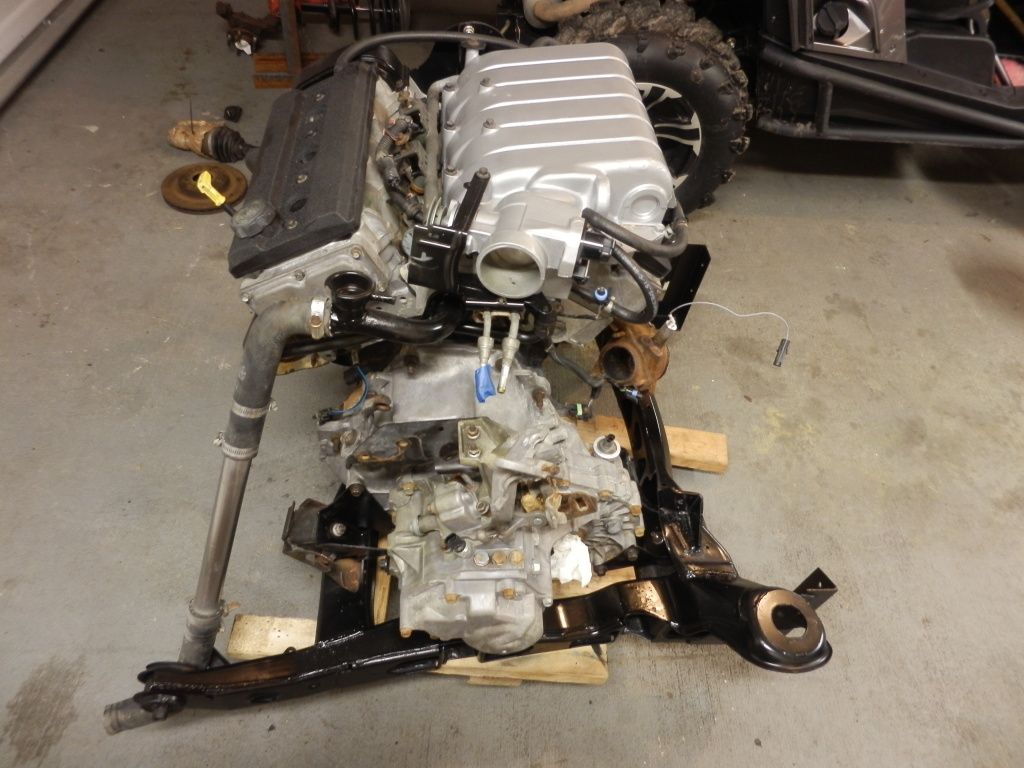

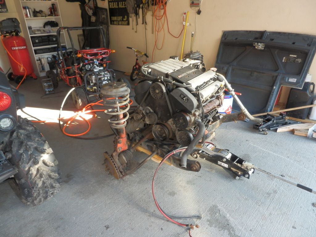

Report this Post10-27-2012 11:51 PM Click Here to See the Profile for BV MotorSportsSend a Private Message to BV MotorSportsDirect Link to This Post
BV MotorSports
4821 posts
I forgot to post the newest pics... here goes:

Suspension is all back on the cradle. All the new brake parts arrived yesterday as well. The drivetrain is ready to go back into the car. I just need to sort out the fuel pump and route the battery relocation this week. Not long now before she is running again!

Report this Post11-02-2012 04:00 PM Click Here to See the Profile for BV MotorSportsSend a Private Message to BV MotorSportsDirect Link to This Post
Not much to report. The suspension is back on and wiring for the MS3 has begun. Oh how I love wiring... sic
Solid cradle mounts
Wiring getting started!
Crossover pipe wrapped
Suspension done
Engine should go back into the car this weekend if I can get some help.

I haven't really touched the car in the last few days. I cut out the spare tire area to mount the battery relocation and ran the positive cable under the car. It is routed rather uniquely and will be nearly invisible. Pretty clever idea to reuse a redundant part if you ask me! Garth is coming to visit for a few days next month. We have decided to postpone any further wiring work. I just need to get the cradle installed before then.

Report this Post11-06-2012 02:03 PM Click Here to See the Profile for BV MotorSportsSend a Private Message to BV MotorSportsDirect Link to This Post
Tyler and I will be installing the drivetrain in about and hour. Its going to be fun wrestling that wide sucker in place. Standby!
BV MotorSports
Posts: 4821
From: Oak Hill, WV
Total ratings: 189
Report this Post11-06-2012 07:19 PM Click Here to See the Profile for BV MotorSportsSend a Private Message to BV MotorSportsDirect Link to This Post
BV MotorSports
4821 posts
That was the easiest drivetrain installation into a Fiero I have ever done. It literally dropped right into place. It took me and Tyler about 90 minutes to get it like this!

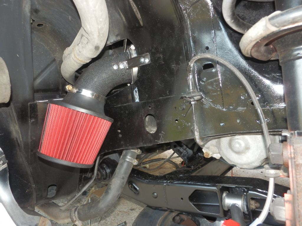

I sorted out a awesome CAI for the car today. Too easy!

Lots of views on this thread. I'll keep updating as I go. Things will slow down until Garth arrives early next month. Garth is going to, somehow, find three days to come visit from Virginia (Yorktown) to assist with the wiring. Something about him "not trusting my color vision"....LOL
Few random pics:
Battery relocation (plastidipped)
Tyler lending a much needed hand (no really, he is much smaller than me so this is one of the rare above car pics!)
Better pic of the wrinkle black cam covers. I think they came out nice!

EVAP canister relocated and plumbed:
CAI I fabbed up:
