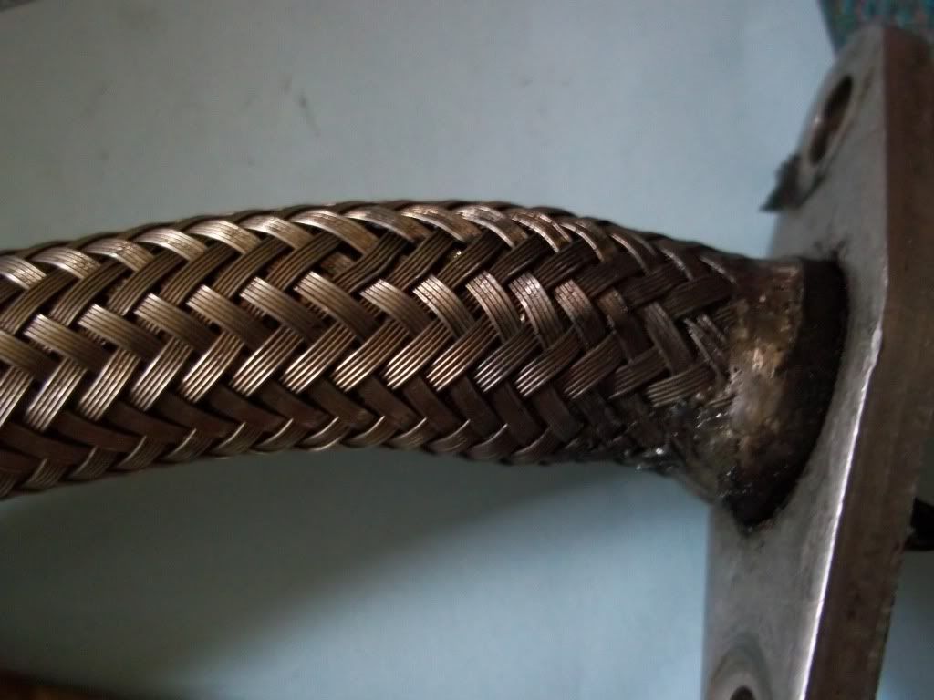

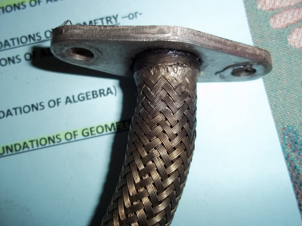

"Cancerous" egr tube, and video of engine running.
NCTyphoonKid
Posts: 1278
From: Trinity, NC USA
Registered: Jun 2008
Report this Post01-25-2011 09:57 AM Click Here to See the Profile for NCTyphoonKidSend a Private Message to NCTyphoonKidDirect Link to This Post
Heres the EGR tube pics the pics don't show it as bad. I've been having issues with the videos I'll have to figure out what's wrong with that

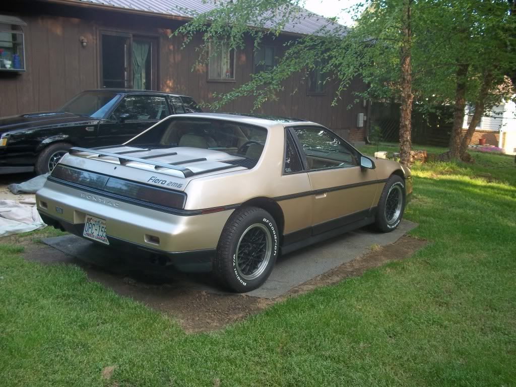

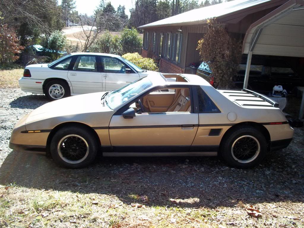

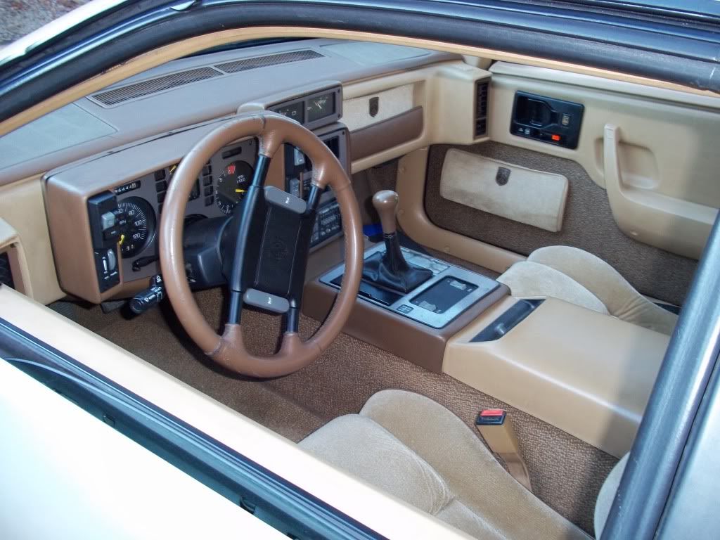

Report this Post04-23-2011 05:59 PM Click Here to See the Profile for NCTyphoonKidSend a Private Message to NCTyphoonKidDirect Link to This Post
Updated pics

That is one fine looking gold notchie!

WOW!!!!!! Beautiful Fiero. You did a hell of a job. Hulki would be proud.
